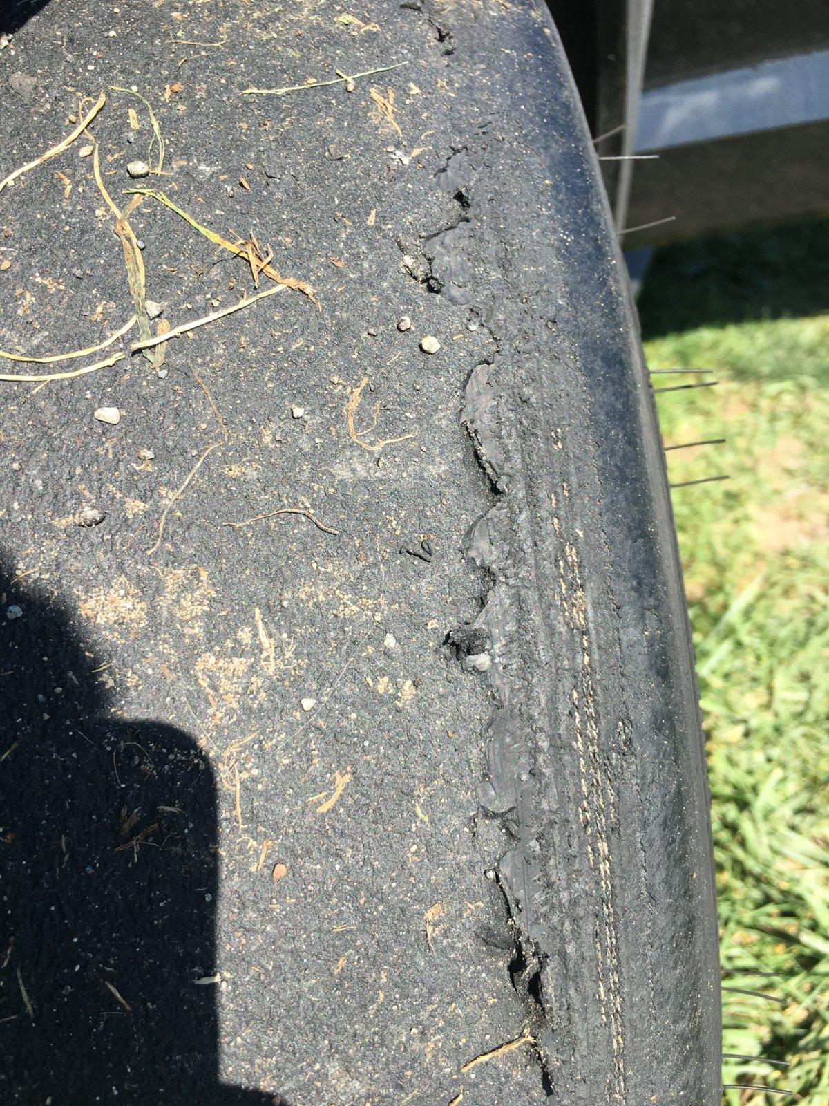

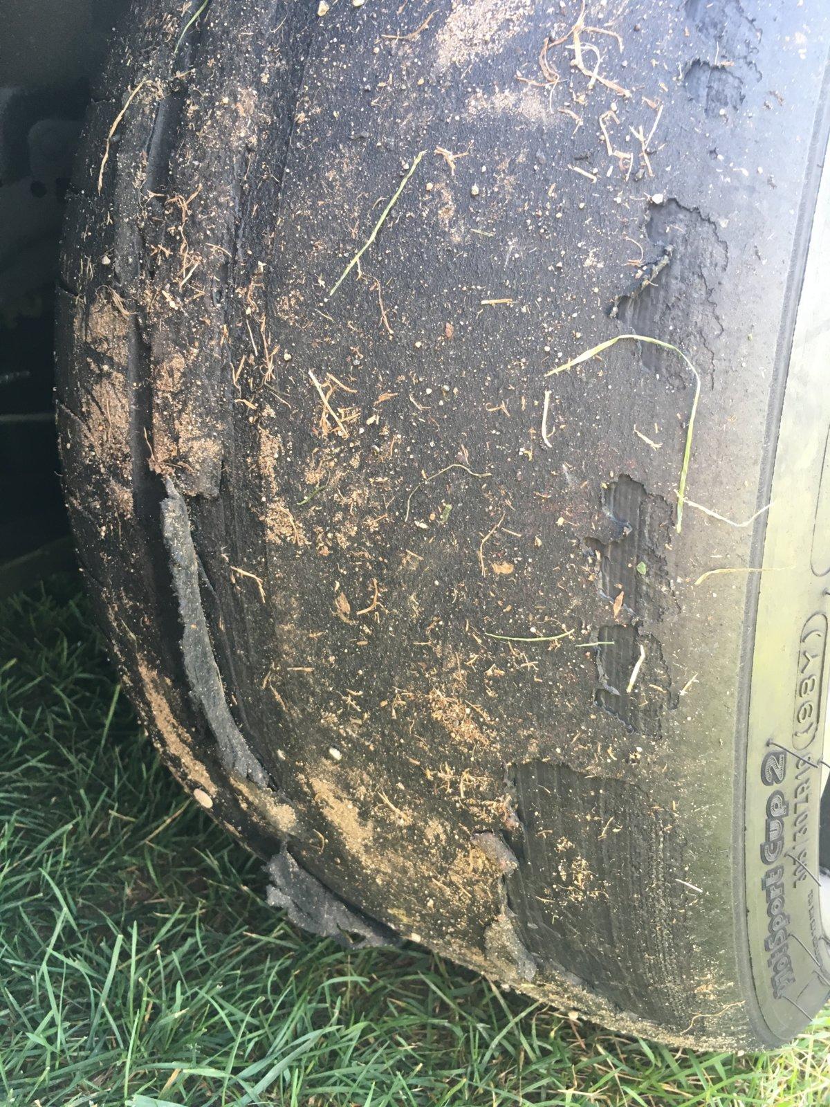

I got 2,000 miles and 4 full track days before chords. I am usually one of the fastest cars in advanced group and push it. I don't have camber plates but swap left and right sides to help even wear.

Ya, there are a lot of factors. My last day with pics above was waterford hills which is an older track with concrete in corners (is getttjf all new asphalt now) which is why mine shredded. This was actually my fifth event, but only did 3 of 5 sessions and had two half days in the rain so really count as four full aggressive 5 session days probably.
I mentioned my driving style bc there is another R in a middle run group which similar days and much better tires but his lap times are way way more conservative. My front brake pads will probably be shot after 6 days for example, his looked brand new. Driving style is a big factor.

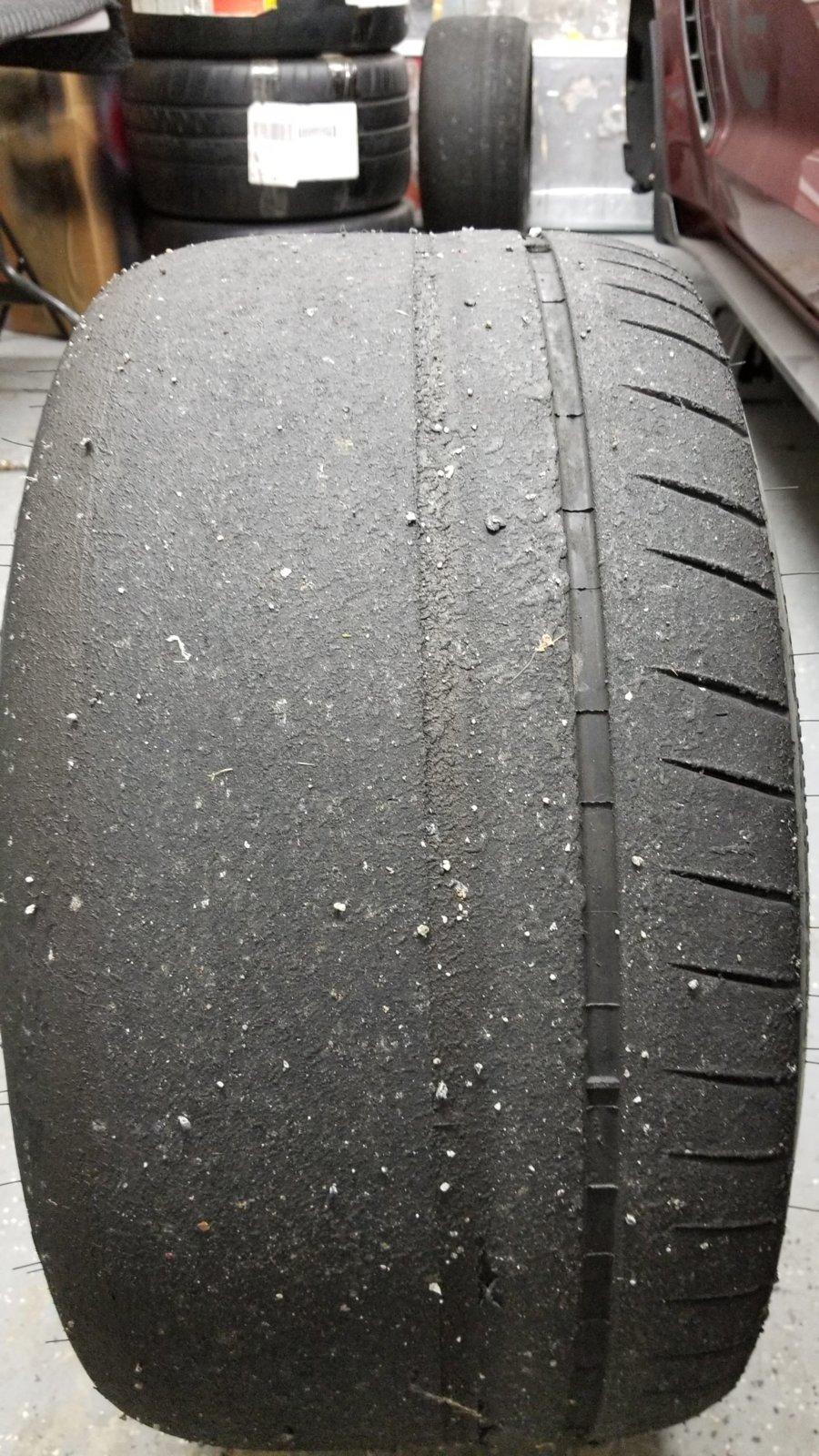

I was more looking for visual indicators:) something I can look for on the tire.
I know it depends on the driver. I will probably have one day on them before the weekend but I hate to throw away tires that have life on them.

In my experience, when the outer-most rain channel/tread starts to disappear/flatten, you've got a day of medium-hard use, 2 days of light use. As you can see in the pic below, once the rubber on each side of the channel starts to lose that ridge/step (like on the other channel, it starts to chunk.

Ok so ive got like a day or 2 on mine.
