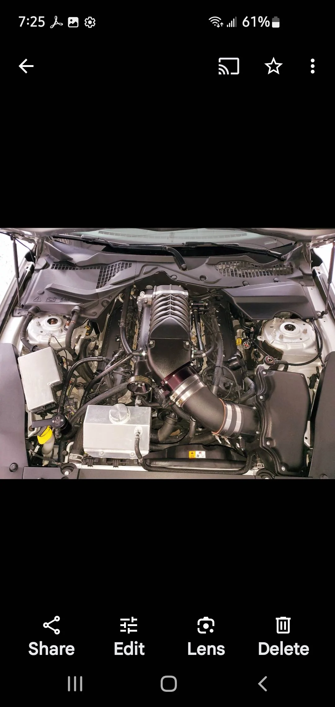

Update: Installed the Radium inline Fuel Damper. Only change was now I can see the Tach fluctuating slightly which wasn't happening before. Radium guy said: since fuel system is performing better, anomalies will be more enhanced. I don't know what to say about that one.
Anyhow now my Whipple 132 Throttle body is now popping at intermittent times.
Sometimes in tune with misfire other times not.
Also never thought this an issue but throwing it out there. Throttle body also howls or a really low toned whistle at idle. Can hear it with the hood closed. Have cleaned and inspected TB and intake assy.
I've read that stock TBs have been replaced due to popping but can't find anything in a search about Whipple TBs popping.
Anybody hear of this with the Whipple TB?

Maybe thermal related. Some have reported issues with the 132 when it gets heat soaked. Guy on FB makes this thermal spacer for $75. Might be worth a try.

If it's howling, that indicates a leak and you're hearing the air passing by the gasket, which would also give you the symptoms of a vacuum leak. Un-metered air is getting into the air inlet post MAF. Pull that TB and inspect the gasket. If it looks good, re-install and torque to 70 in/lbs. Personally I would replace that gasket even if it looks good.
It's not a batch fired system so was the damper really needed ?
Air moving pass the TB blade at low throttle settings will do that.
Who knows if it was needed.
But my symptoms matched what some guys said was their problem.
No I know.
Whipple asked for an idle log so am doing that. They're more help than my tuner was.
