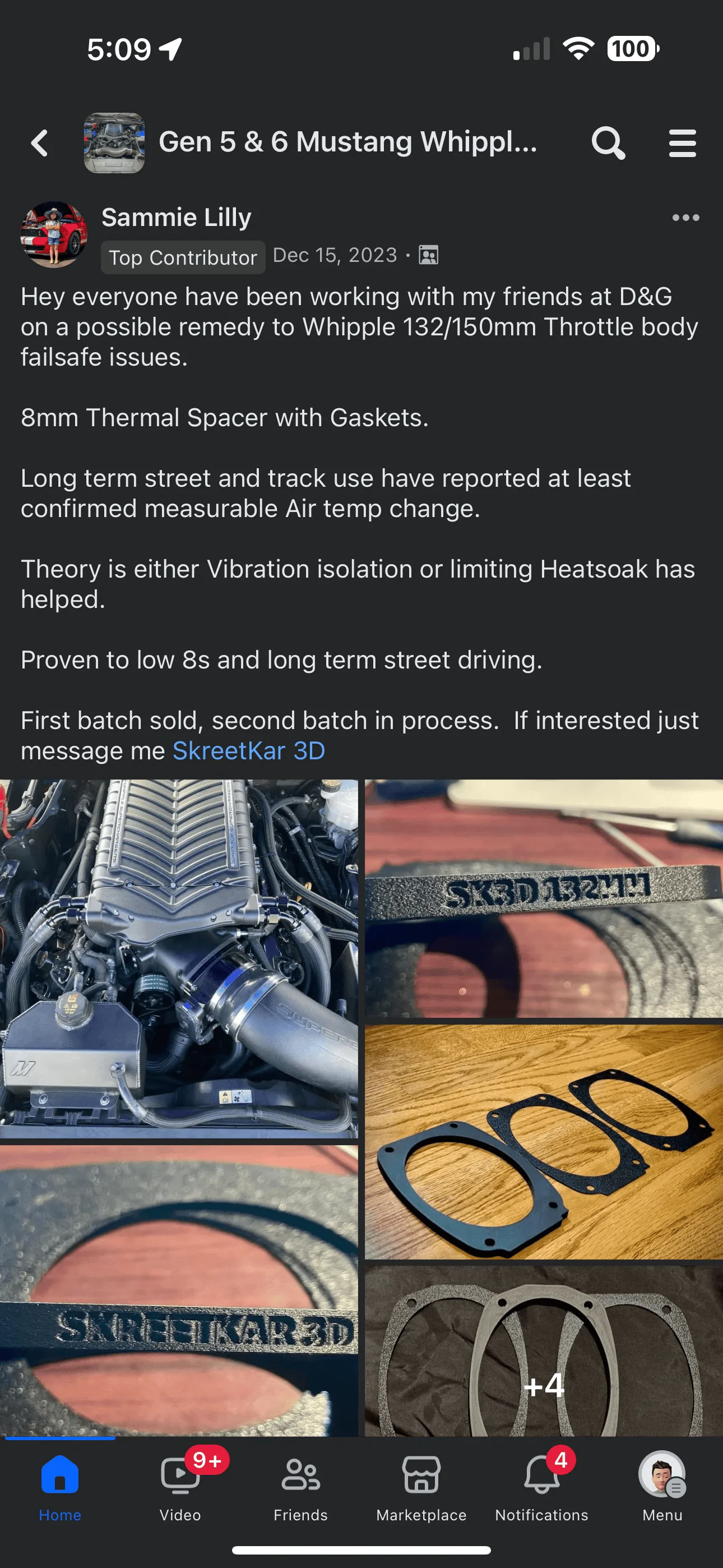

Maybe thermal related. Some have reported issues with the 132 when it gets heat soaked. Guy on FB makes this thermal spacer for $75. Might be worth a try.
Plus my car is misfiring right from cold start.
Thx for the info everything helps.
