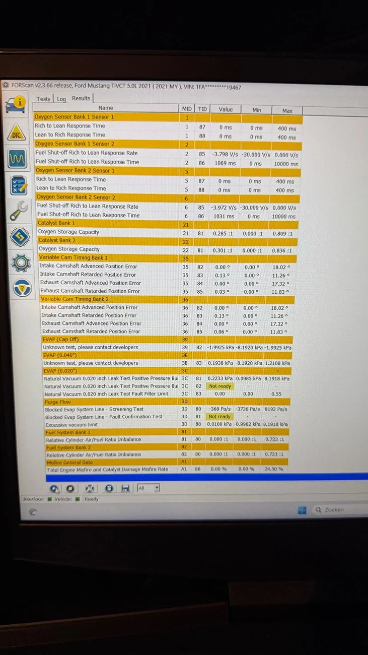

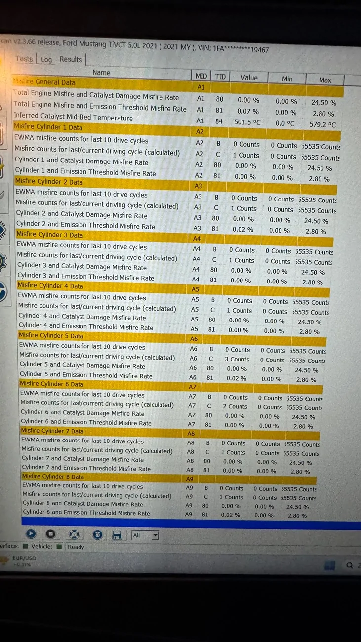

Could a faulty O2 sensor deliver parameters values within normal range? See pic.
My GT 2021 has no DTC’s, but i feel stuttering at low rpm’s under some acceleration load. Operating fine under higher rpms. Mode 6 see some misfires on all cilinders. My shop mention the cilinder shut of system could be tge culprit, but basically has no clue… car is still under warranty

I would not guess bad O2 sensors in your case. Do you have any vehicle modifications? What octane fuel do you use? Have you tried fuel system cleaner? (royal purple complete fuel system)
