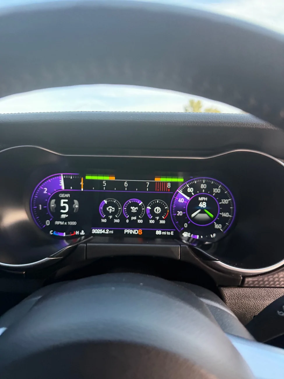

Hello I have seen that it is possible to activate the performance shift indicator through for scan for the A10 mustangs however I cannot find how to do it anywhere can anybody fill me in please? Additionally is there any way to be able to turn off all the lights while the car is on I noticed that even when you turn the headlight toggle all the way to off the three bars in headlight housing stay on pic of my vehicle for attention

I'm just confused, wouldn't it just shift immediately once it hit the shift light? Or is this when you use paddles and are holding revs?

it’s these lights on the dash as the rpm’s go up to indicate its time to shift I know the car will shift on its own it just looks cool on the digital dash

Got it, carry on. I didn't realize it's constantly lit up like that. On my stick i only get it at redline basically. Sorry for the derail

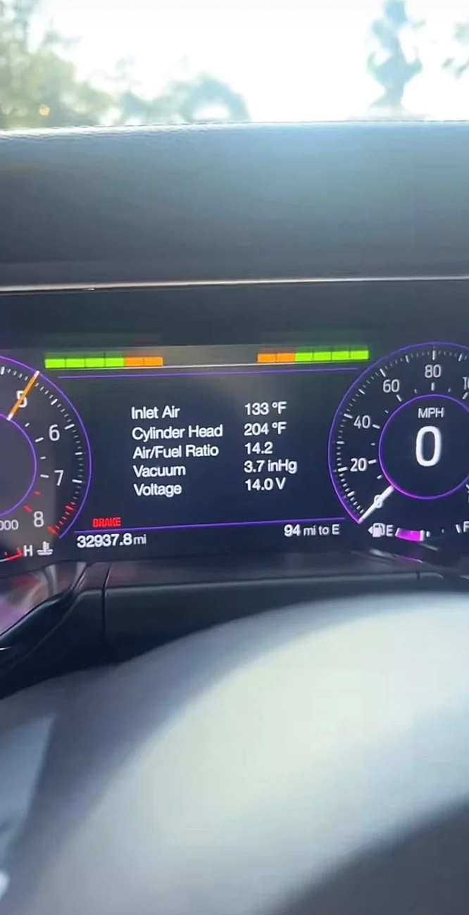

It worked! Also turned on the active guidelines in reverse which is in the same list

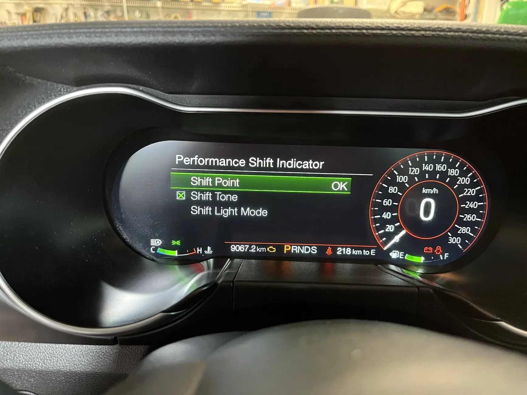

I looked up the procedure from the link (partial list below).
Once you get to this screen (above photo) do you input actual rpm values from the steering wheel?
Perhaps you can post another photo of the adjustments screen?
13. Go to your vehicle settings by selecting the horse by your steering wheel.​
14. You'll see the 'Performance Shift Indicator' and then you can select and adjust the settings.​
15. 'Shift Point' you can adjust the max up or down before it warns you to shift (when it goes red); 'Shift Tone' if you want it to beep when you hit your shift point; 'Shift Light' mode whether you want it to be on your 'Tachometer' or 'Track' if you want the lights to warn you like in F1 etc.​
