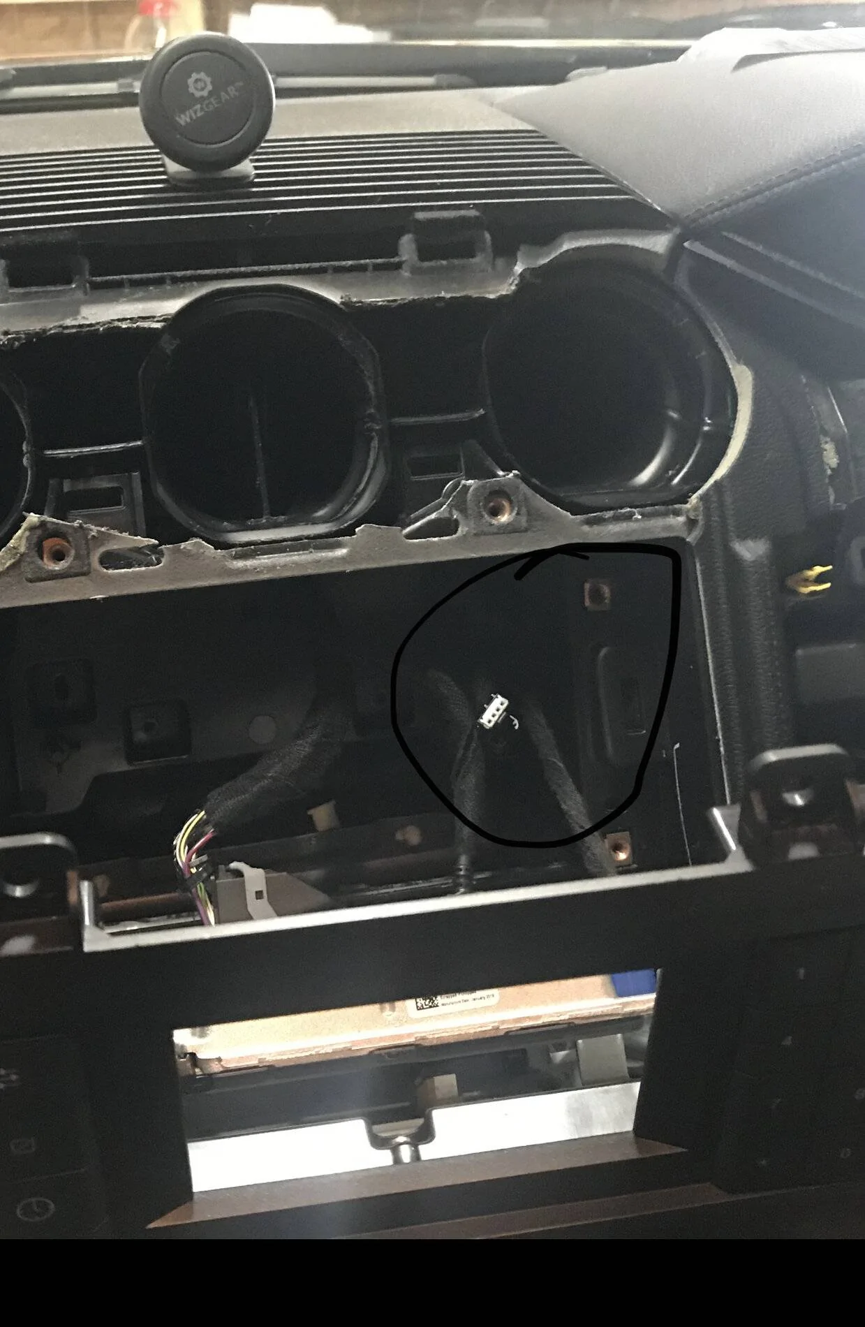

I can confirm on my 19 GT (Non-PP) it had the harness. It is clipped in behind a black plastic shield (you can see it clipped in). I never took pictures, apologies, but it is definitely there.

I have a 19 GT (non-pp) simple plug & play in my car. The plug is right there, you can't miss it. Minor trimming of the plastic vent area behind the dash panel and you are all set. You will also need the dash trim piece that houses the gauges. I have a set of factory PP gauges for sale if you need a set.

I can confirm that on my 2017 GT Premium Convertible (Not PP) has the harness behind the radio plastic. I unclipped and plugged it into the PP gauges and it worked.

It was there on my 2018 Ecoboost Premium convertible so it is hard to imagine it not being on GTs. Plugged in and the boost gauge worked perfectly. Oil pressure, not so much. Requires a custom tune to enable on my car. Not sure if that is the same for the GT models.

On my install, 2019 EB, I had to remove the clips on the back of the dash panel because of interference with the left air duct. I popped the vent out of the dash in order to identify area of interference. Dash would not sit flush without this modification, also.
