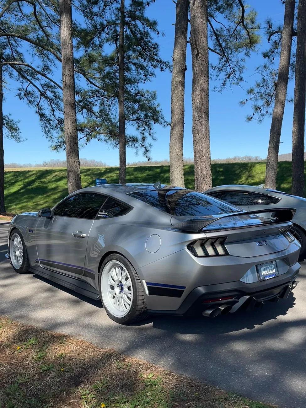

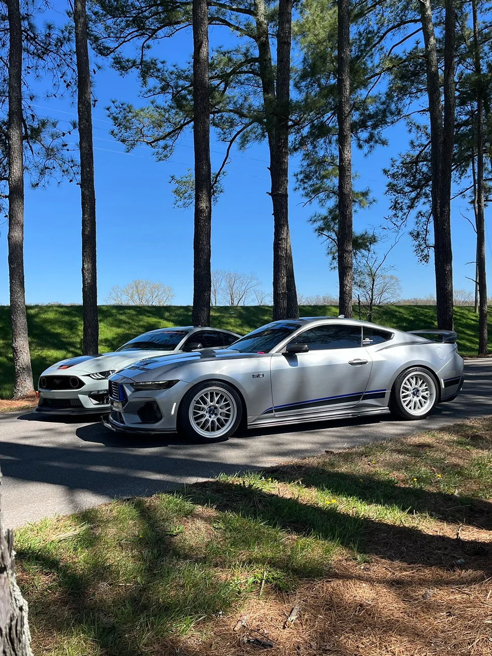

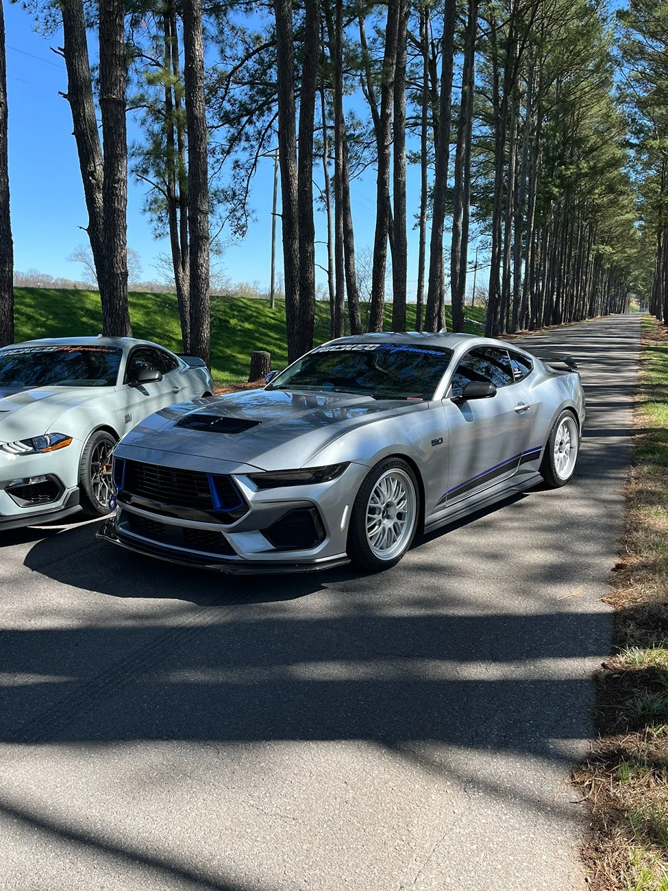

Good friend has Pedders extreme on his S650 GT/CS. The adjustability in both ride height as well as dampening strength is nice. BUT, in order to get decent handling, they have to be dialed up to eleven and it makes the ride suffer pretty bad. I much prefer my Mach 1 with Magneride, it is easier to deal with. That said, I am perfectly happy with stock height...
