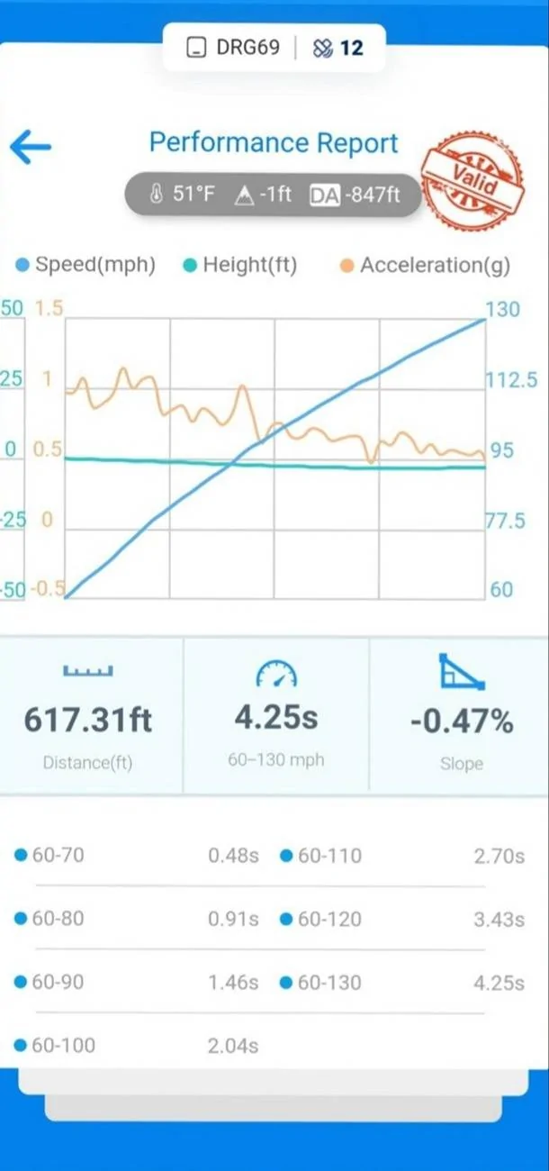

Most will recommend what they have, I personally like the centri on 10r80 cars. To me it works well on the street. Here's a dragy from my car on the street. Vortech with 3.33 pulley on e85.
What’s the psi on that pulley? Very nice!

-847 ft. Wow. I wish we saw shit like that out in California.
