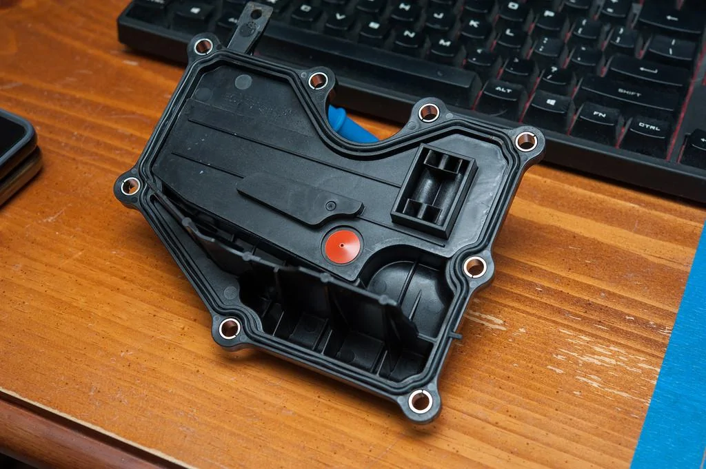

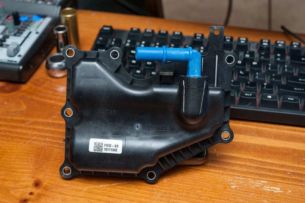

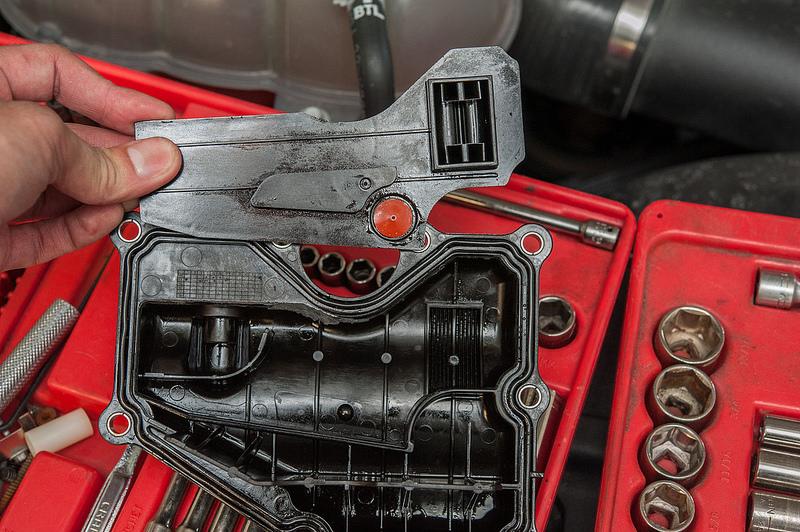

yup.. looks the same on the outside except for a blue PCV and different barcode. I ordered the updated oil separator Part # FR3Z-6A785-C for my car and it arrived earlier today.
My car smoked like a chimney once I installed the DP and exhaust so I gutted my PCV with a DVCC which solved all the issues. I'm going to install the updated PCV just as it is and see if the car smokes at all. I'll also cut open the original oil separator and take photos just for giggles.

Once the intake off you can remove the hose connection that connects to the PCV nipple; you will see a black plate (oil separator) that has 7-8 8mm bolts holding it on, remove those bolts and remove the black plate (oil separator).

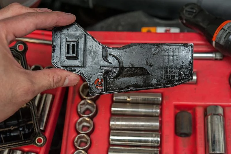

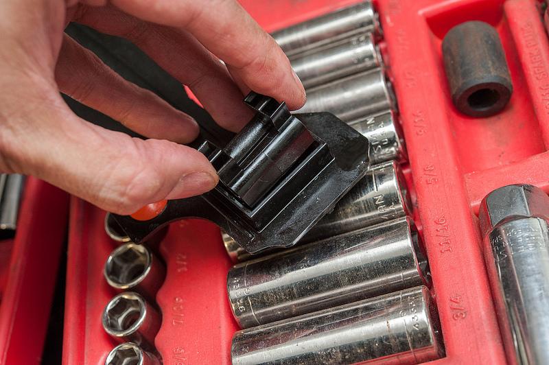

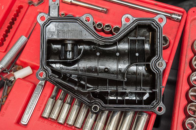

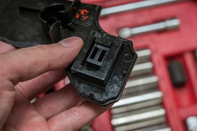

now the fun stuff... I opened up the stock original oil separator this woudl be the original run FR3Z-6A785-A the new one is revision C which I won't cut open unless I guess they release another revision.. lol
I broke the tabs off to get this piece out..
Quite honestly surprised how little there was in there. Just couple baffles and that piece that snaps out that, from its design, seems to handle most of the oil separation.
