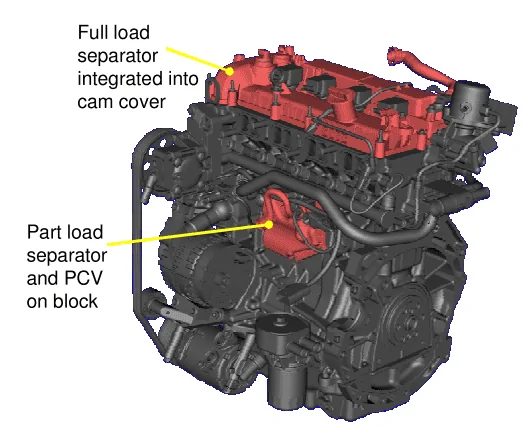

1)No mesh AFAIK on PCV side ,it is mounted/part of that side plate on driver side block under IM .
2)PCV can me mounted many places as long as it connects to crankcase .above gives location 1) .
3) read 1) .
Here overview , Ford calls these PCV parts wrong IMO , but anyway .
PCV is mounted in the upper block plate below IM, during non boost vapors get sucked to the IM from there (PCV open) . Also fresh air is drawn in from turbo inlet pipe to valve cover .
During boost PCV should closed (you don't want to pressurize crankcase) , and vapors get drawn in from valve cover to the inlet pipe on turbo .

Thanks for the reply, so it looks like there will be some sort of separator for both the block port and the valve cover port (assuming ford used similar designs as the 2.0).
Also when people refer to the PCV valve, is it an actual cylindrical inline check valve or are they referring to the plate located under the intake manifold as in the check valve is built into the plate?

there good pic in the "blue smoke out exhaust" thread , but yes there the check valve that swivels in the plate .
Thing is Ford sells it as whole assembly AFAIK ,at least that's how it is listed on there online parts list.
