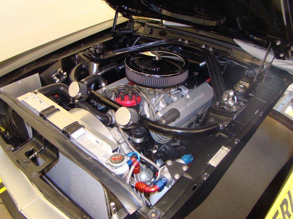

I made my own breather set up. I
know it is a Vintage Race engine. it's old & so em I.
