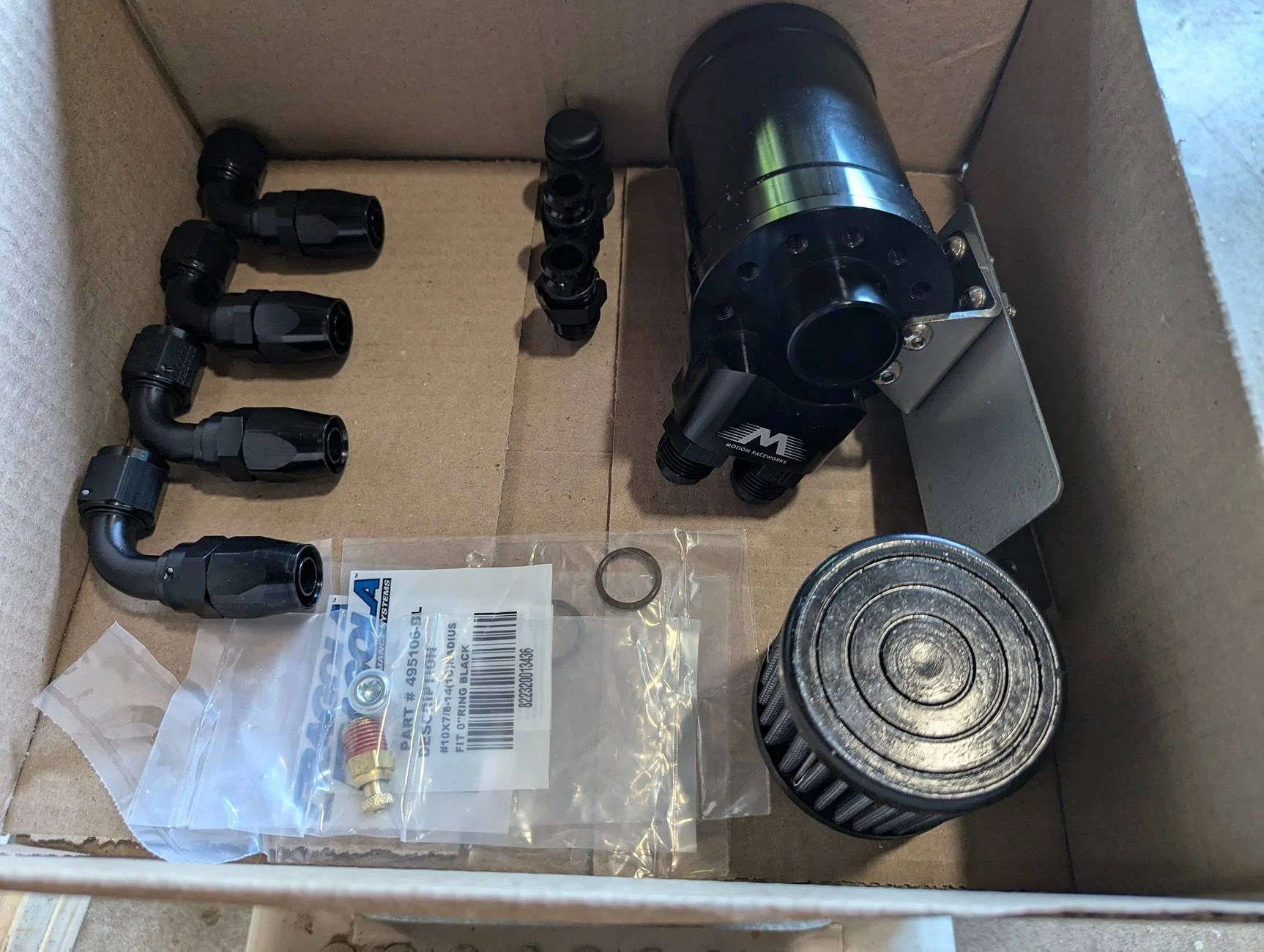

I must've misread the post. My catch can setup in the picture.
The only oil you get is whatever settled out the vapor.
