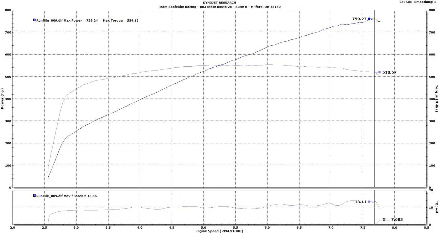

Tom is tucked back home in Indiana with his car, but it left with some new found power!
We installed Tom's stage 2 whipple, went down a step on the pulley, added one of our custom Fore Fuel System setups, and had Lund go to work on the dyno!
Once the rollers finished, his car laid down a nice 759 rwhp with the corn!!!
very pleased with the hp on this one, and torque flat across the board!!

Nice numbers! Terry can you give a little more detail on the fuel system and how its setup please?

This was a level 3 fore setup, and then we modified the -8 rails to work with the id1300s, normally you can only for the whipple rails, but we have the process down pretty good

What pulley Terry?!? 3.625??? What other mods to the car beside blower/fuel system?

WOW! Thanks for posting such a real, genuine dyno graph with no funny business. That's a flat torque curve to die for!!
3.5 pulley. O/R LT's, Corsa Extremes. They put OPG's and a RXT setup in before install
Does this car have the 20% ati balancer?
Nope. Waited on the balancer and plan on doing it when we go with the 10 rib setup on the new motor.
