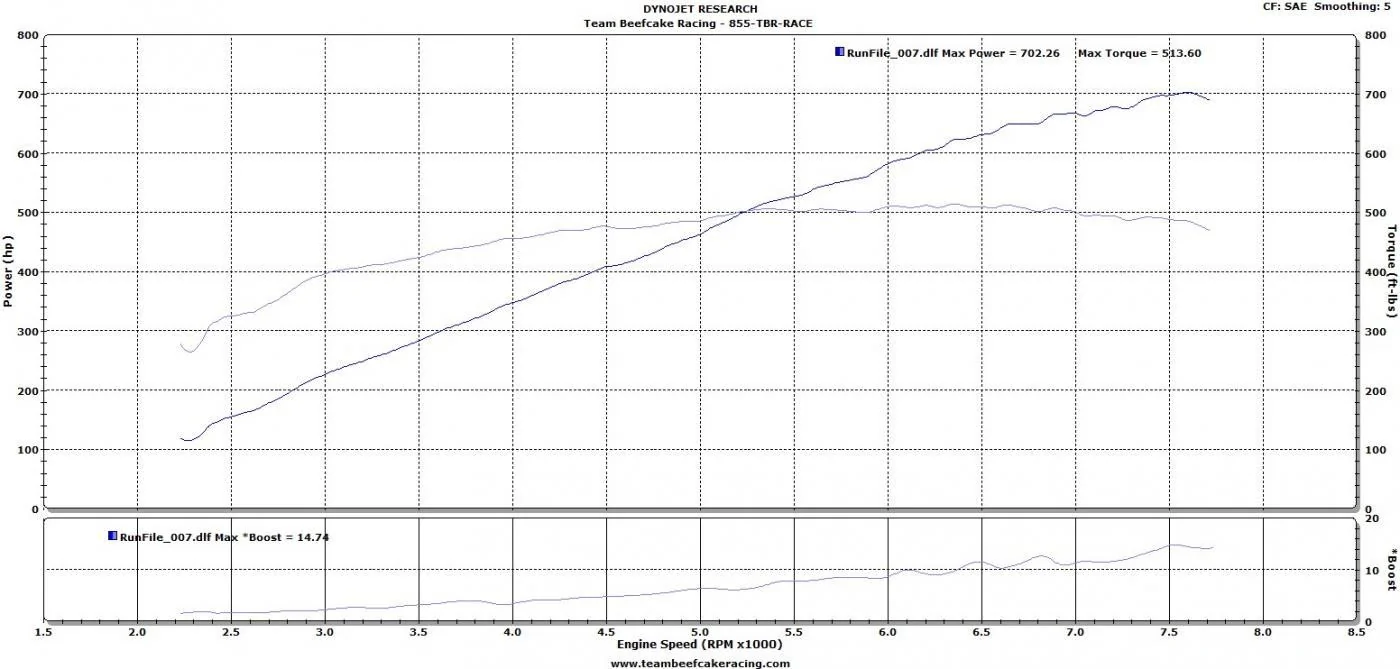

Tiago sent down his Outlaw Packaged 2015 Mustang to have our partners at Finish Line knock out another install!
Tiago went with the Vortech Oil Fed JT trim comp kit which comes standard with an 8 rib setup and 3.6 pulley.
Along with the blower, we fortified the engine a bit with some billet oil pump gears and crank sprocket.
We also added a circle d converter, viking crusaders, and stainless power long tube headers.
Car should be headed back to Canada to do some low 10 sec passes on pump and 9s if he decides to throw some race gas at it!

Now that's a good looking power curve.

Interesting, most people are already running E85/Race Gas to get in that power range..
Assuming you already know how much boost this was done on? You need need e85 to make 700, it can be done on 93 and 12-13 psi

A little contradicting there, then actually you don't "Need" E85 to make 700whp since it can be done on pump with enough boost, I just figured detonation was the limiting factor here not boost pressure, but apparently they make good power on 93 as well.

The car is almost making 15lbs of boost around 7k rpms with the 3.6 pulley with headers. Few factors come to play 1 JT trim head unit 2 no intake on the head unit 3 a mixer of both.
All I want to know is what is begin done about fueling to make 700whp on 93 with an auto on top of having a stall also?
JMS boost a pump + Id 1000s
