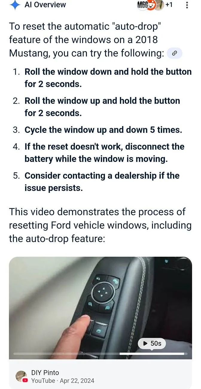

A Google search brought up this AI response. There are also several YouTube videos on the subject.
