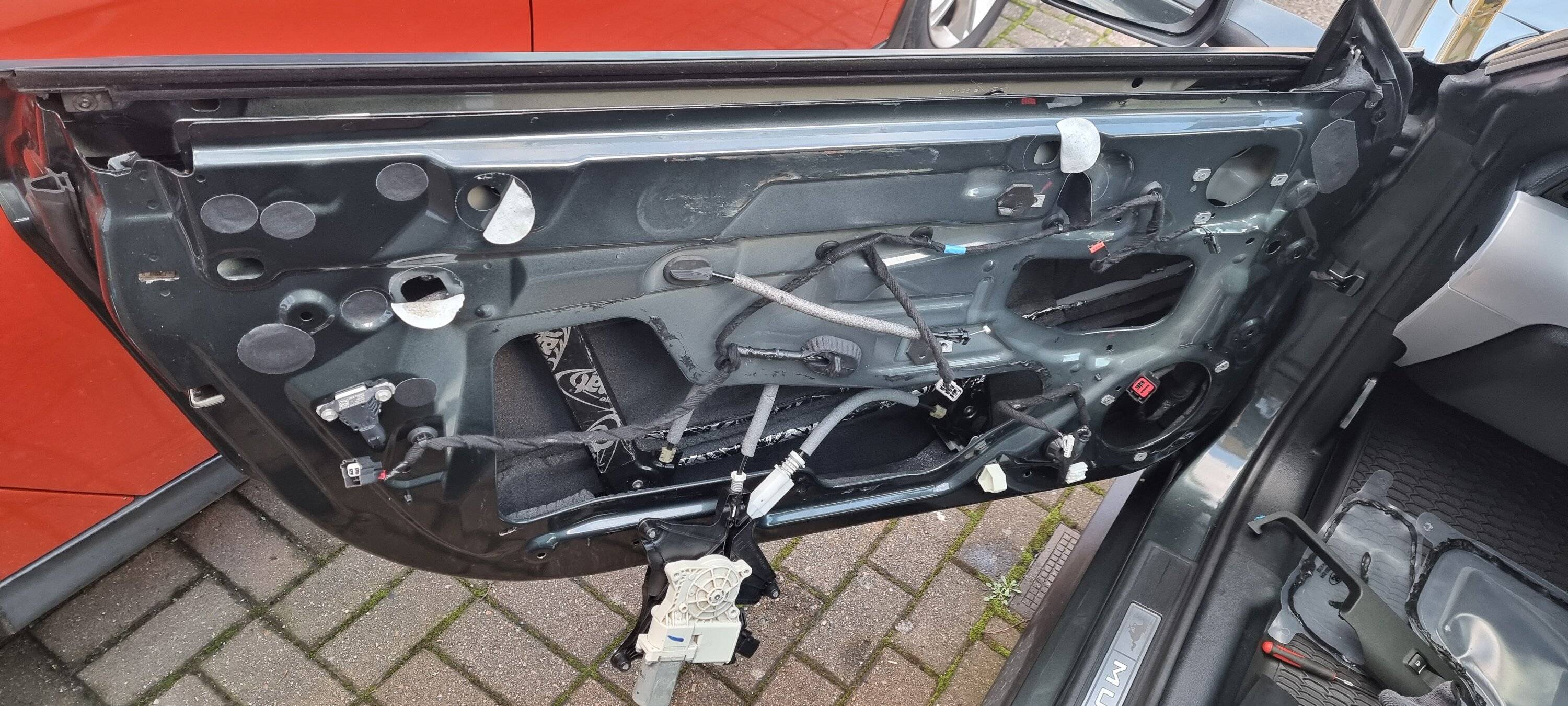

I finally got round to removing the window motor. It was a bit of a ball ache, as You have to remove the glass. The inside of the door and the window motor was pretty wet too.

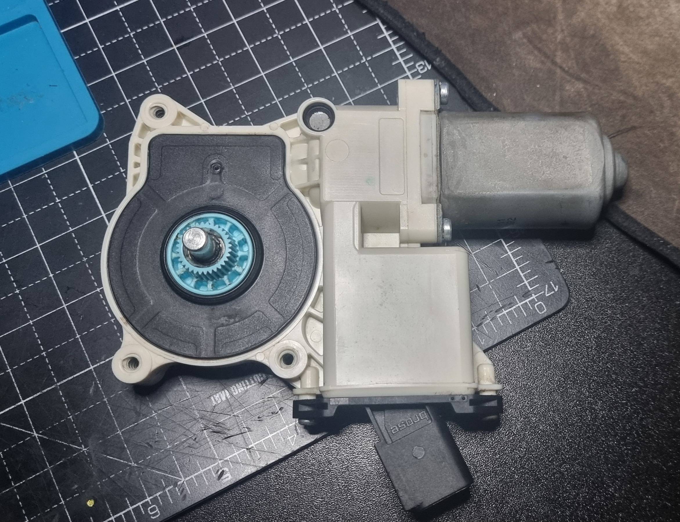

The actual motor was wet, I was able to flick water out of it. I also dried out the inside of the door at the same time but it was wet again when I checked on it yesterday, as it had been raining.

I fitted the window motor back but somethings not right. The motor only works in short bursts, so the long press doesn't fully open or close the window, the motor doesn't work when the door opens or closes but what's more weird is the switch is backwards. Pressing down the window goes up and pressing up the window goes down. This this the same with the switches on both doors. The drivers side window goes down when pressing it down and up when pressed up.
GR11M
GR11M
Mar 13, 2016
110
2,250
890
Herts, England
Graham
Ford Mustang GT
I managed to fix it but I don't know how. If you take the metal cover off the motor there's a chance it will pull the shaft out far enough for the brushes to pop out. I pulled it all out and rebuilt it a couple of times and it suddenly started working but I don't know what was changed.
