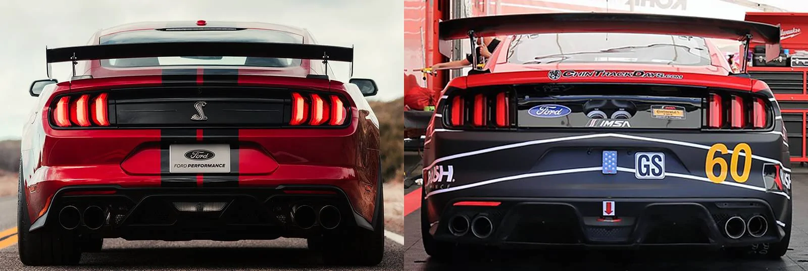

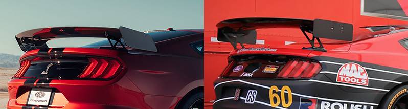

Do you also plan on matching the installed height of the wing? As mentioned above, it'd be a great option to offer differing uprights so the wing could be brought up higher if desired.
A comparison of the CFTP wing elevation vs the GT4 elevation...

We will start with the OE 500 wing. Simply adding taller rear uprights changes the aero for the whole car. GT4 and GT500 have different front ends, spoilers etc.

I agree. My point in mentioning it was in the sense that there will be a number that buy these that are pretty serious about tracking and a typical aero mod in that group is to extend the splitter up front, etc. Taller uprights that fit into the base at the decklid and also mate with the wing make sense in that regard. Then again, it's nothing some CNC programming and some aluminum stock can't take care of. The fact that you are planning on offering the wing at all is the first step and I'm thankful for that.
Correct, but two things to keep in mind here. One, as Epiphany mentioned, many of us will be adding more front downforce via larger front splitters. And two, there will be many gt350/R owners interested in this wing. Many of us already have actual GT4, or fp350s front aero making a taller gt4 height rear wing the perfect option.
AC: I certainly don't doubt your statement but I for one would like to see a wind tunnel video of both configurations. It seems to me that raising it too high would put the wing outside the area of laminar flow along the body surface. Granted, it might be "cleaner" air but I'm wondering how much drag, if any would result and what speed range is the goal. Obviously, many racing teams opt for very high wings so clearly, there's something to it but again, I'd like to see the wind tunnel data. Additionally, many if not most of these high wings are computer-controlled so the angle of attack changes constantly.
