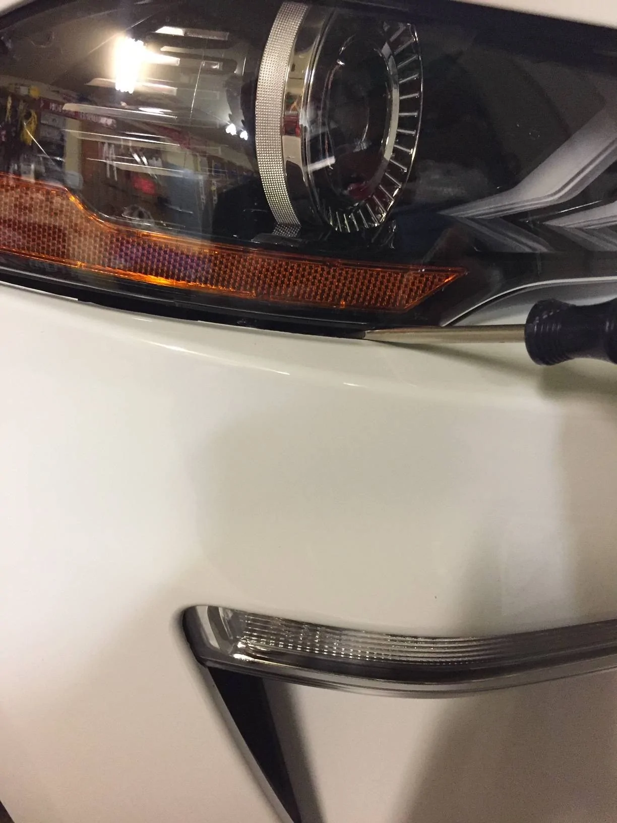

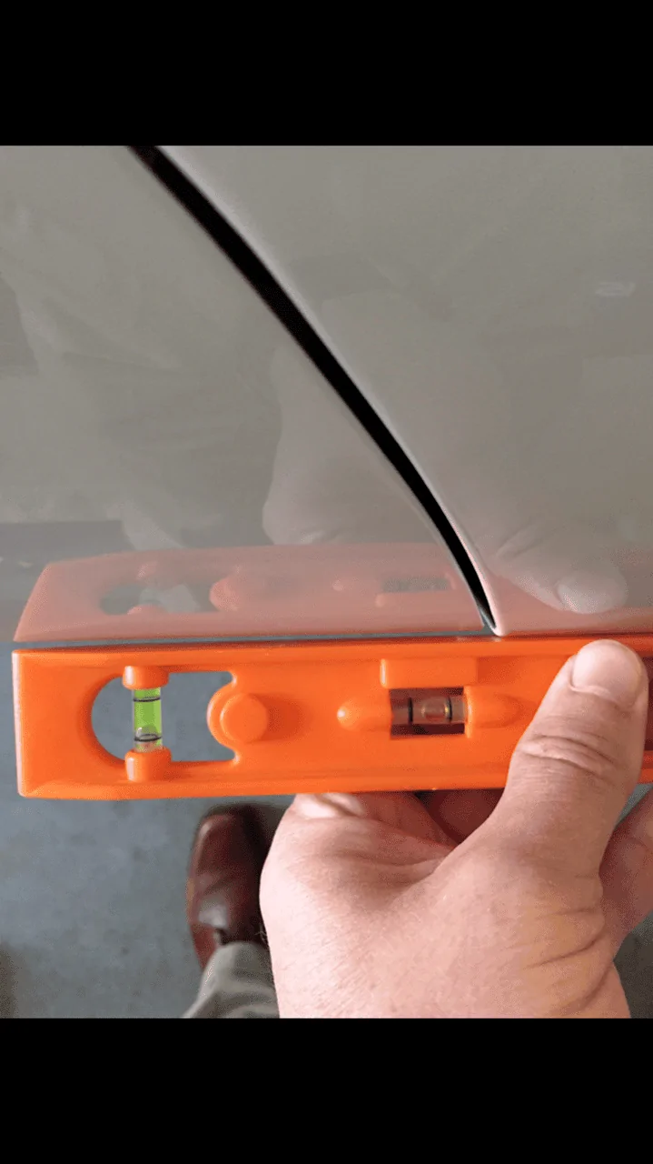

Quick update. Went to the dealership with a body shop. Those guys were fantastic. We looked at some other 350's on the lot and a few GT's. The gaps on the 350 were abysmal for a $90,000 car and so much worse. The body shop said they are going to have to fix it prior to it being sold. The good news is they seemed pretty confident that they could get the hood fixed and possibly the bumper. Evidently there is a TSB for the bumpers that requires body shops to drill in to prevent sag. For the hood they are going to adjust the fenders and raise the stops as mentioned above to see if that helps. The bumper is really just hit and miss. I have an appointment in two weeks I will let everyone know how it goes.

Was this ever sorted out? My front bumper isn't aligned at all and in fact keeps breaking the side bumper tabs where it joins the fender because of the misalignment. I've been told there's no way to adjust it either. Body shop at Heritage Ford in Scarborough are saying this.

Also, the bumper is against my passenger headlight and there's a big gap on the driver's side. Again, they're saying you can't adjust it. Really? 2017 Mustang and you can't adjust anything to fit properly?

It seems more like a design issue than an assembly issue. The snap-in-place tab system Ford uses on these bumpers just doesn't result in a good fit.
