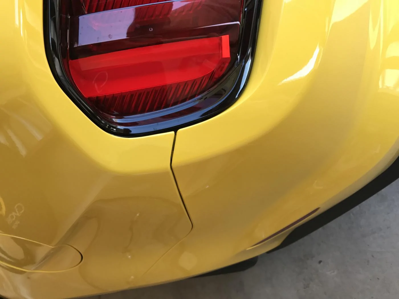

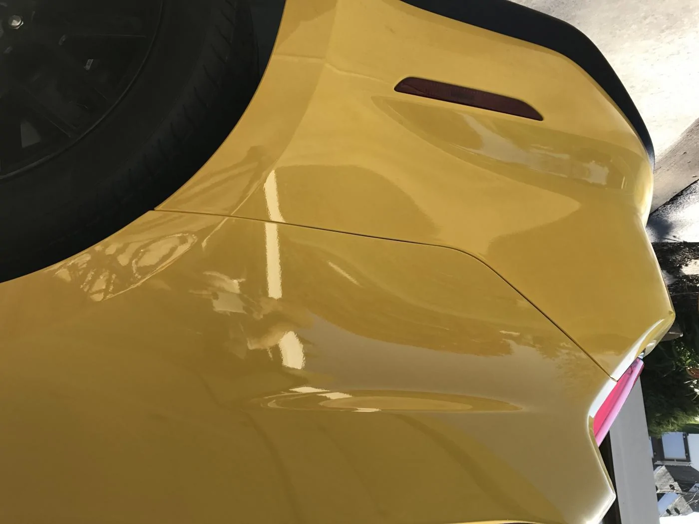

Man, 2 months and a 1000 miles, bam! Maybe it will just fall off?
The first giant sideways pic is the drivers side gap. I can see the clips I believe. This was not like this when I purchased it. The 2nd sideways giant pics is the passenger side. At the end of the bumper near the wheel it is very tight with the quarter panel overlapping the bumper. It was like this at purchase and I was fine with it due to knowing about Ford Mustang QC sucking.
Dealer I purchased from does not have a body shop. Not sure if normal techs mess with this or not. Has anyone self fixed the rear bumper gaps?

According to my body shop, the clips for the bumper cover may have some play, but not truly adjustable.
