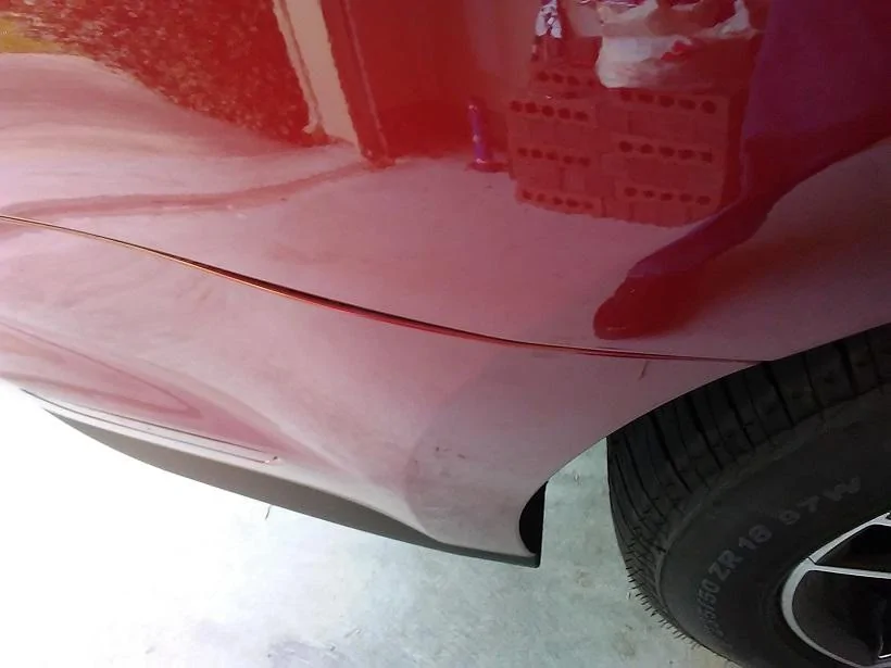

I have some of the same issues, although maybe not as severe on the hood. The one that bugs me the most is this issue with the rear bumper fit, where it joins the metal fender. I can pop it back into line, but after a day or two it loosens up again.
P.S. Mine wasn't delivered with this bumper gap, it took a few weeks to develop. Hot sunny weather seems to make it worse.

That is very similar to what I have. I had the dealership take a look. They ordered new clips and they said this was the best they could do since it was just plastic. Still hoping for a fix. I’ll update when I get to another dealership or hear back from corporate.

I had the same bumper issue. My dealer sent pictures to the Ford tech team and they said it's from too much pressure being used when putting the bumper on. Those clips are ratcheting and only go one way so the only fix is to replace them. I got my car back last Wednesday and it looks just fine with the new clips. I'll keep an eye on it though to see if it starts bulging out again.
I have the exact same issue on the same side, rear passenger bumper, just like the photo

Called a dealership with a body shop. They were more than aware of the issues. They said to bring it by so they can assess it. Appointment for 8am tomorrow morning. Will keep everyone updated.
My '16 didn't have any panel issues, but my '18 had the same bumper issue on both sides. I loosened the wheelwell bolt and then pressed the bumper back into place where it was buldging, like in the photo, and then re-tightened the wheelwell bolt. Long summer with a lot of sunny 85-95f days and the buldge has not returned.
