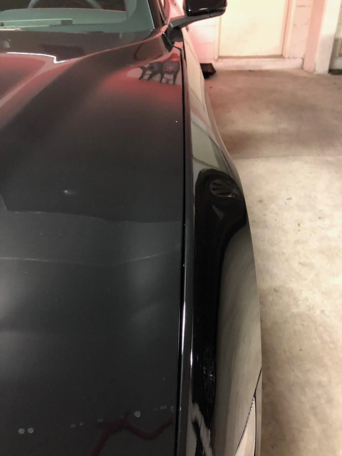

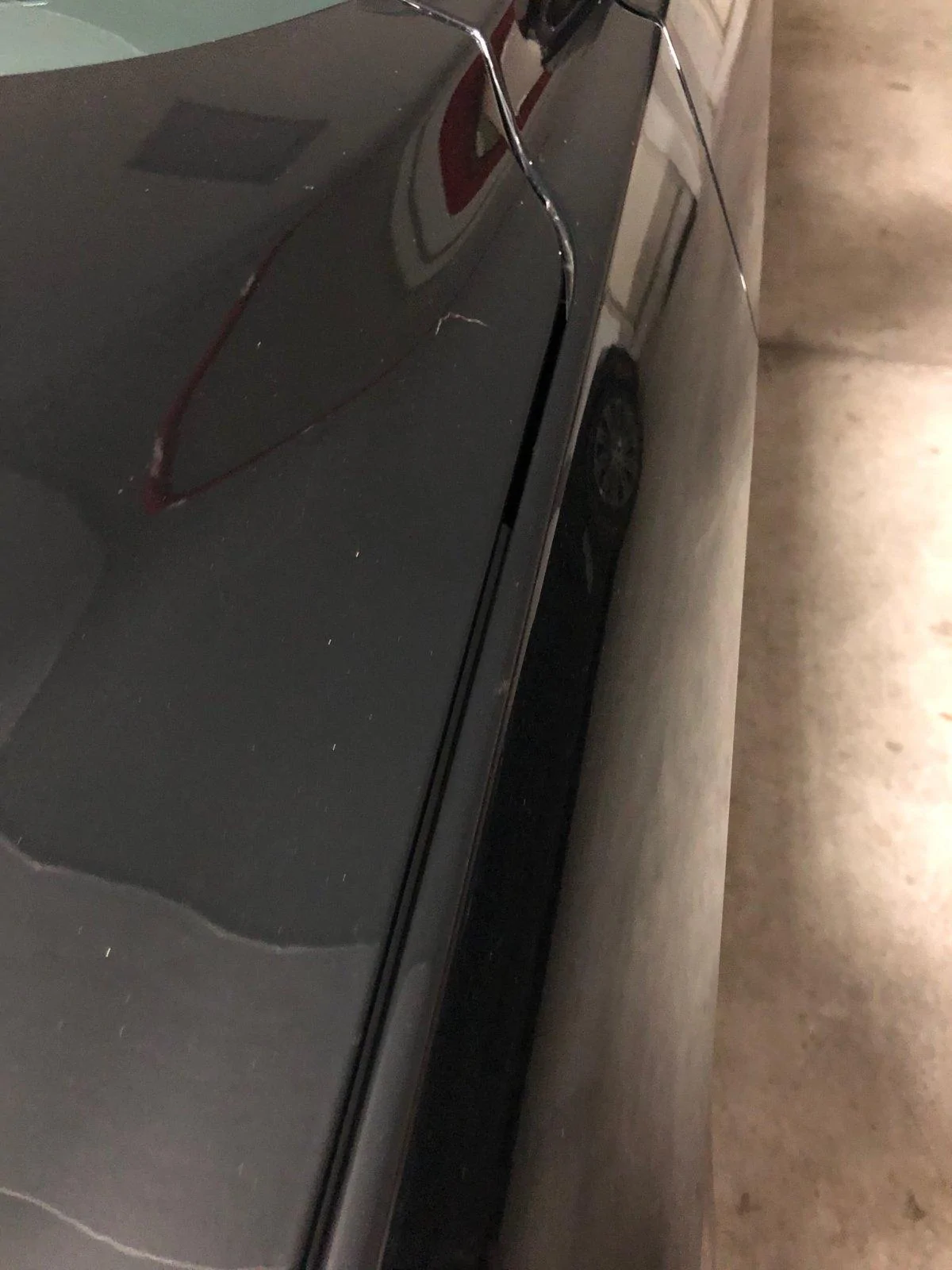

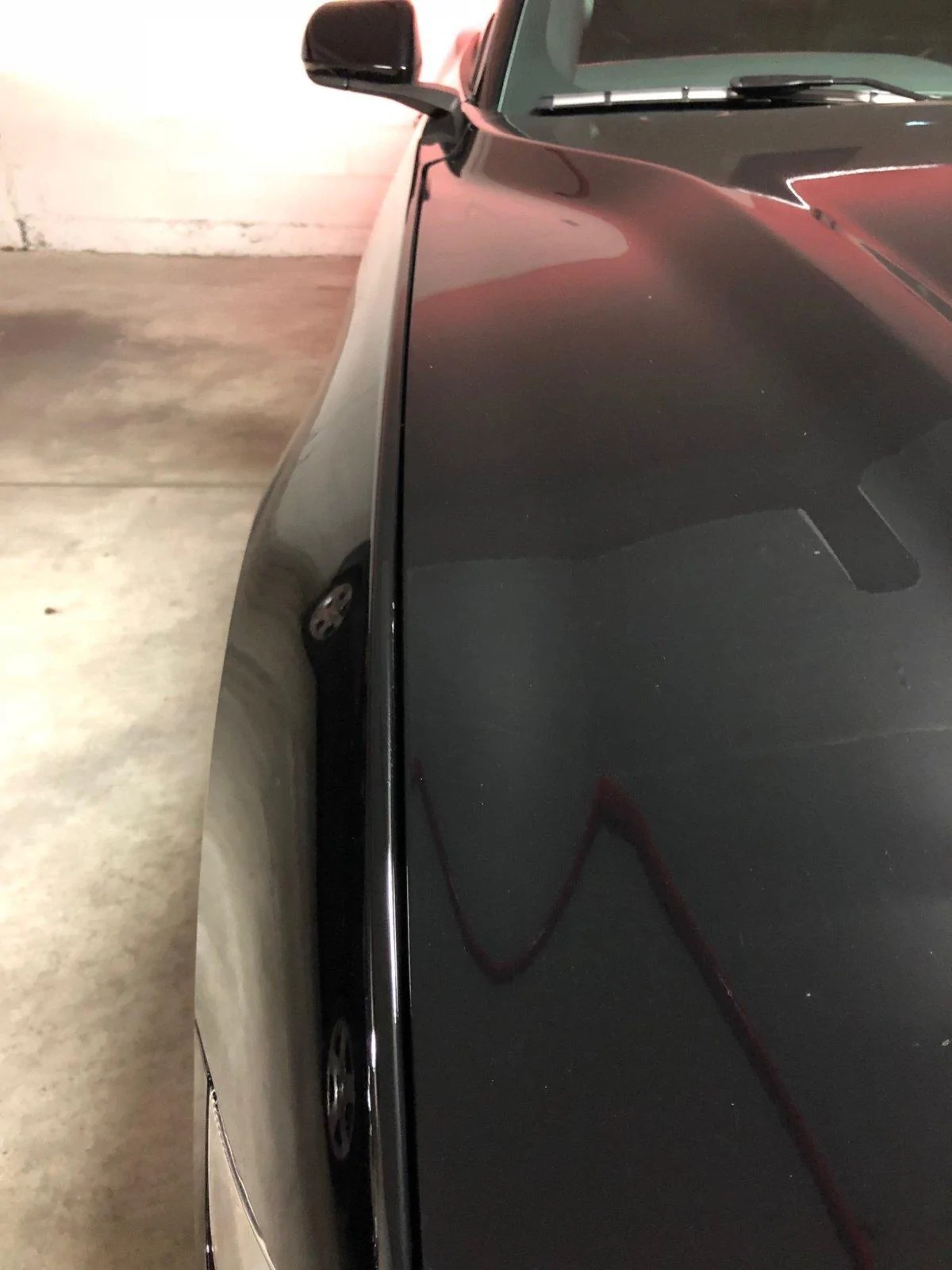

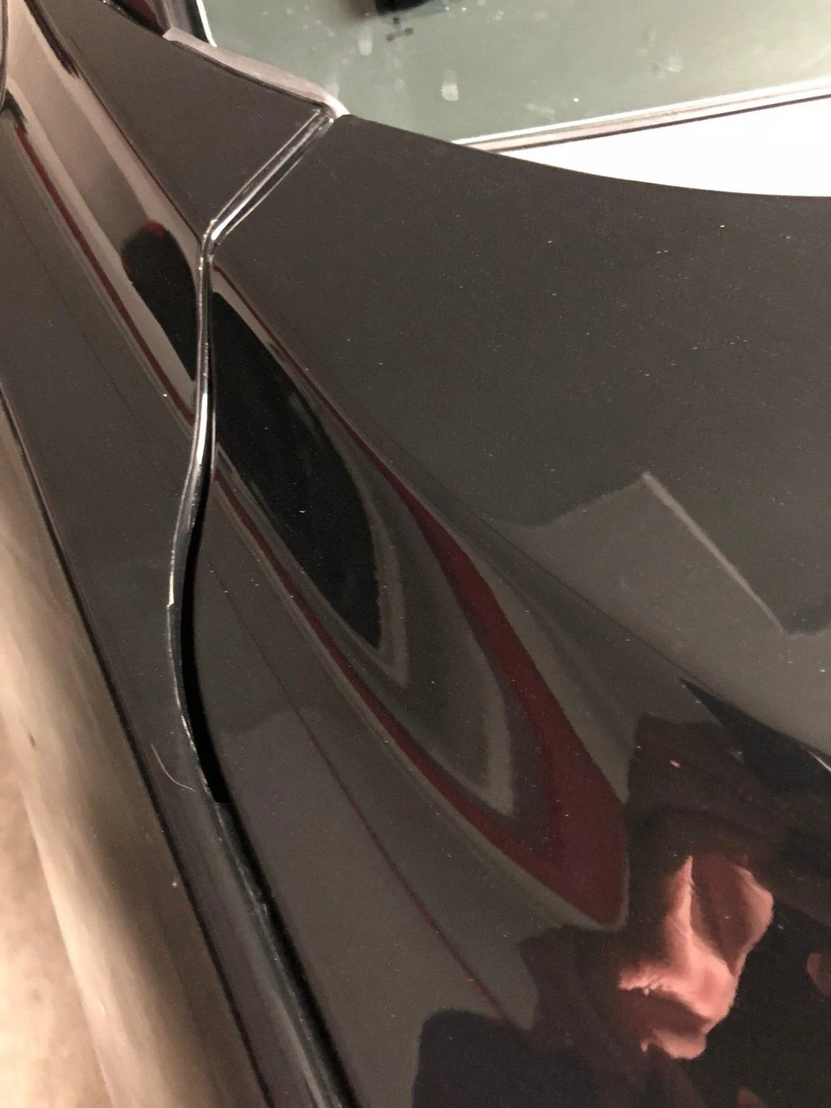

Good morning everyone,

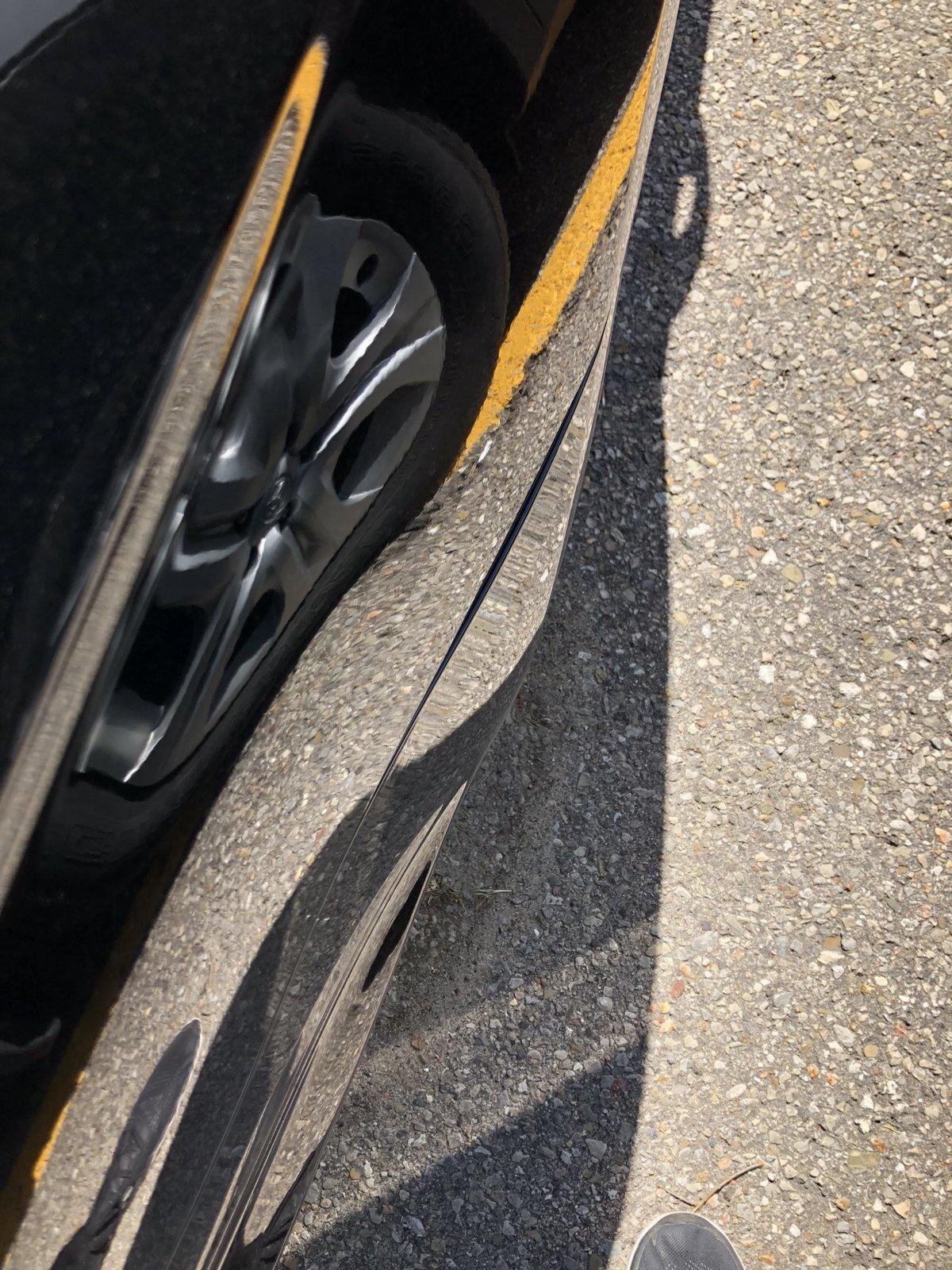

Just looking for some assistance regarding an issue with my 2018 Mustang. I have two issues regarding my bumper and hood. The hood appears to have very narrow panel gap near the front and then gets much larger towards the windshield. I took the best photos I can, but I can easily stack multiple coins and drop them through the gap. I am not sure if this is normal. Took it to the dealership and they said they couldn't fix it and wouldn't touch it. There is also a noticeable gap between the fender and the hood. The hood sits about 1/4 to 1/2 an inch lower than the fender. Very easy to see while driving. Photos attached below.

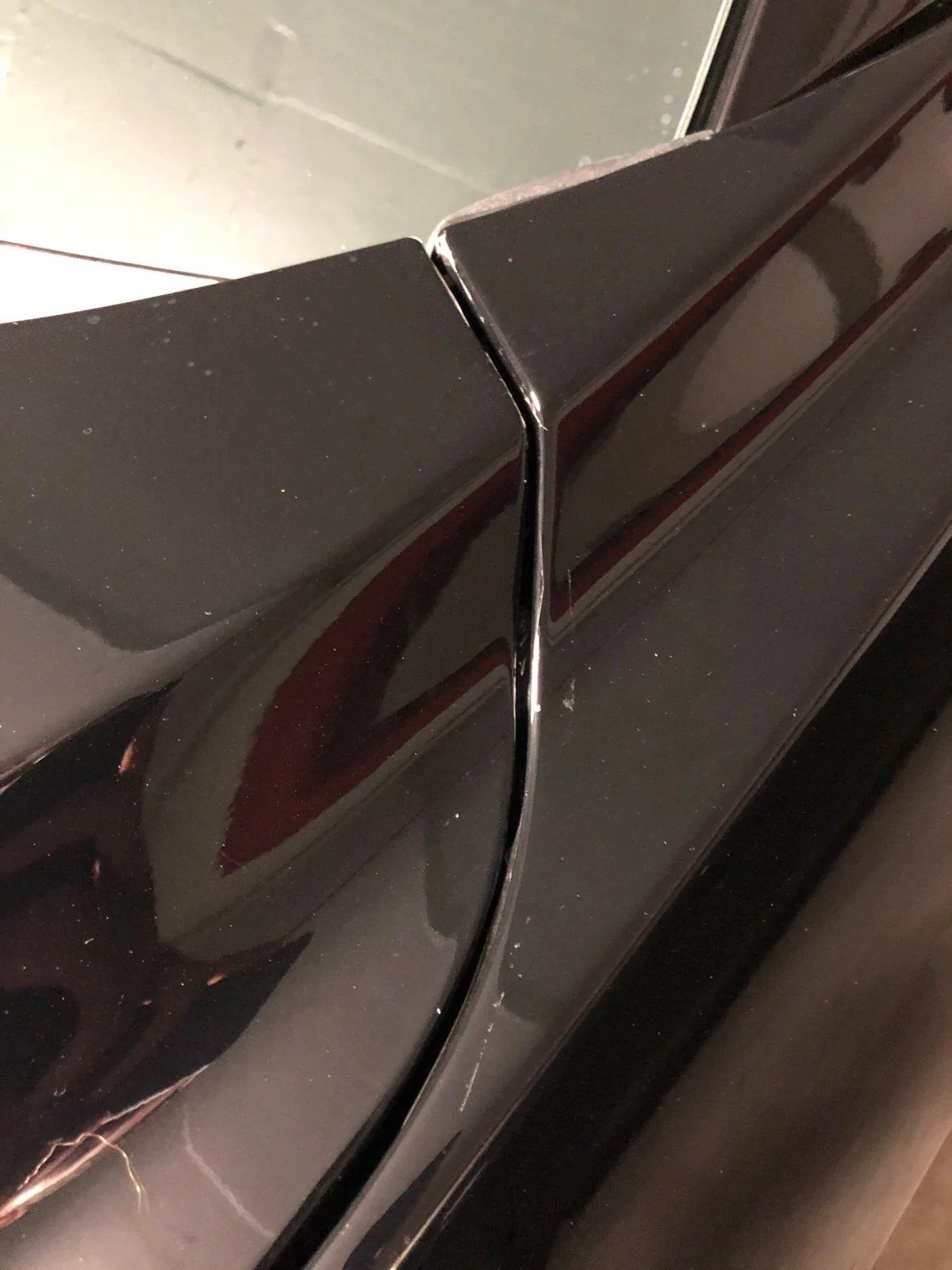

I also have a gap in my bumper, this is much more minor but super annoying on a new car. I had the dealership take the bumper off twice and they said they can't make it any better than it is.
Just wondering if anyone has experienced anything like this or had any advice on what I should do.
Thanks for any help in advance.

Panel gaps have sucked on the S550 mustangs since 2015. This is nothing new.

The gap on the fender, half of the cars on the lot had that when I picked mine up including mine.
I just pushed on the fender and I believe whatever clip that was there got seated correctly.
Regarding the hood I have the same issue. As you are saying I cannot understand how this is and has been acceptable. The car was 55k otd....

I had 3 panels that needed adjustment. I took it to a Ford dealership in the area with a body shop and it was corrected in 45 minutes while my wife waited in the lobby. If you can find a Ford dealership with a body shop that is your best bet. Otherwise Ford will send it to a body shop for a 30 minute adjustment.
