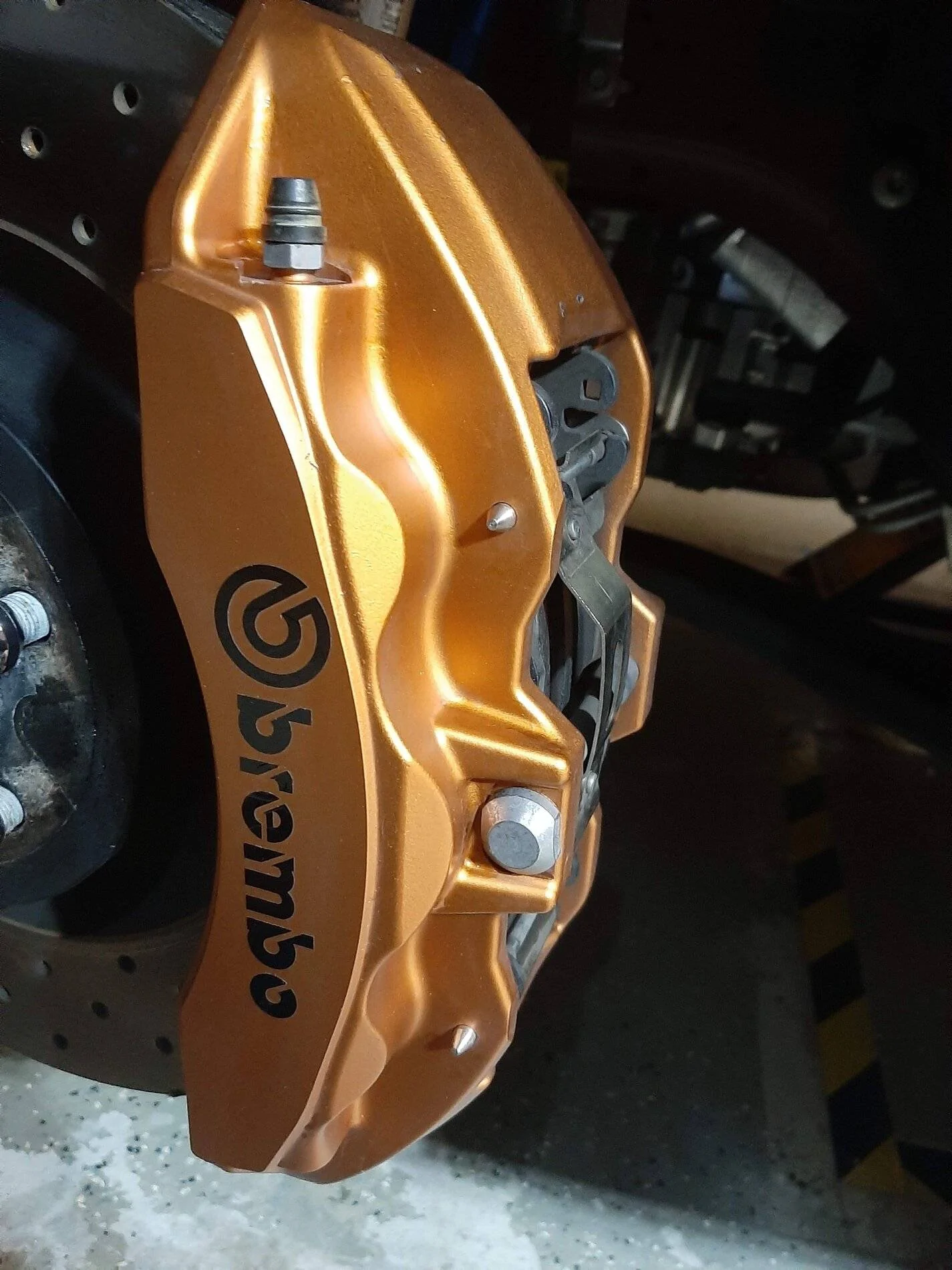

I've done a couple sets myself. They came out great IMO as well as other people's 2 cents. G2 and some diligence. The powder coating thing sounds great but I don't like taking things apart until need be and it's costy for a part of the car that gets grimy daily.
Here's my examples.... $50 bucks, a few hours, and get back to living.

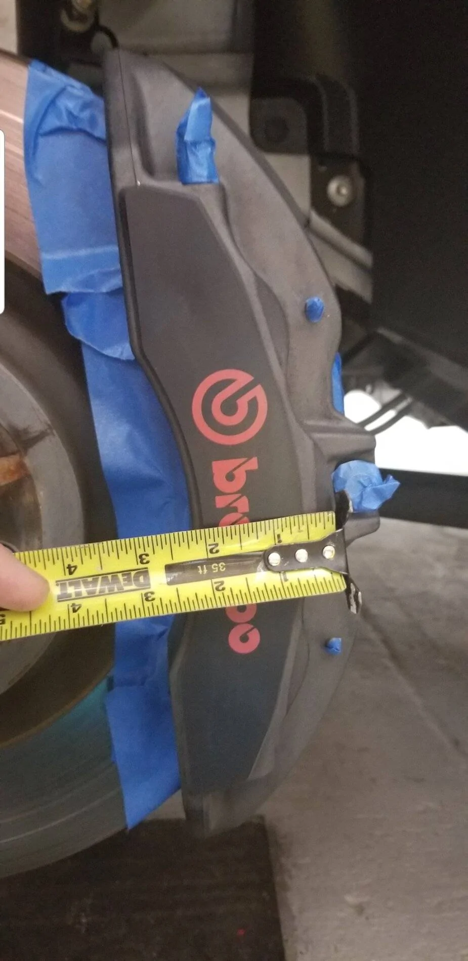

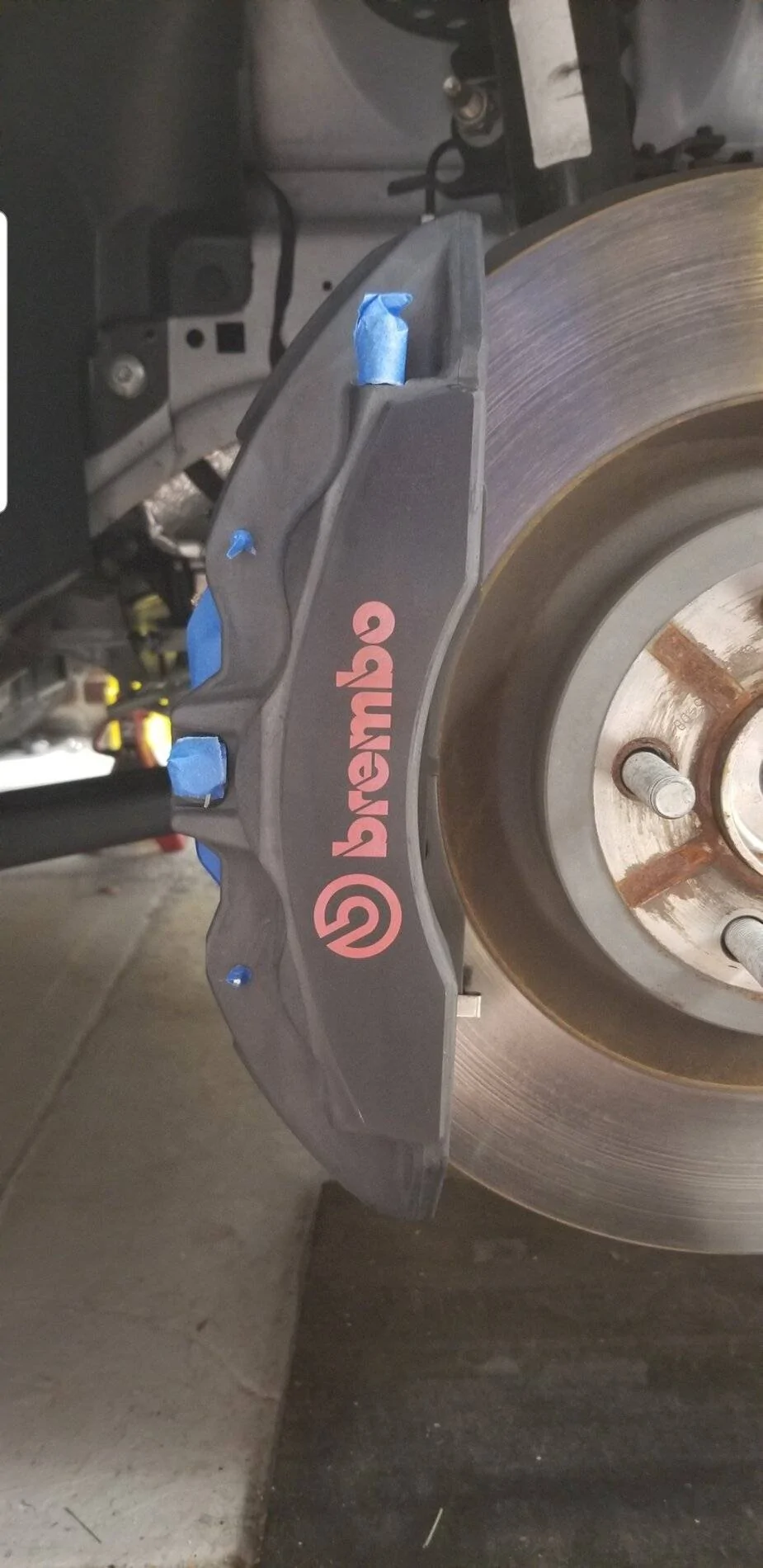

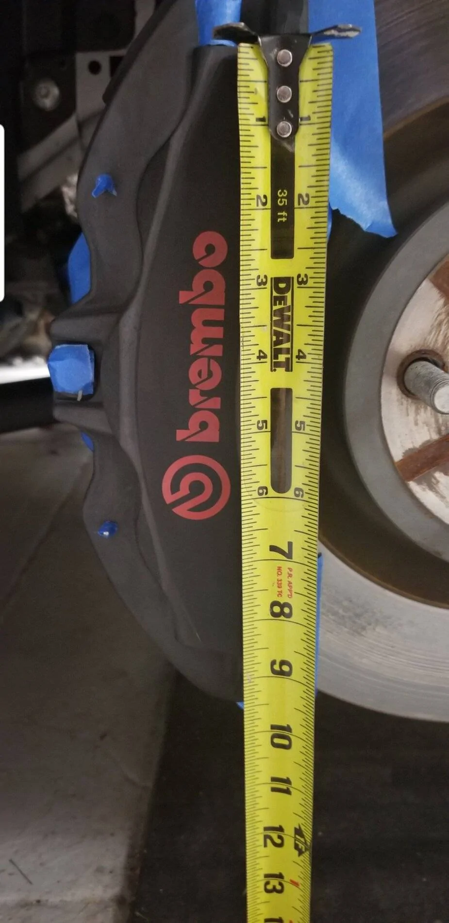

I purchased the G2 brake paint kit on Amazon for $50. Put the car on 4 jack stands, pulled off all the wheels, sprayed the calipers with the cleaner included in the kit, wiped it down extra clean, used painter's tape to cover all the areas I didn't want paint on, take some photos with a tape measure so you can put the new Brembo stickers in the correct spot. then painted all 4 calipers. Be prepared to do it all in one sitting. There's plenty of paint in the kit even though it's a small can. Follow the instructions but I recommend an extra couple of quality brushes. After you do the last caliper, go around and touch up all of them again. Get the painters tape off before the paint dries completely. Wear gloves... the paint is epoxy 2 part and it's going to get on you. It might look rough at first but the paint dries smooth and glossy. Be patient. Give it 24hrs to cure and slap on the decals. Here are some photos...
