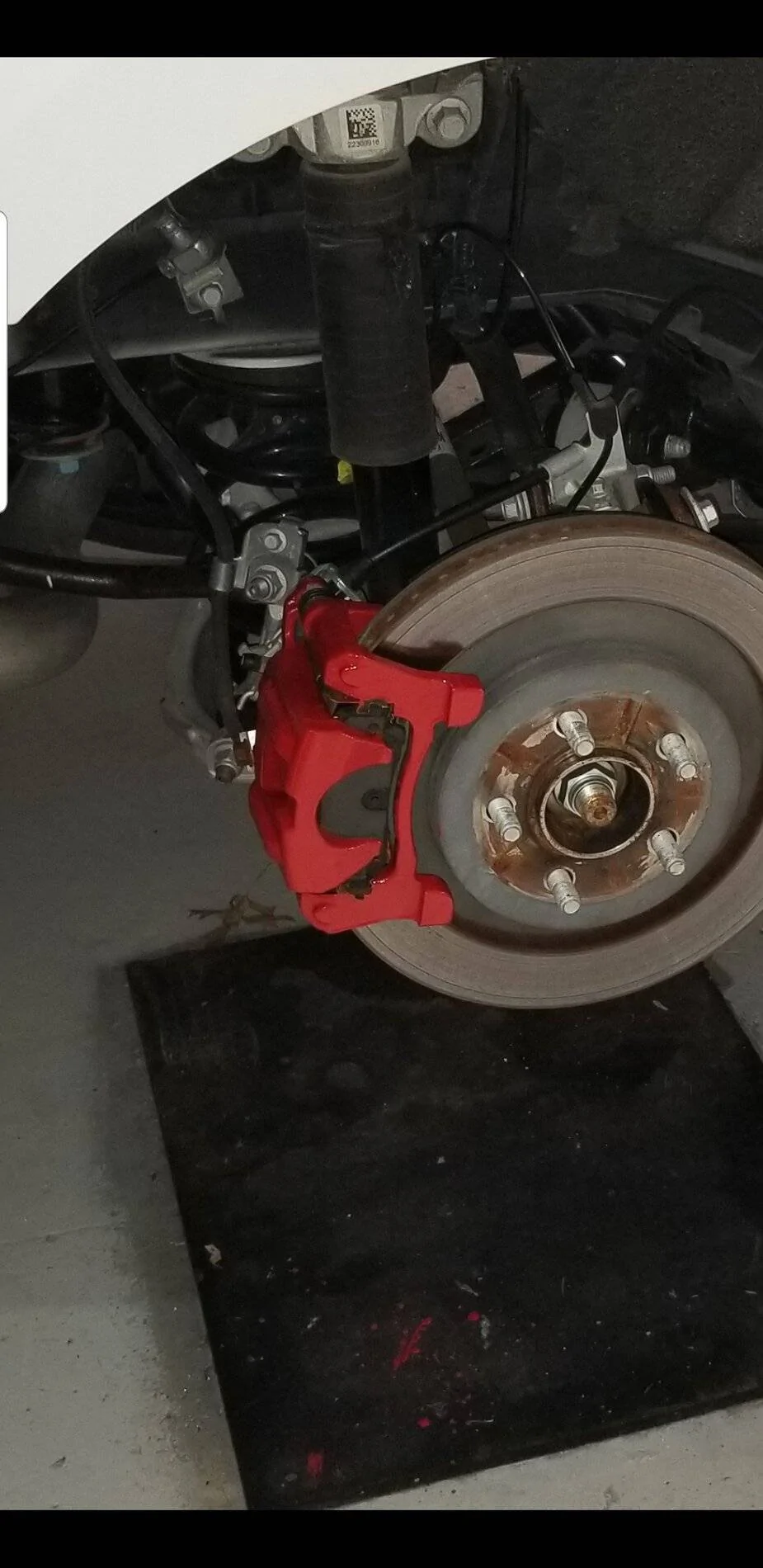

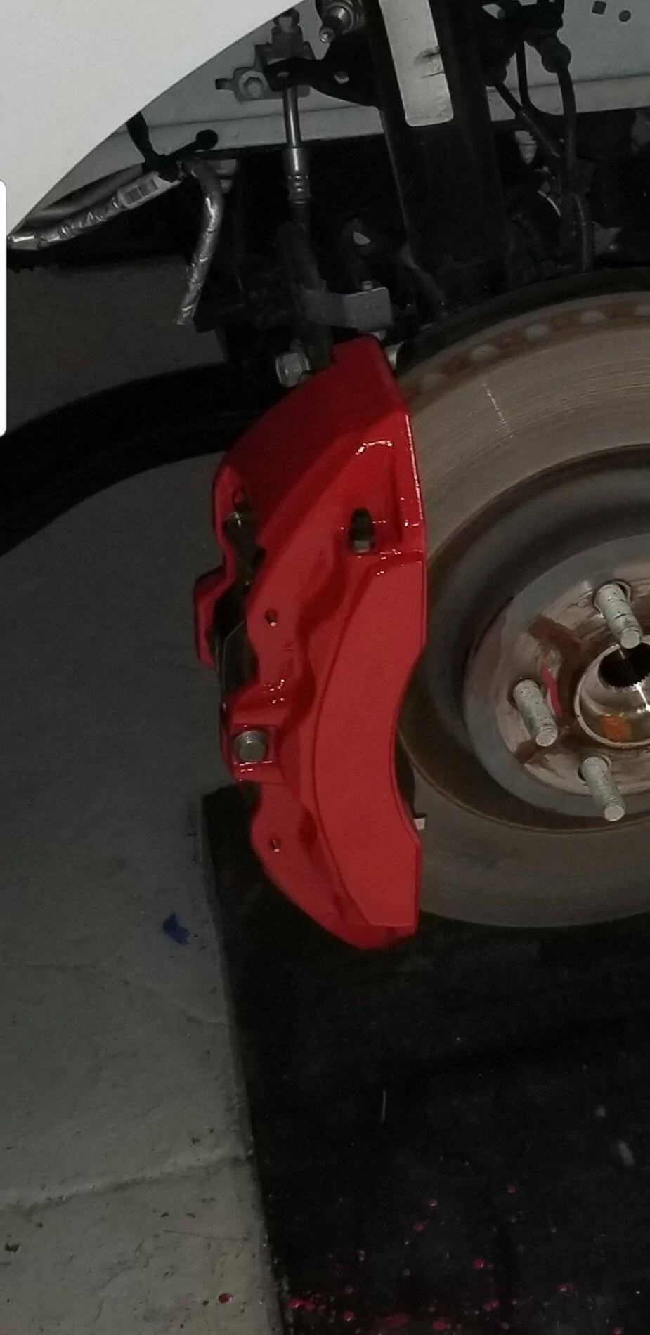

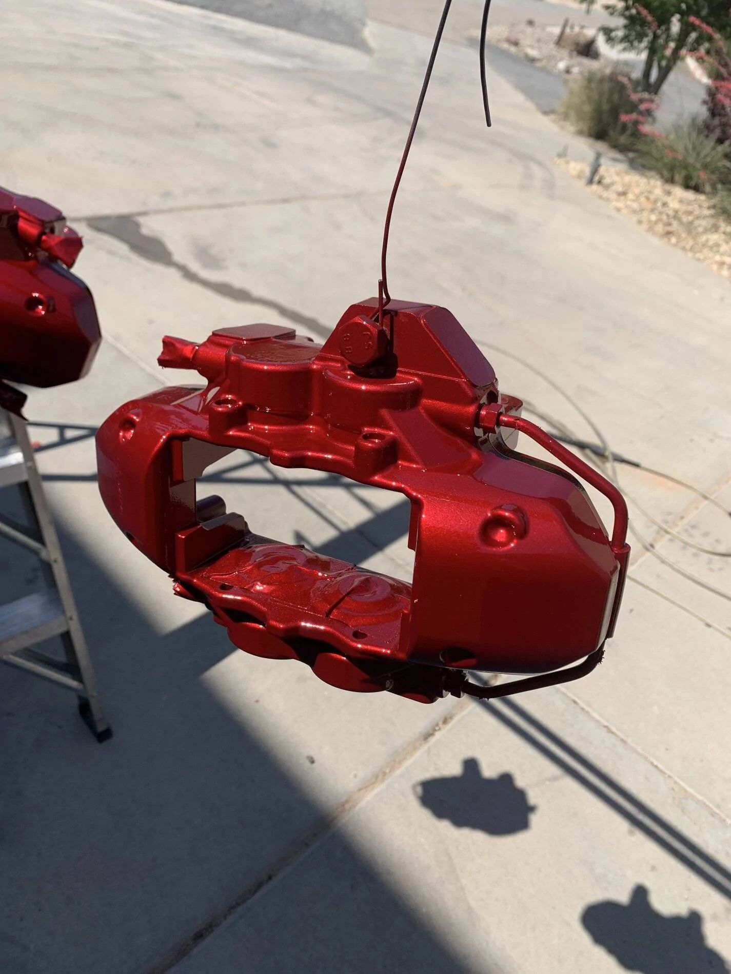

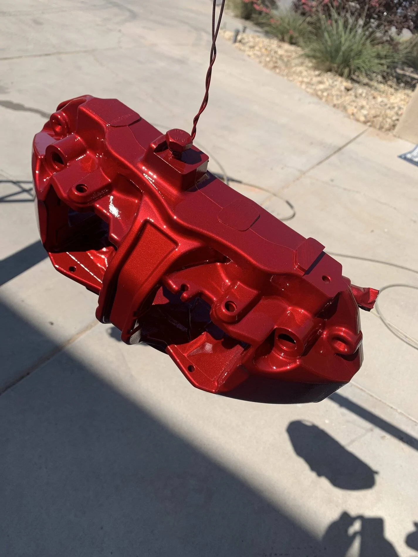

I've done a couple sets myself. They came out great IMO as well as other people's 2 cents. G2 and some diligence. The powder coating thing sounds great but I don't like taking things apart until need be and it's costy for a part of the car that gets grimy daily.
Here's my examples.... $50 bucks, a few hours, and get back to living.

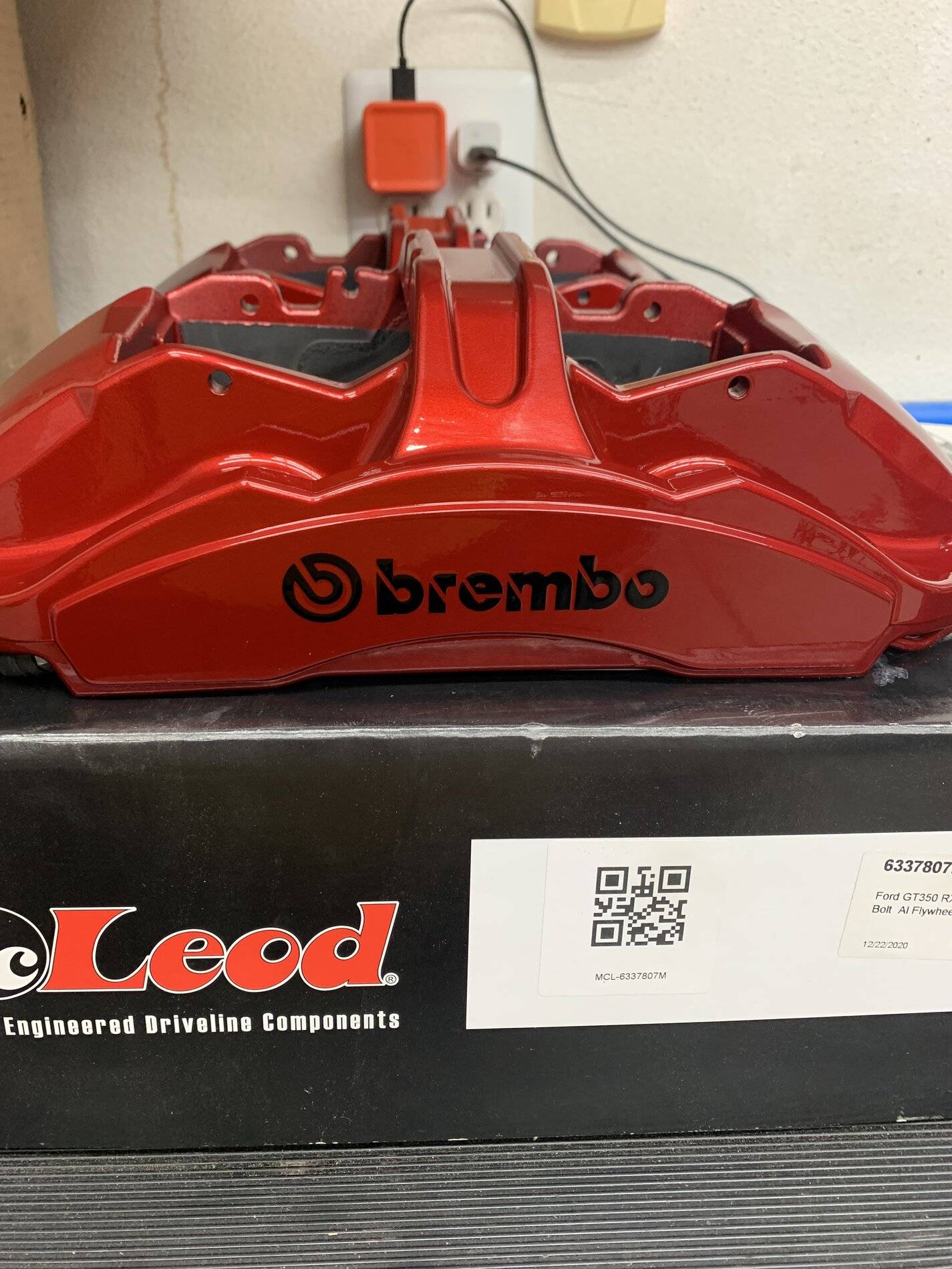

Define proper. IIRC Brembo only paints. Cosmetically pleasing powder-coating is not as heat tolerant. Around 400f. Paint in 4 digits. People have to use 600f fluid and rotors can get to 4 digits on track. Between radiation and conduction, calipers can get pretty hot. For street, powder-coating is fine. Same for most drivers and most tracks. Certainly good enough for me and my car but I went with G2 paint so people like me wouldn't laugh at me behind my back for my proof of slowness. ;)
