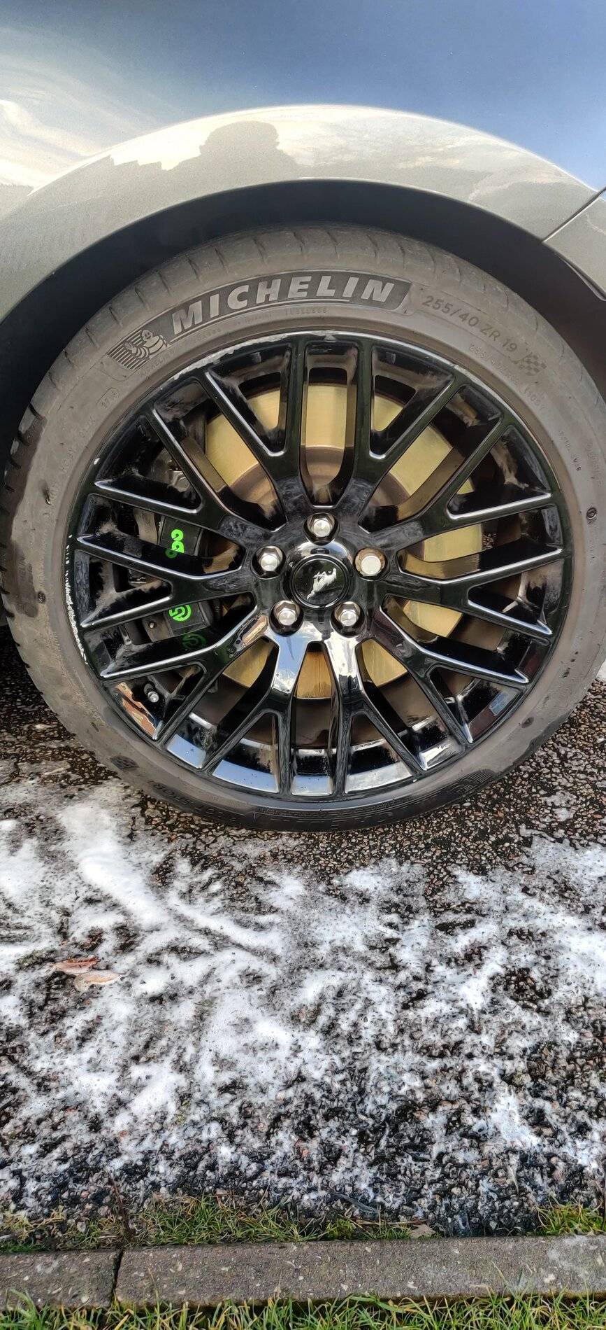

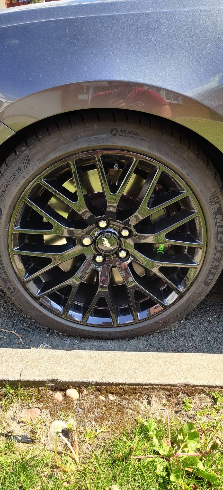

i did my wheels myself after a spree of kerbing, i ended up grinding down the jagged rash of the wheel so it was smooth then used a black gloss wheel touch up paint (pot with a brush) to finish it, did two coats over the pure aluminium and you cant tell unless i pointed it out to you, the worst wheel was the front passenger side i practically had to grind down the whole circumference of the wheel to restore it. it's not perfect but looks a lot better than the pure silver sticking out. i'm quite pleased with the results.
i'd like to do the stone chips myself too but i'd like some guidance on that one.
this was the before
after DIY touch up

vast improvement @Chappers ! How did you find the gloss black matched the oem paint? I've got the perfectionist curse, so I'd want to make sure I got a 100% paint colour match.
Did you do any more sanding after the paint went on to smooth it out?
Chappers
Sep 11, 2017
594
183
Sutton Coldfield, UK
Greg
Toyota Supra MkV - Tungsten Silver
Hey it was a perfect match, to be honest the paint was recommended on this forum but cant remember who by now it was a while ago.
no i didnt do any sanding after as knowing me i'd balls it up, so i left it with the brush strokes in, now im making it sound a lot worse than it actually is unless you've got your face in the wheel you dont notice it.
