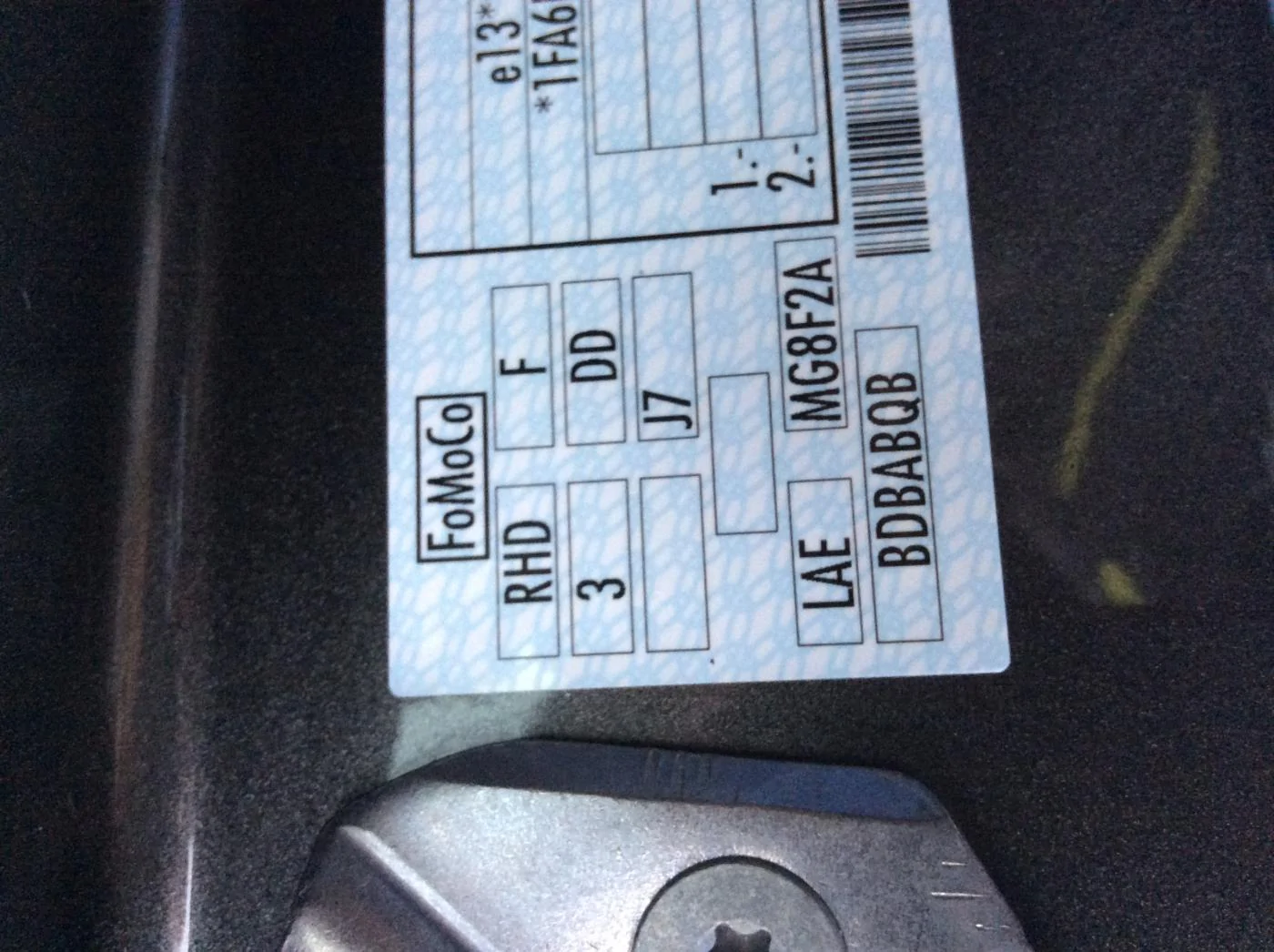

Croyde, search this page using your colour code first, then the make model etc, should be on the inside of your drivers door, eg magnetic is J7 but not listed if you search for mustang colours from the home page. Sorry if I'm teaching grannies! I think the code is CY? And is available, ÂŁ49.95 for small bottle, plenty for me, done about 8-10 chips so far.
http://www.drcolourchip.co.uk/select-color
