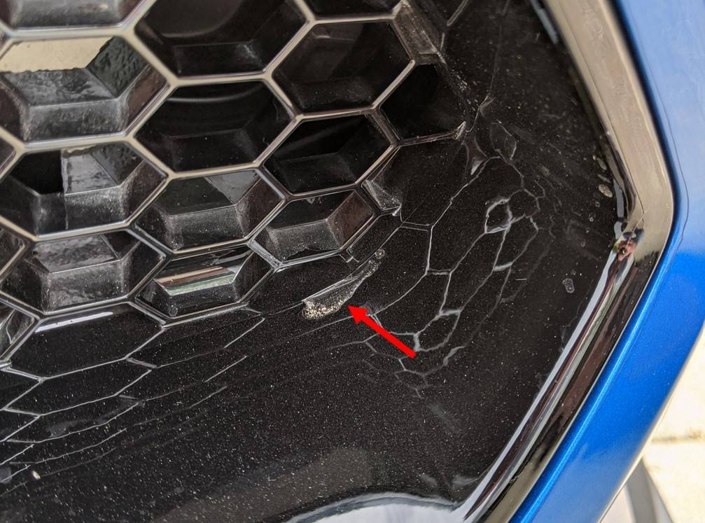

Three weeks ago, I had the full front end and the black trunk panel of my 2021 Mustang wrapped in Xpel ppf. On the grill piece, there is a section that is not stuck down and now dirt is collecting under the film. There are also a couple other spots where there is dust or lint underneath the ppf on the grill. The main bubble is shown in the picture.

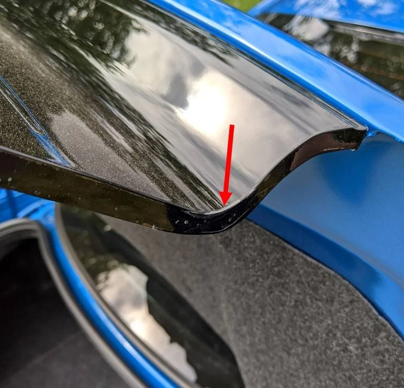

I also noticed that there is a large bubble near the edge of the trunk panel and the area where the film wraps around the side of the panel near the tail lights has dust underneath and is not staying down very well.

This is my first experience with paint protection film so my questions is, is this normal or should I ask the installer to redo those panels?
To me, the two areas in the pictures do not look very good and make me think the film was not installed well. I just wouldn't want to make a big deal out of it if this is what I should have expected when getting ppf on my car.

If your application was warranted by the Installer, definitely take it back, because the peeling will only get worse over time. Plus it’s already collecting dirt/road debris under it, that’s not going to clear up by itself or even with a car wash.

I had a few issues like that when I had mine done. The installer told me to bring it back if I noticed anything and they went over the whole car and fixed even the smallest of bubbles. Its not uncommon for there to be a couple of issues but the end result should be 99.999% perfect. I would contact the installer and give them a chance to fix everything. If they dont, and I assume you used an Xpel authorized shop, I would contact Xpel.

First off, it is known that clear film does not stick down onto the gloss black plastic panels very well. It is almost like two charged dielectric materials repelling each other. So you should lower your expectations at those locations. When I learned this with my 2016 car, I just had them apply ceramic to these panels on my 2019 car (rear trunk fascia and taillights and front grilles). I am very careful and gentle when cleaning these areas and so far I don't have swirls from washing.
Second, it is not a good idea to try to get clear film to wrap around and underneath the fenders (and other areas) too much. That is a harsh environment there. If the film peels back it is sure to get moisture and dirt under the lifted edge and things will get worse.
If you wait too long (even just a day or two), the film cannot be made to stick down any further. This includes peel-backs and bubbles. Even so, go back to your installer and see what they can do. They have all the tricks and techniques. In some case they can do something with the current film. In other cases they may replace a piece completely.

Once it lifts it's done, the adhesive is contaminated. Talk to the installer, xpel warranty covers lifting.
