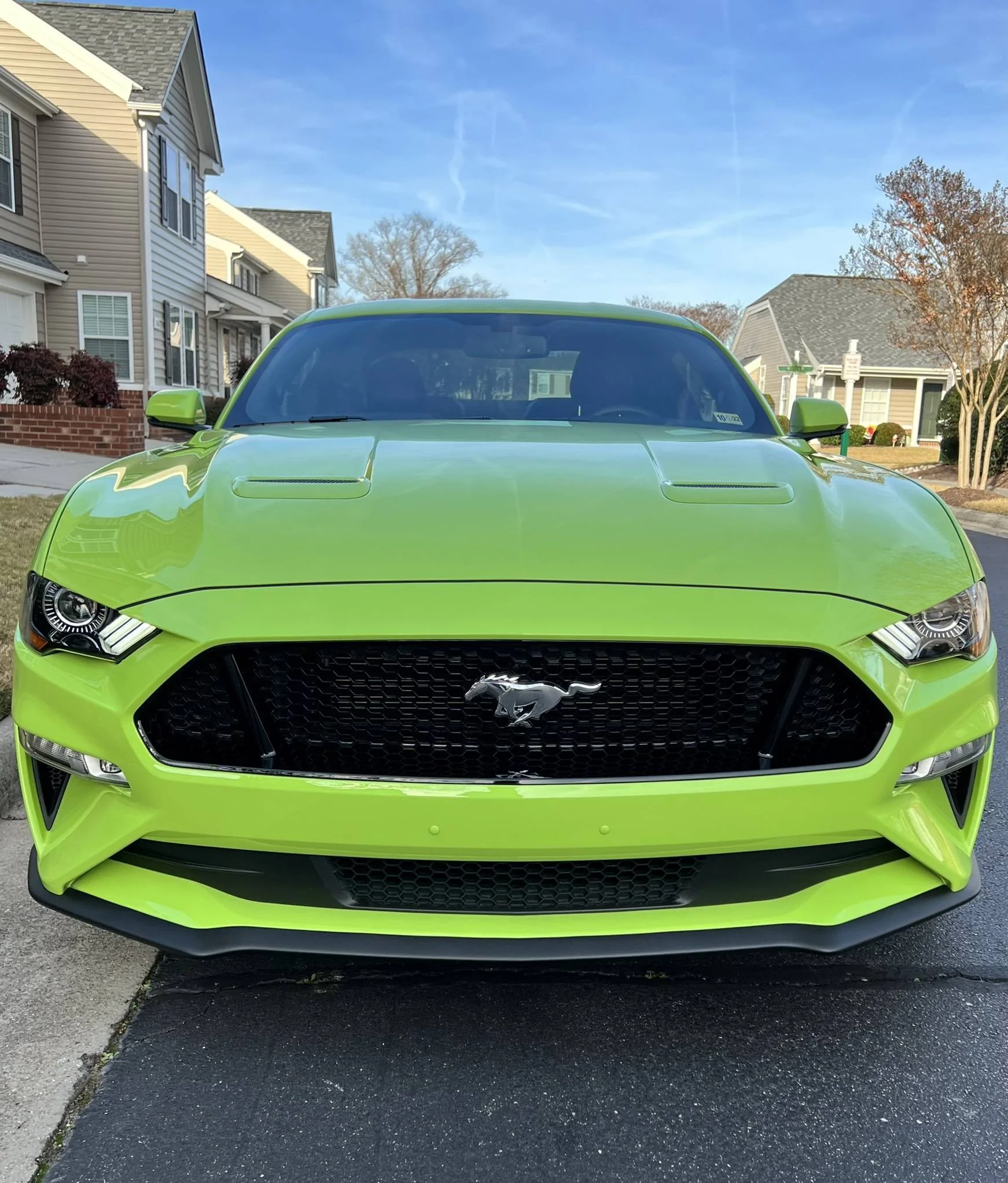

I've had my hood, all the front fascia, fenders and the leading edge of the roof. No regrets but make sure you inspect the workmanship before you sign-off on the work: no bubles, no small pebbles trapped between the material and surface of the car. Good luck with whatever you choose.
I need to get the leading edge of the roof done. Noticed quite a but of bug strikes there from last night trip.
For the OP, everything except the roof is protected in this photo. By adding the leading edge of the roof visible here, it will all be protected Almost 6k miles and front is still flawless Added the Rokblokz too
Do the “A” pillars as well. It’s one piece with the front of the roof. I’ve taken a couple of hits there and the PPF did it’s job.
