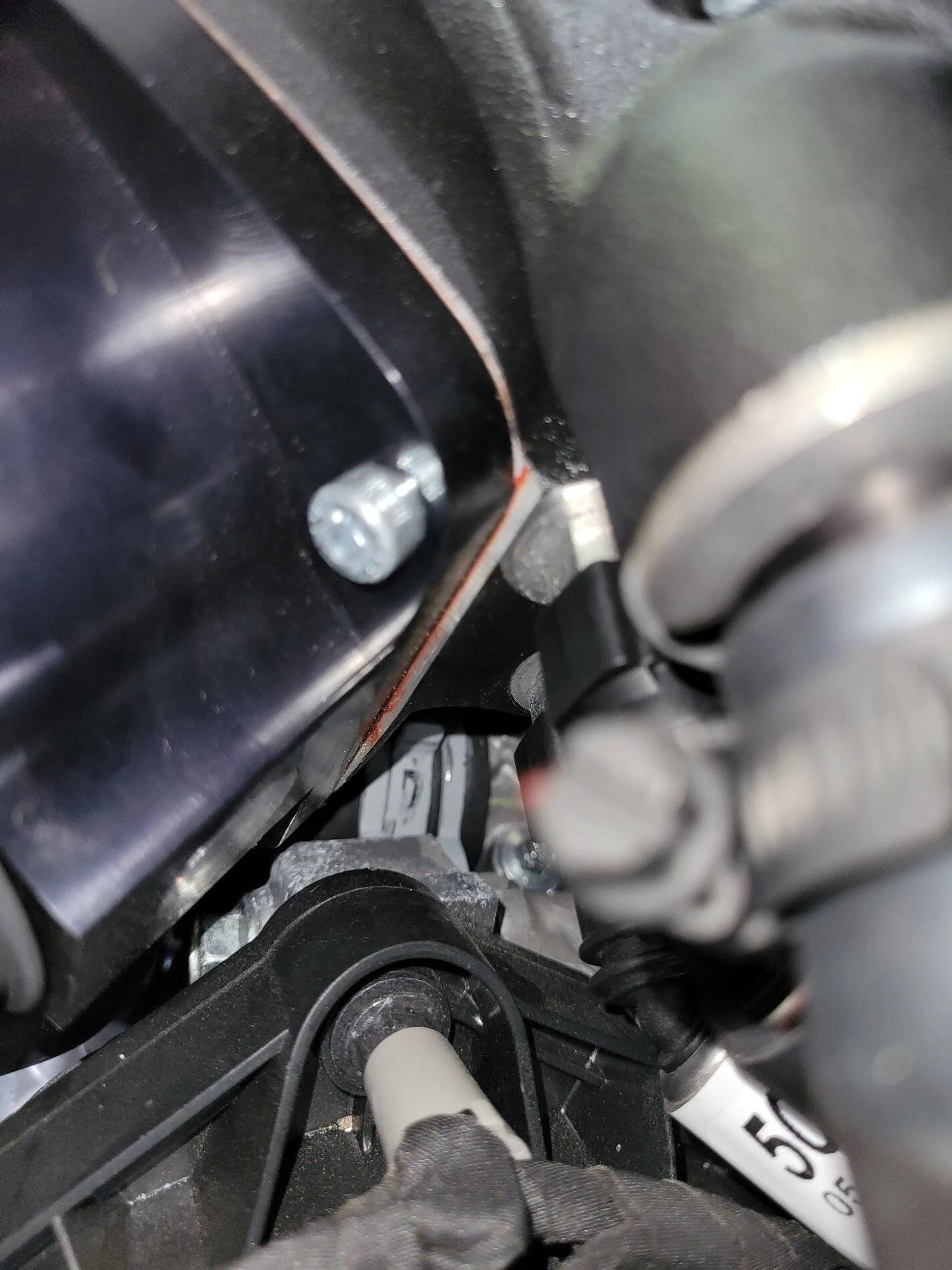

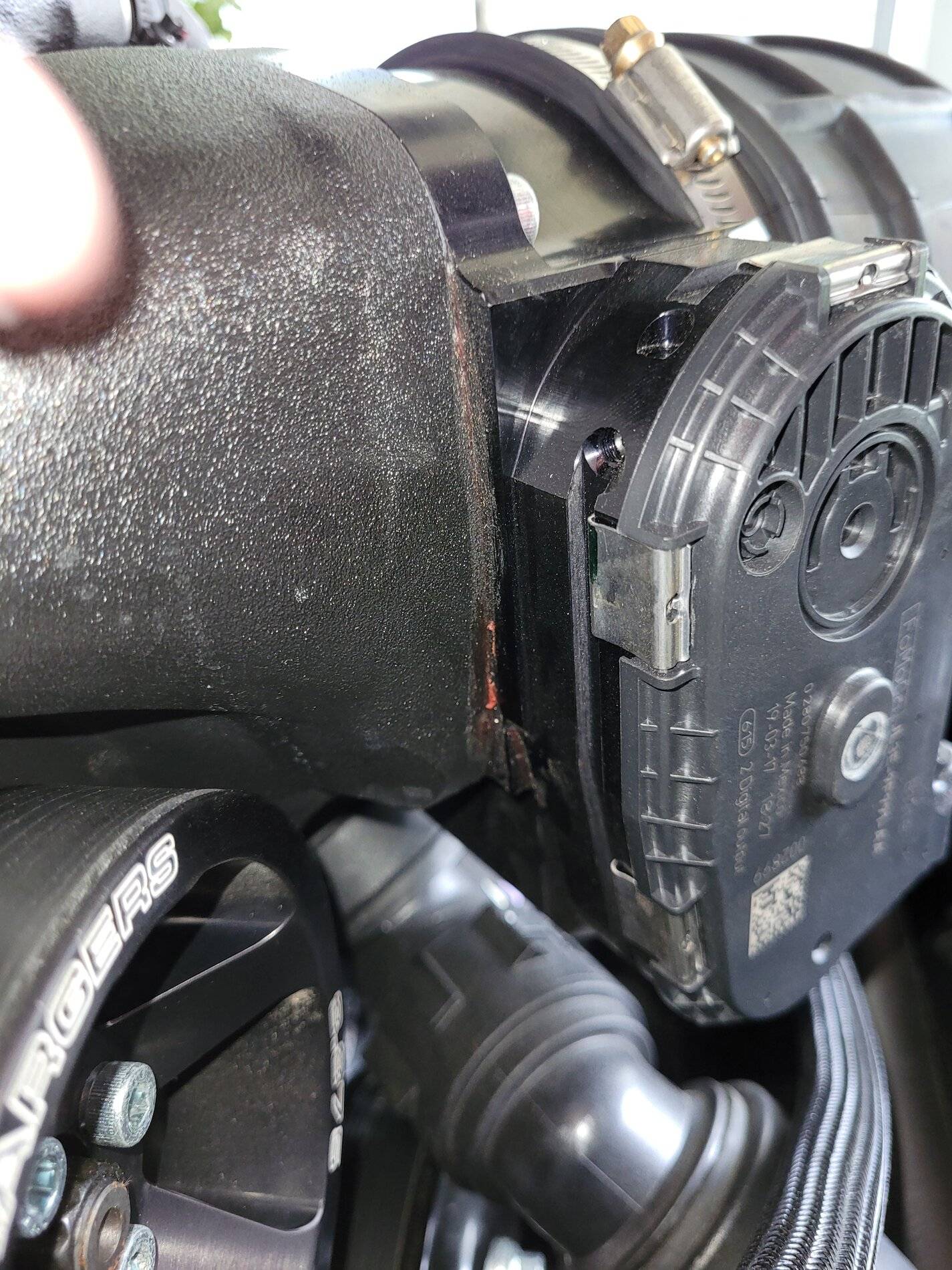

Been getting a p2119 with my whipple stage 2 when I'm WOT sometimes and sending the car into limp mode. Did some research and seems a common problem is the gasket in throttle body. I had a outside dealership do the install and can see they already replaced rubber gasket with rtv but I can't tell if it looks properly aligned or not because on driver side it does not sit flush. Just wondering if anyone else that has done the install can yell me if it looks installed correctly or not.

Looks good to me and there really isn't wiggle room with bolt holes as far as moving it around.
If I remember right, one member had to adjust the TB blade to solve his issue.
