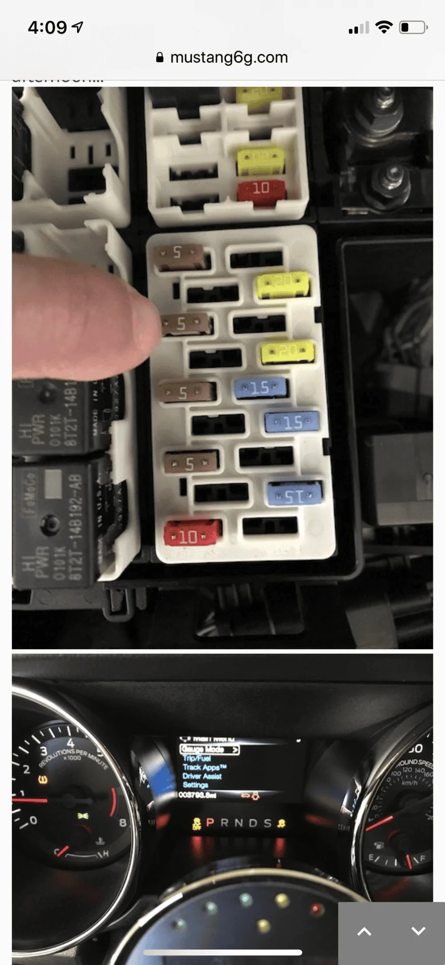

Try this ! Then drive it for 15 min normally, then give it the beans it will most likely show a steering light on the dash for warning , when that happens put the fuse back in while still running. See if this remedies the issue CHEERS

What fuse is this for and what does it do? Were you having the same problem and this resolved it? Thanks for the idea - toss me a little more info if you have time. Thanks!
Yes I had a similar problem, and it did fix it , it’s the fuse you pull for dyno tuning , can’t remember the number tho

Ok I'll give that a shot too. Thanks!

Fuse 62 pulled disables stability/traction and abs

How would that fix a throttlebody performance issue?

I'm not sure but i wonder if that's the same effect as unplugging the dyno plug that's on the drivers fender where the air box used to be? I think that's where my intercooler fuse tap is on mine too but I'm out of town with family.

Its probably not a tb wiring issue.With some tunes their is still quite a bit of torque management and traction on.Even with advance trac off with a hard launch the torque management can close the throttle for a spit second making guys think they have a tb or tune issue.My manual car did this until i had my tuner tune enough of the torque management out.

True that just turning advanced track off inside the car will not completely disable it. Pulling fuse 62 or disconnecting the pigtail connector above the airbox will.

I definitely don't want to lose abs or stability control all the time - but if doing it once would fix it I'd do it. I keep thinking tune, but Lund is saying it's mechanical. Working with Will at whipple to see what he thinks of the throttle body I sent back to him but if it was that part, it seems like it wouldn't still be doing it with the new one installed.
I feel like something in the torque management table is the culprit - why would it only do it under wot in low gears is what I think. But I'm at the mercy of what they're telling me. I just hope to get it resolved.
