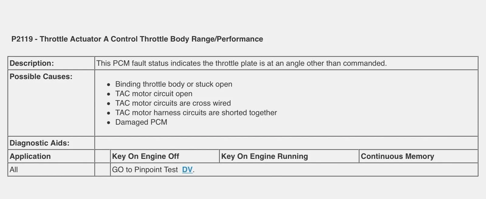

Here ya go P2119 DTC info and diagnostic pdf.

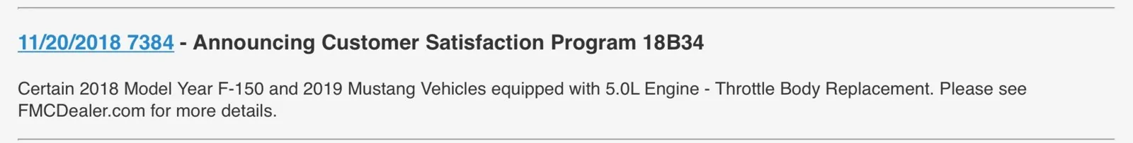

Also, someone needs to dig up more info on the latest Customer Satisfaction Program #7384 that just recently surfaced.... (see below):
