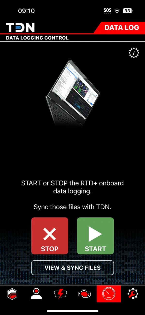

I have HP Tuners and I know it has that capability but I'm not sure how to do that.
Go to this icon on the app and follow instructions. Massively easy. You can’t break anything so don’t worry 😉
Thank you! So I just drive around like normal? Sorry for the stupid questions I've just never done this before.
Yep. Drive around like normal. The only time you would not, is if your tuner told you to do something specific, in a certain gear.
but do this….
Start data log up (hopefully at a stop light) and try to go through gears at least up to 5th.
I wouldn’t burn the tires, but I’d try and be a tad aggressive so your tuner can see what’s going on when you send the log.
got it?
