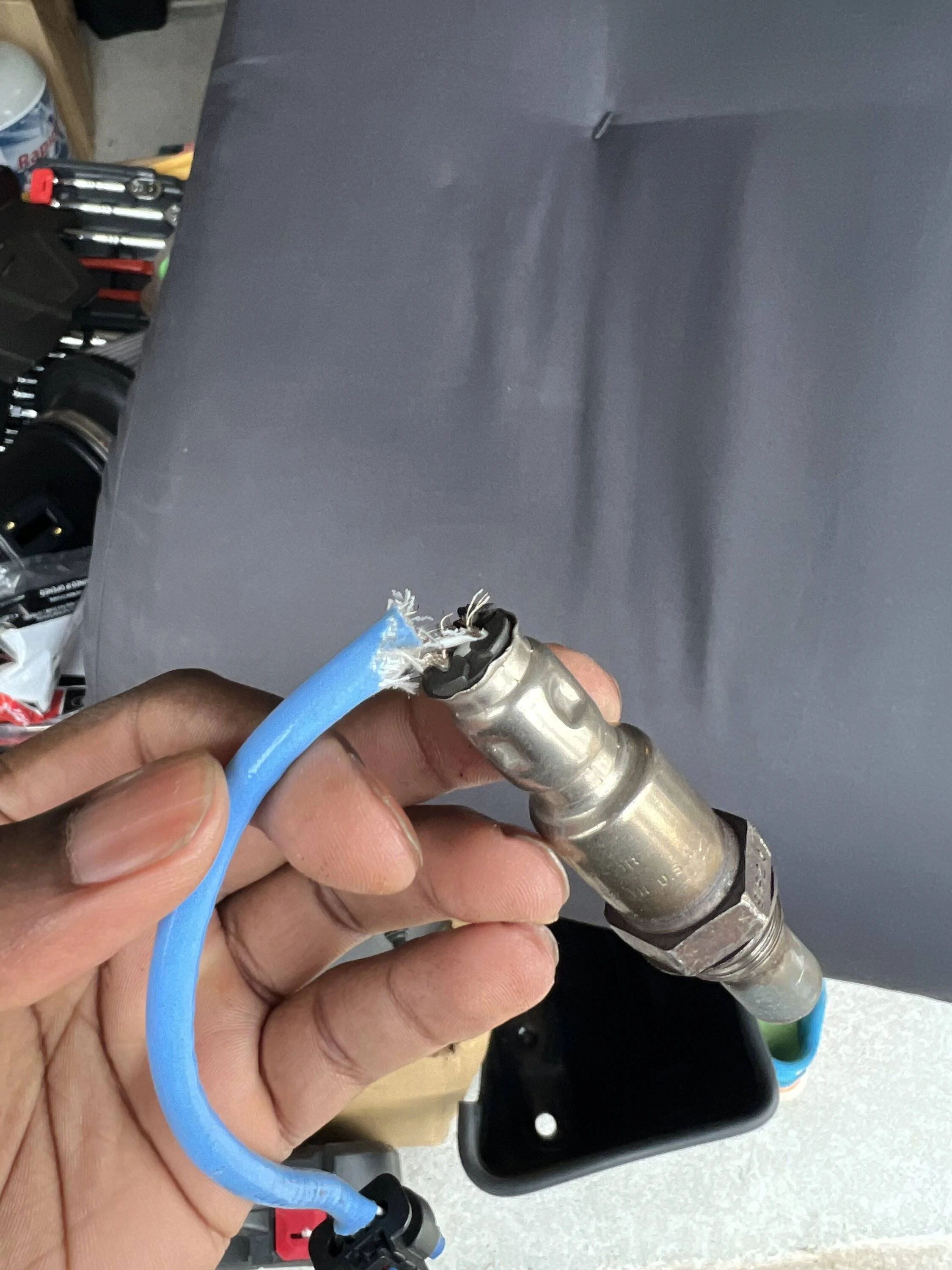

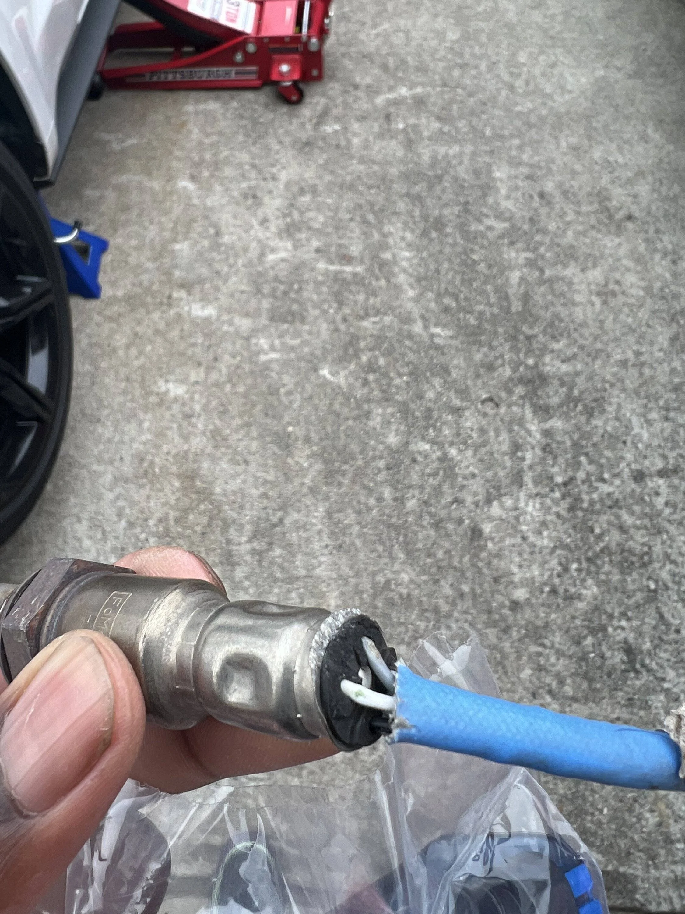

Well when I got the code, mine looked like this but again. It was because I had long tube headers and the system thinks the hi flow cats aren’t working efficiently. I got the same code a second time due to the sensors sitting too low and getting damaged.

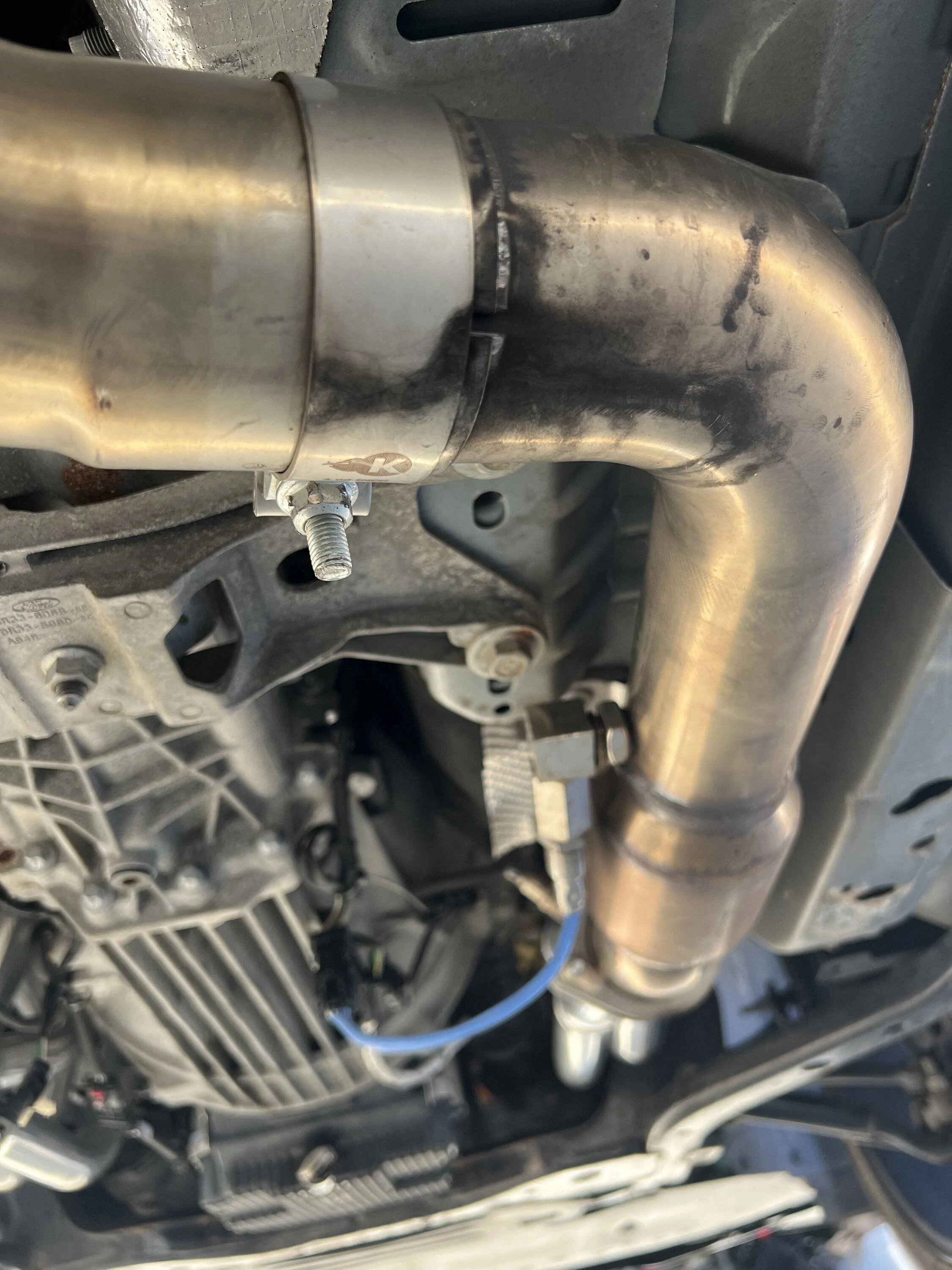

You more than likely don’t have the same issue so yeah I agree with the others and take it back to the dealership. You can check for exhaust leaks before you bring it to the dealership unless they are the ones who installed it. Don’t want to pay $180 just for a simple fix if it is as simple as tightening a bolt. Exhaust leaks usually have black residue around the area. This was mine when I had a leak due to a loose clamp
