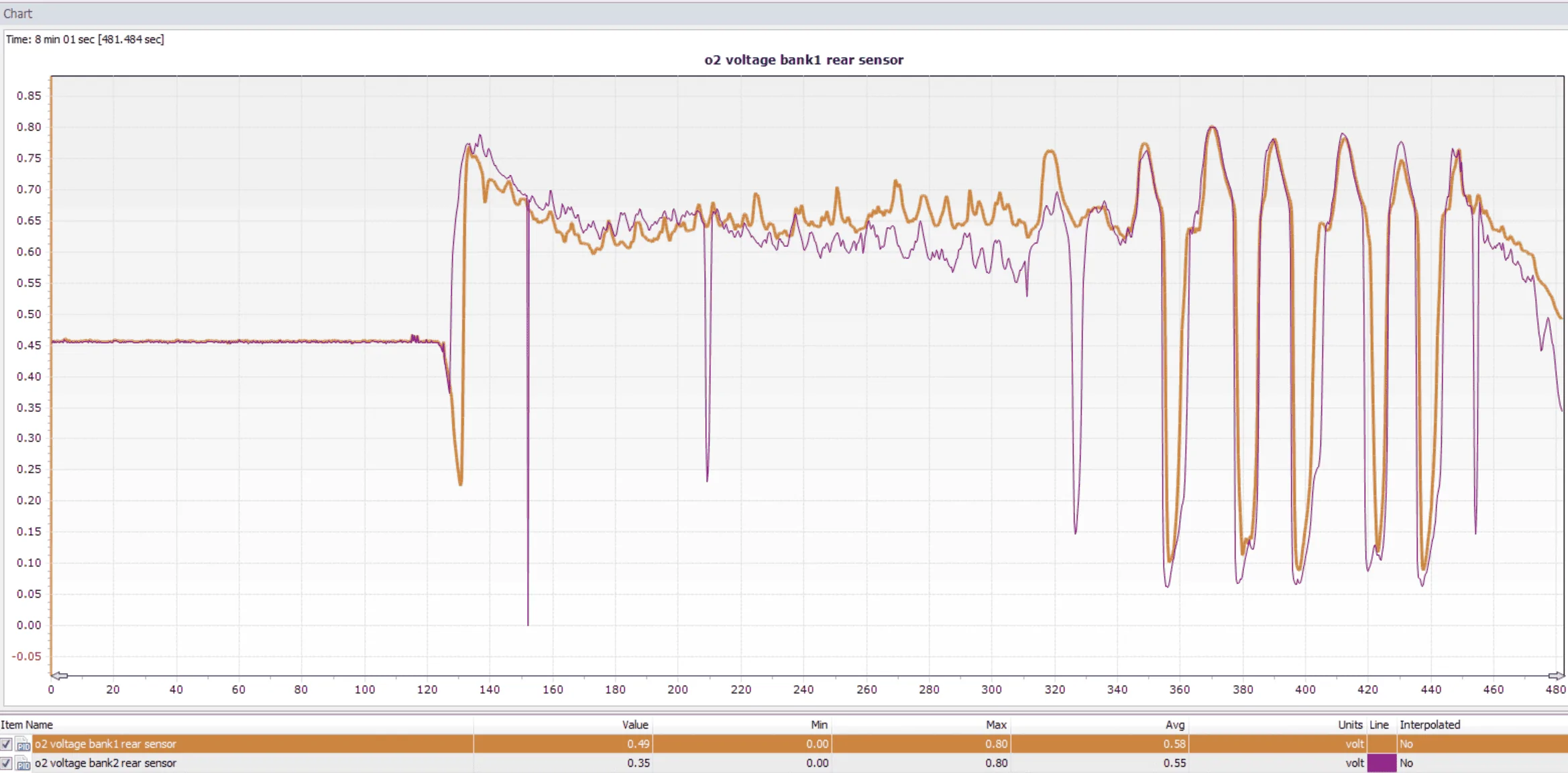

P0430 Code Procharged w/stock cats
pmor4243
pmor4243
Sep 10, 2021
193
88
Utah
Parker
2019 Mustang GT
8 min of idle looking at the rear o2 voltage:

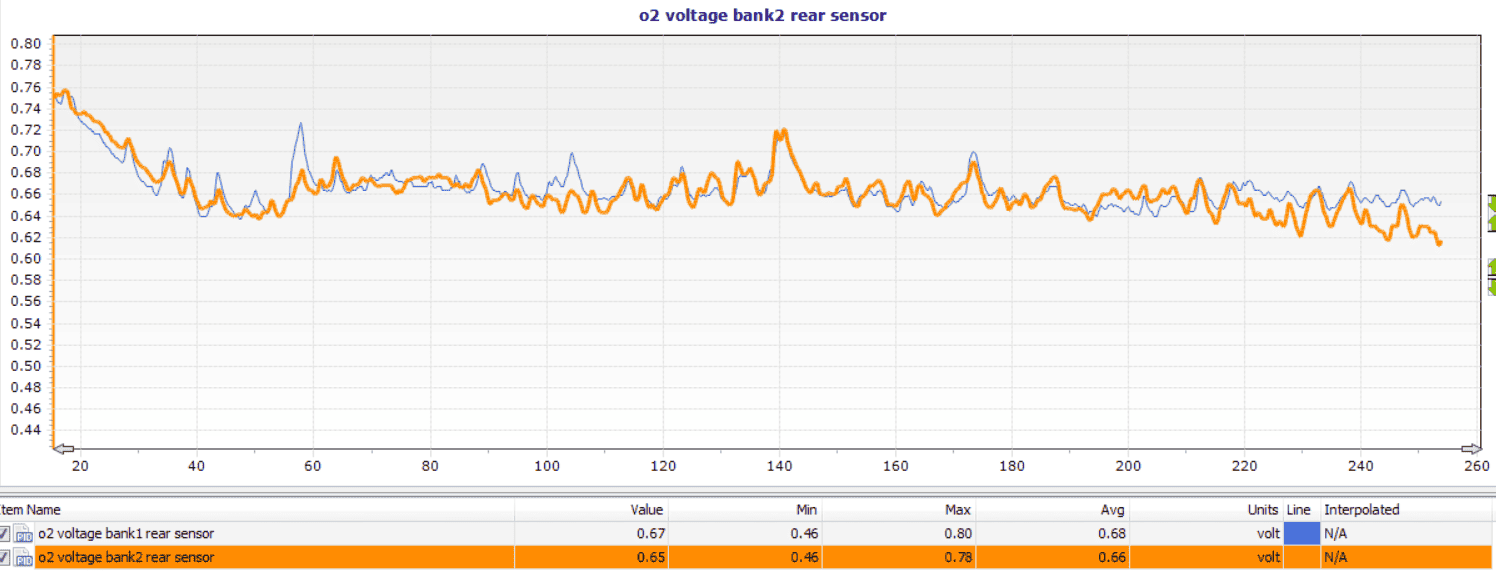

And another 4min idle, it seems like I get different results each time I do this so I don't know what normal is supposed to look like:

Do a log with widebands and narrowbands. It goes through a cat test cycle where the widebands cycle up and down rapidly and inversely to one another. That’s when you should check the rear voltages. If they cycle like the widebands then the cats are shot.
