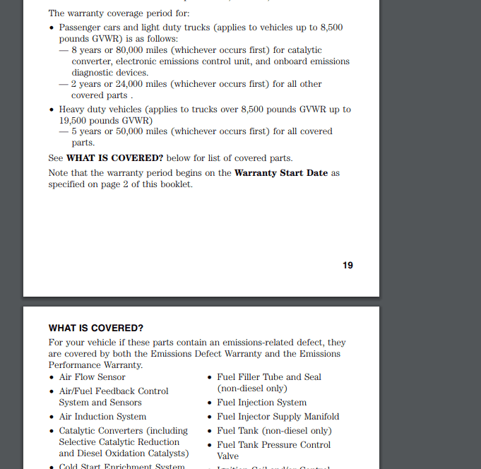

Cats are covered..Ive been through several and if you are out of base warranty their is a separate Federally mandated warranty that Ford has on their cars. Here is from the Ford owner manual for my 2019.

Roush fought it with the dealership..Ford pointed the finger at Roush and Roush pointed the finger at Ford. Once i showed the service writer this in the owners manual and I said I just wanted it fixed it got fixed. Took me about a month of dicking around. Been through two sets in the past 7500 miles. Code has to be active when you bring in the car to have scanned. I have a few friends with Whipples that have blown theirs out as well. They were covered under warranty. I guess it could be in how the claim was filed as well. I just went catless a few weeks ago when I had an IC Chiller installed along with a Wengerd Dyno tune. You have nothing to lose by giving it a shot. Dont get into boost with a plugged up cat or you will have other bigger problems.

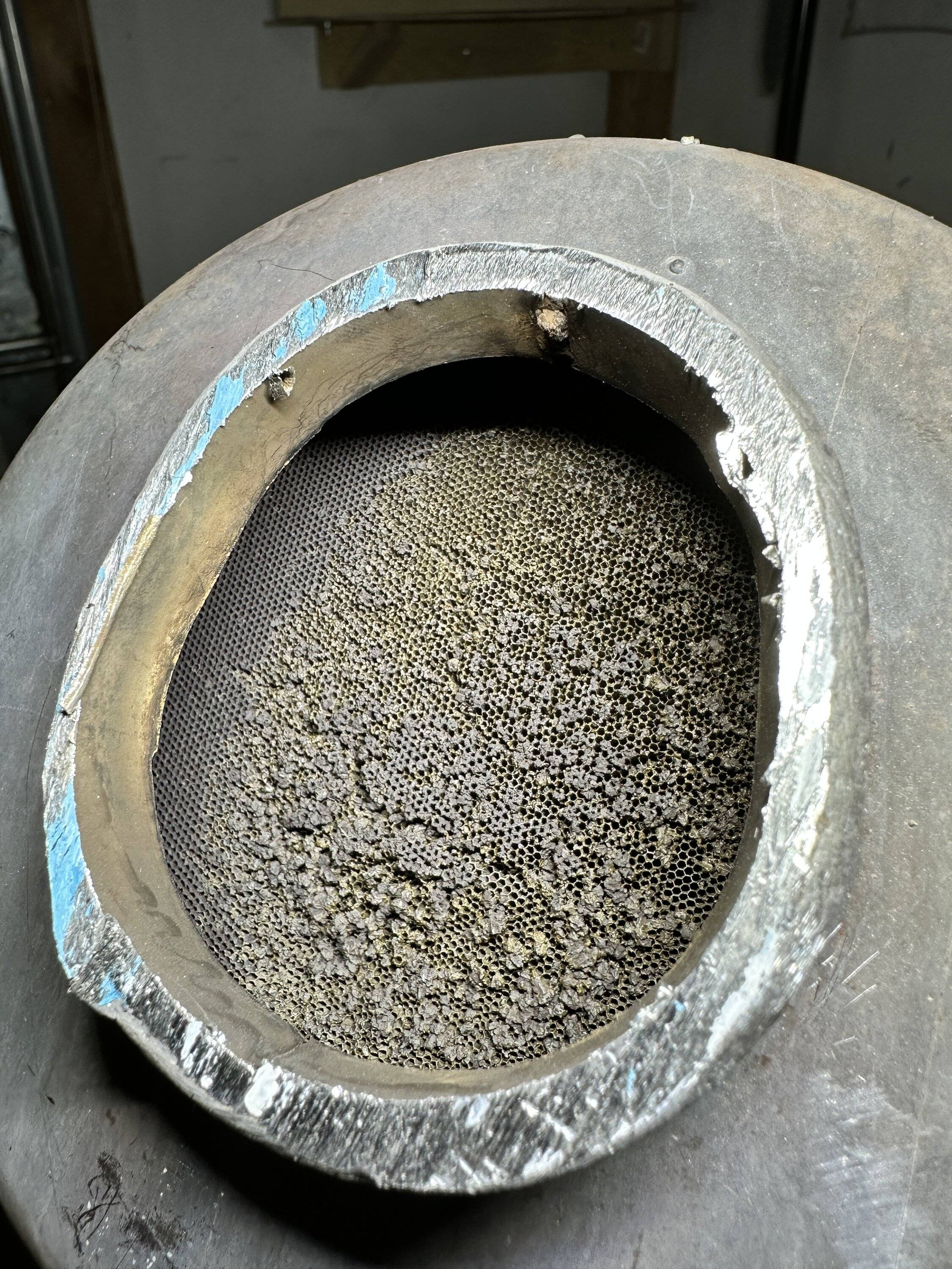

Figured I would toss a little update in here. Pulled out both cats and put in some 2M delete pipes at the moment. Also ordered another set of OEM cats I found from a seller on ebay that went with Long tubes. My intent is to have an easily swappable solution moving forward.
I'm not an expert with this stuff - the cat doesnt looks horrible (Ive seen far worse examples from others on here) but there is no question that it has taken some damage. What's interesting is that this was enough to trigger a cat efficiency code with the supercharger, but no code stock.
So at least in my case, I may have been lucky they gave me an early warning sign that they were failing Prior to getting misfire codes. I did however notice a lot of knock on a pull right around when my code came up, so maybe there is some internal cat damage that was causing this thing to rattle a lot and induce knock, at least I hope thats what happened.
The passenger side looked better but not by much.

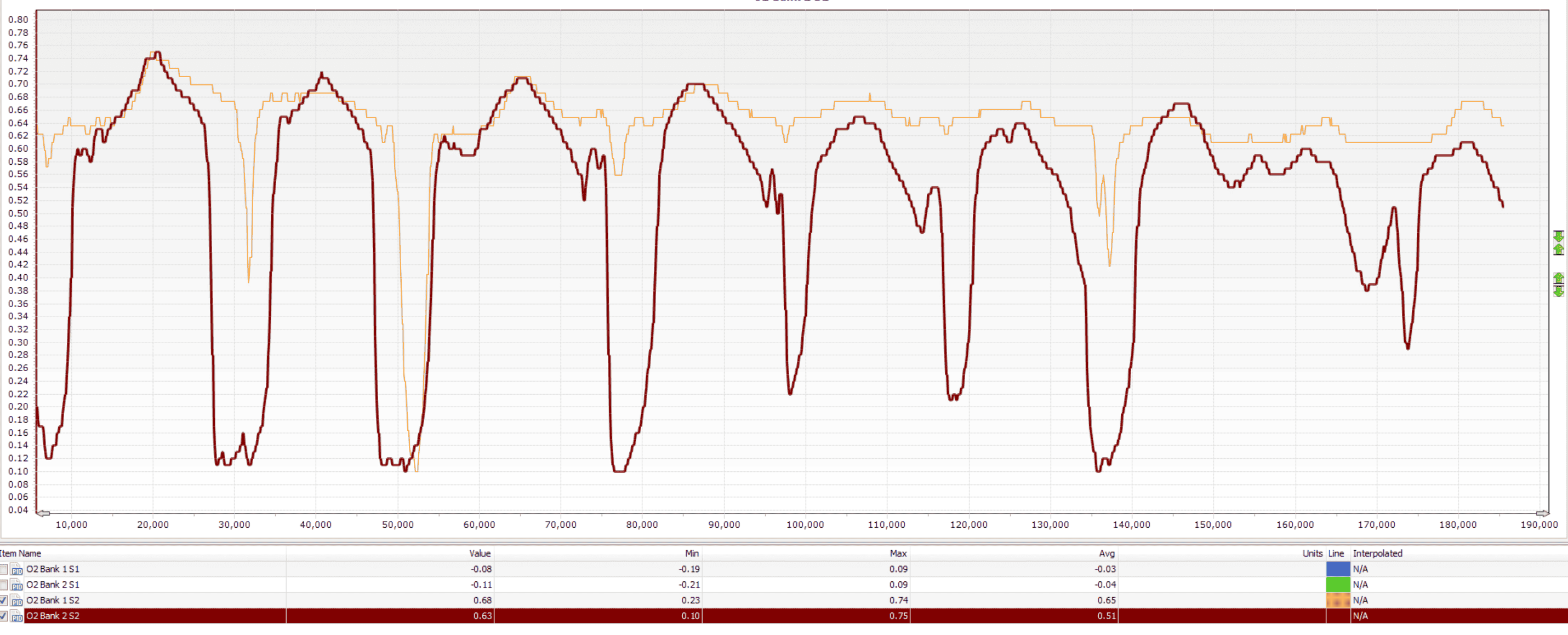

Alright, got a set of OEM cats from ebay, that were supposedly pulled off for long tubes at about 10k miles. It seems my o2 and cat readiness monitors are not wanting to set so I decided to look at the rear o2 sensor voltages.
This was at idle
Red is Bank 2. It looks like they both have a few fluctuations but Bank 2 consistently drops down to the .15v range. My thought based on this is that it seams that the driver side cat may be bad with the passenger potentially not far behind.
@engineermike I saw a few posts where you had used rear o2 data to identify a bad cat, does this look like what you would expect from a failed cat?
