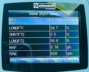

At Idle, LTFT is high on both banks STFT is ok:
Does MAF flow rate look ok for idle? It fluctuates between 3.0 and 3.8, and when I search for what the number should be I get results that are all over the place - between 2 and 5.

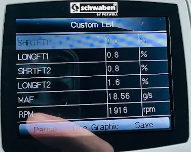

Cruising in gear, things look much better:

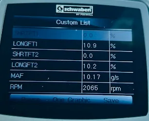

Decelerating in gear is similar to idle, but not nearly as bad:
