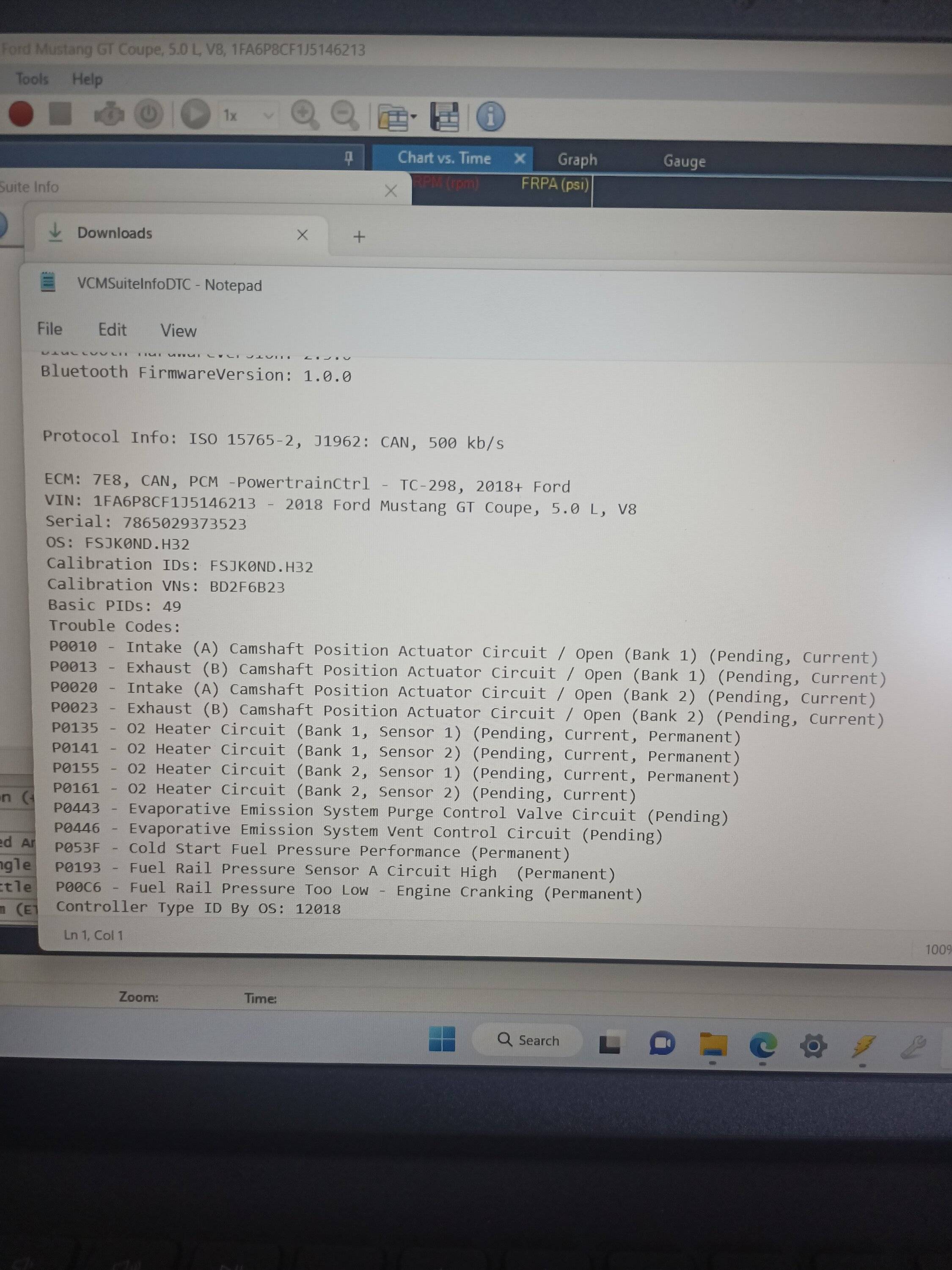

I have a P0193 Fuel Rail Pressure Sensor – Circuit High Input . Looking at my logs Im seeing spikes in my Rail Fuel Pressure to over 4,000 psi. I just bought the car a month ago and it ran ok for a while. Now it wont stay running. I ordered the Driver module, and low and high fuel rail pressure sensors. Ive done a ton of searching here and there but not having found this specific issue. I did a scan today and the fuel rail pressure transducer status: yes error? 4628 psi Fuel rail pressure and Fuel rail pressure desired is 58 psi. I have an 18 Mustang GT PP1. Has Stainless LTH w/ straight pipes to Active valve mufflers, and a JLT intake. Car has recently been tuned. I'm waiting on my service manual should be here today.
Any suggestion or experience and direction would be greatly appreciated.

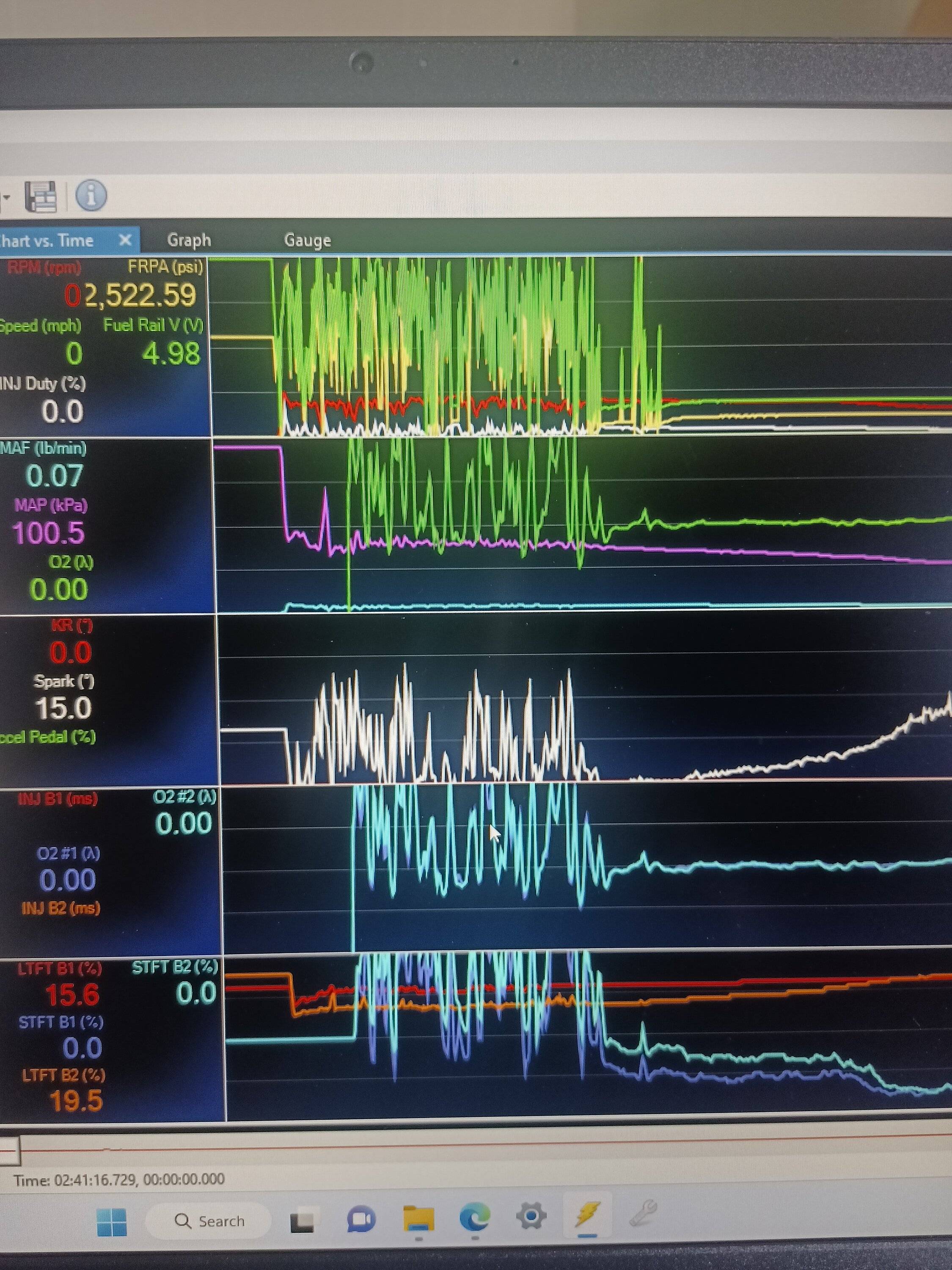

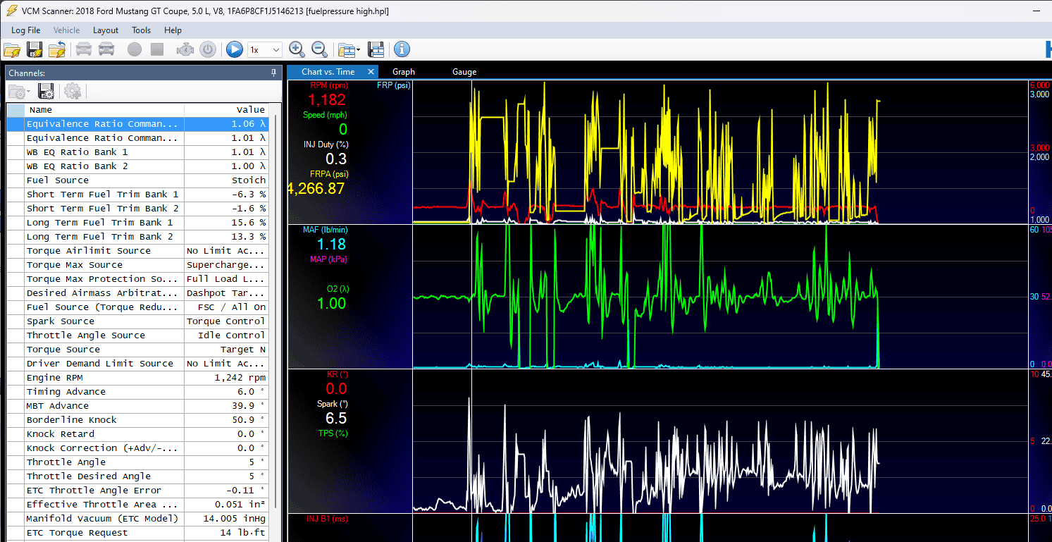

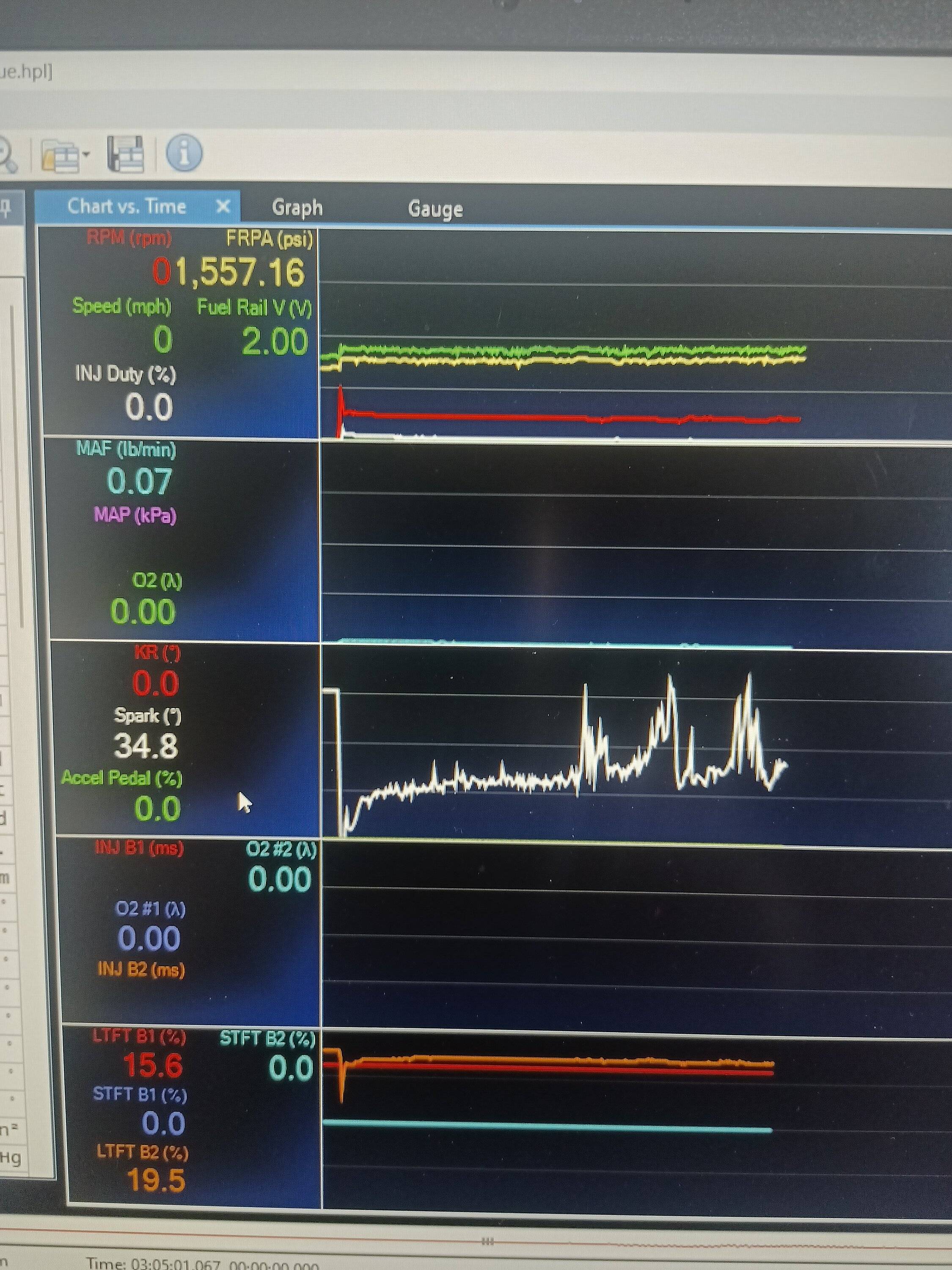

Most of them codes popped up today. The bottom 3 I've had but the others were from today. The spikes in the fuel pressure shouldn't be happening? Shouldn't it raise and lower steadily instead of spiking like that? This set me back even more. dang it. Need to find a known good coyote scan file and see.

The stock tune commands a max of 2900 psi with a limit of 3000. Either the gdi pump is malfunctioning, the tune is needlessly drastically altered, or the signal is bad (sensor or wiring).
You can log gdi pump duty cycle and deg of pumping to give more of a clue.
