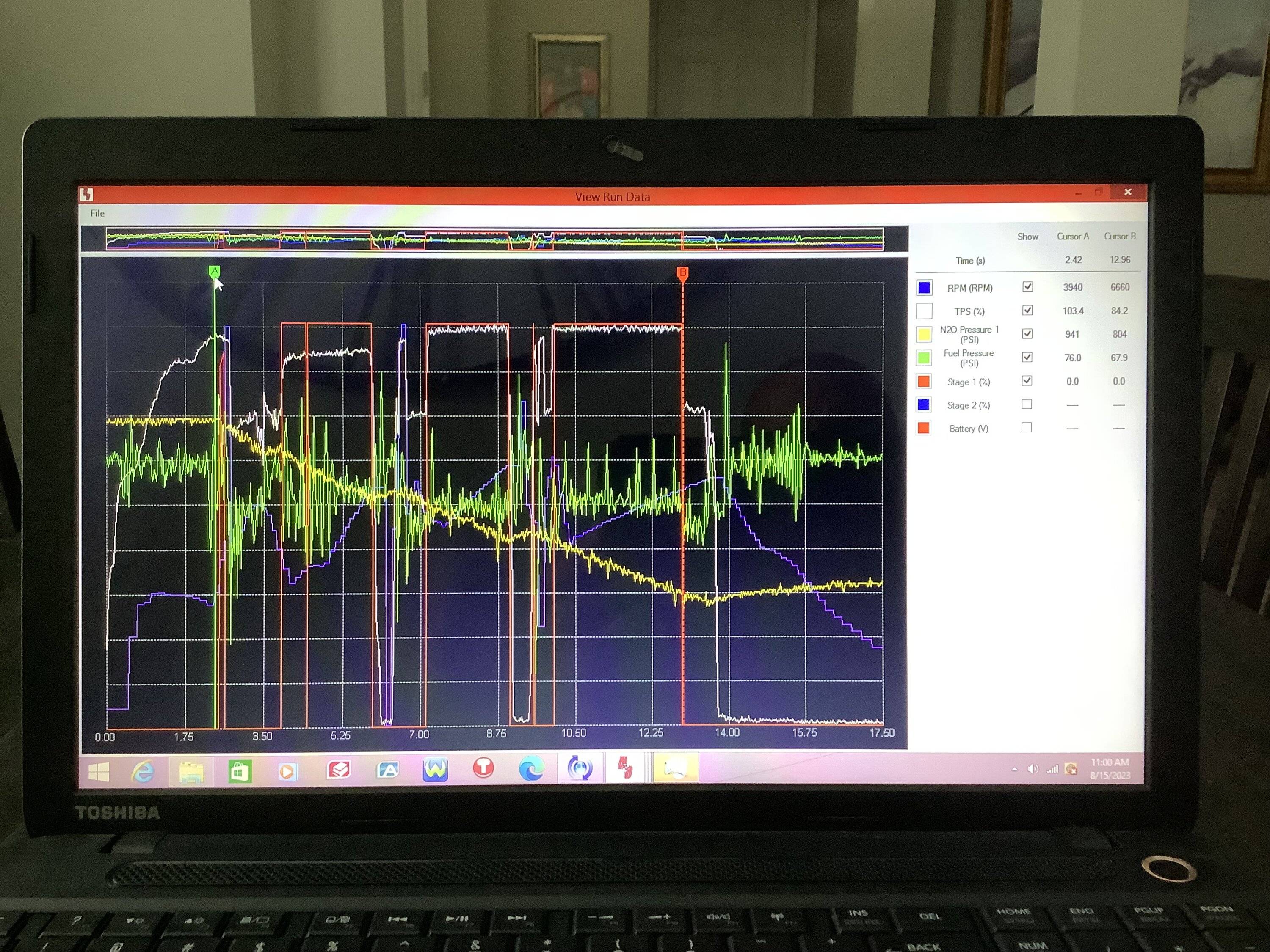

Here’s a little info. from a nitrous data log that I recorded with my DW400 pump and JMS BAP. If you look at the numerical columns to the right, youā€˜ll see the rpm and fuel pressure range.

Here’s a short video that I just recorded in an attempt to determine where I want to set the high and low fuel pressure limits in my progressive nitrous controller. I went WOT just to see what the max. and min. pressures were. The sweep is very fast, so I recommend dragging the video frame by frame and looking at the rpm and fuel pressure to see actual values.

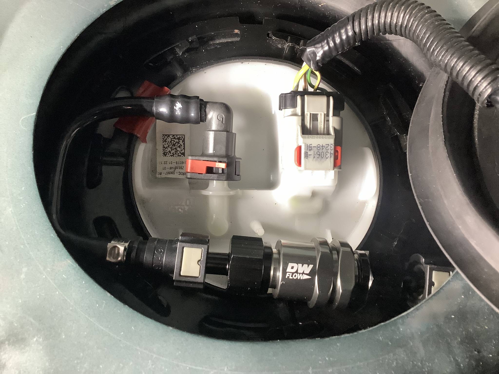

Oh okay, well that leads me to believe it could also be related to the DW400 pump. Do you know if yours has a check valve in it? When I bought my DW400, it came without a check valve. I think I got one of the older versions of the pump that had been sitting on the vender’s shelf. My car was always hard to start afterward. It would start, die, start, die and finally start. I ended up installing a DW check valve in the factory fuel line which fixed that problem.
