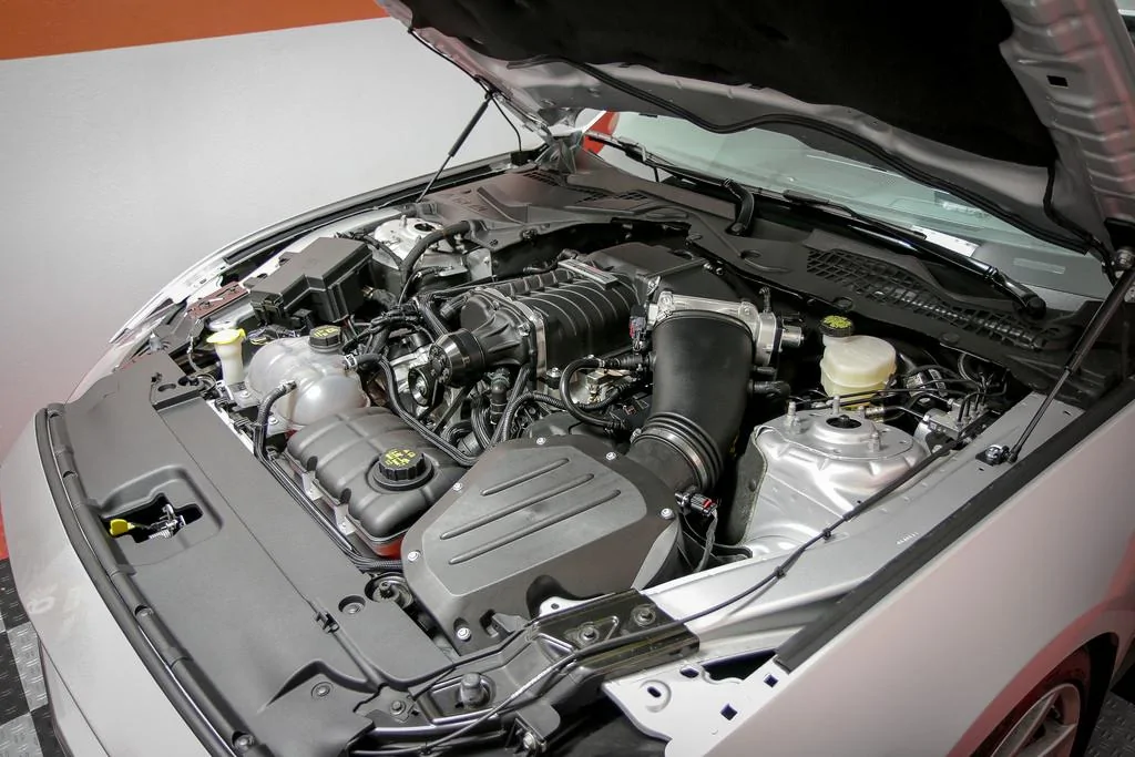

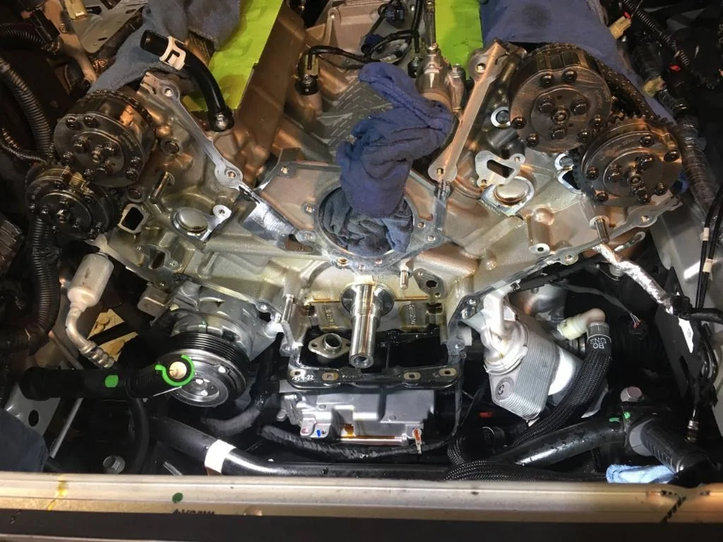

Thank you to everyone who contributed to this thread! Made tackling this install over the weekend very painless.. Pretty much ALL the details are here. 15 hours start to finish for OPG/CS and FP Supercharger kit. Car is running flawlessly and I couldn't be happier.

Congrats man:clap2: and you have done yourself a great service by installing the OPG and blower kit yourself. Now you can rest assured you won't end up like me holding your Dick on the side of the Hwy, mumbling under your breath I can't believe this F'in happen to me:frusty::headbonk:
