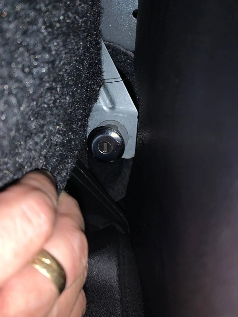

I too have a convertible and today my battery my trip to work was hindered after my 10 day vacation. It puzzled me as I left a higher quality Battery Tender powering the car over the 10 days to keep a charge.
So with the battery dead, I figured, no problem; my high-end emergency battery jumper device was in my trunk (boot for our UK friends :wink:).
Oops! I couldn't get into the trunk. I've helped others with the battery jumper device, but couldn't help myself.
So based on what the OP and other convertible owners learned, I located the switch tightly wedged about 3 inches up from the bottom seat bolster, between the rear seat back (driver's side) and the adjacent plastic quarter panel cover. (thanks to those who led me on the right track).
I suppose the tight quarters were intentional to make access prohibitive for bad folks in a hurry. What a pain! It was difficult to a) access, and b) have sufficient room to rotate the key in the lock.
Anyway, for those wondering what the emergency unlock device looks like...see the pic below.
