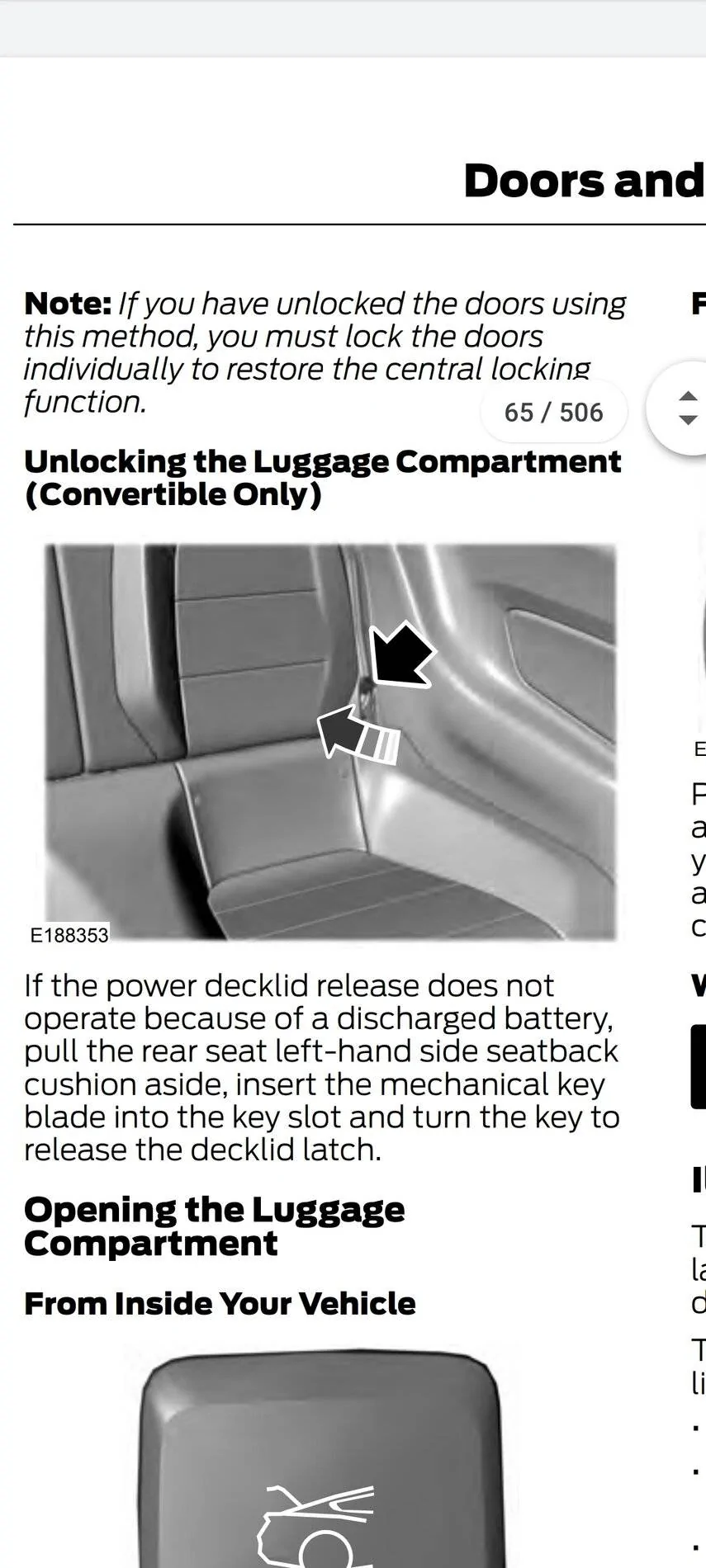

I don't know about RHD cars but this is from my owners manual. It's really tight and hard to get to but it is there.

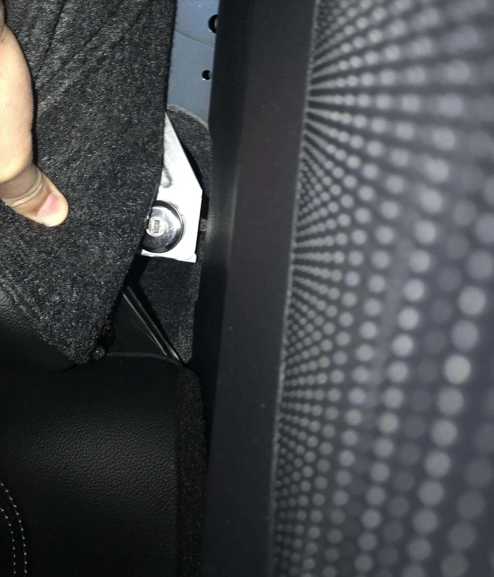

Yep, it's there. Funny, in the Fordpass app there is a manual that does not show this at all in the doors and locks section. That manual is listed as 20th May 2020. My OM printed in July 2017 does have it in there, and here's an actual pic for those who may not have noticed:)
