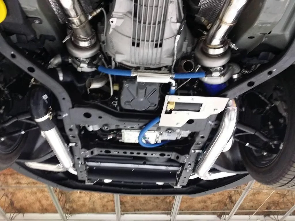

Can you share or tell me how /where you put the filters on the turbos?I did not use the intake tube's going from the turbos to the front of the bumper and yes without using them it didn't fit
That was what I disliked the most about the kit and one of the reasons I am switching to a KB.
I already have the KB and have the kit up for sale but I may be tempted to try it again(if I can't sell it ) if can figure a different way to put on the filters
BTW, how do you like your GT350 compared to your GT TT driving power and style especially low-end TQ?No,that looks like on3's shop car,but that is how mine was.

Just a heads up ,be careful with the wiring to the scavenger pump(and find a way to check it is running okay)

What did you swap out from the kit, and how was the install/fitment/etc? $6500 including tune?No complaints here. I installed the kit myself along with supporting mods and could not be happier. Total cost was around $6500 with supporting mods and me trying to make things perfect always makes it cost more than it really should.

I added the ball bearing 61mm turbos, ID1000 injectors, turbo blankets, Billet Vac block, both silicone hose sizes 25ft and 8an cool line kit, so those items come up to $6400. I upgraded the clamps and couplers on the intercooler and upgraded the hardware for the oil sending unit. I also added JMS BAP, Brisk spark plugs, ATI damper, MMR OPG & Crank gear. I had a custom exhaust made with stainless pipe instead of the supplied pieces.What did you swap out from the kit, and how was the install/fitment/etc? $6500 including tune?
The kit looks great in person. I've seen this car, and I was blown away by. Especially considering the price. It's pretty sneaky too, you can't see the turbos unless you're looking for them. The clearance under the car seems great too.No complaints here. I installed the kit myself along with supporting mods and could not be happier. Total cost was around $6500 with supporting mods and me trying to make things perfect always makes it cost more than it really should.

I've read from others that some of the fittings/couplers are definitely on the cheap side. Why'd you decide to get your own exhaust? Anything wrong with theirs?I added the ball bearing 61mm turbos, ID1000 injectors, turbo blankets, Billet Vac block, both silicone hose sizes 25ft and 8an cool line kit, so those items come up to $6400. I upgraded the clamps and couplers on the intercooler and upgraded the hardware for the oil sending unit. I also added JMS BAP, Brisk spark plugs, ATI damper, MMR OPG & Crank gear. I had a custom exhaust made with stainless pipe instead of the supplied pieces.
I had a SCTX4 and Sai Li did the tuning.
Fitment was fine, no issues. If you have some mechanical background it should not be a problem to install.
I've also already installed LT's, but I like not having the parasitic loss of the blower being spun by the engine, and being able to make full boost at a lower rpm. Plus they are ultra badass.The kit looks great in person. I've seen this car, and I was blown away by. Especially considering the price. It's pretty sneaky too, you can't see the turbos unless you're looking for them. The clearance under the car seems great too.
