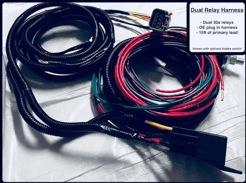

What about the fuel sending unit,don't u have to tap two wires into the factory plug to make the gauge work??
That's the teal and purple wires you see coming out of the plug in the lethal wiring kit.

yes, the fuel level wires need to be connected to the OEM wires. It's obvious which ones they are bc they are like 18 gauge wire...when the rest are 12 gauge
Yea I think that is an awesome price for a capable fuel system.I also upgraded to ptfe fuel line an a aeromotive regulator.If mine supports what your putting out I will be happy and no more buying race fuel lol.

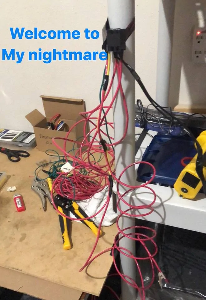

Wait ti'll you get to actually wiring it all...takes about 2 hours...this harness was made for a customer who wanted the second pump on a Hobbs switch, normally it would only be red wires that are exposed since most of those go under carpet as they route into the engine bay to get to the battery.

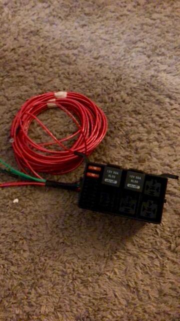

I do also make a fuse box set up for them to make it a bit cleaner when installed in the trunk, the pic I posted is before any wire loom was added.
