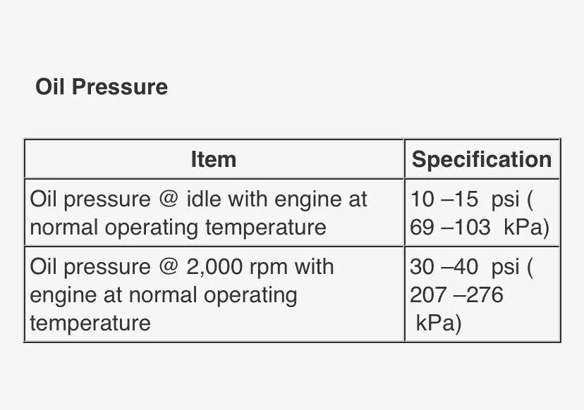

If the gauge is defective it could be the oil sending unit, or just a bad circuit board.
If you're really concerned, buy a true mechanical oil gauge and hook it up - see what the readouts are, because last thing you would want to overlook is something going south internally to the engine.
Other than mechanical issues .... I've posted the below before in other similar threads... here's a recap.
Oil PSI will change or "peg" based on multiple conditions.
High oil psi upon initial startup is normal in every vehicle. The oil viscosity is thicker due to it sitting and dependent upon exterior seasonal temps (whether in a a garage or not). The colder the engine block, the thicker the oil will be, then as it warms up viscosity changes (thins out).
Oil PSI in ANY engine is always dependent upon operating temps, oil viscosity and RPM.
The oil psi specs below is for a bone stock S550 Coyote 5.0 right from Ford:
That PSI info is also based upon the standard recommended oil for the 5.0 Coyote.
