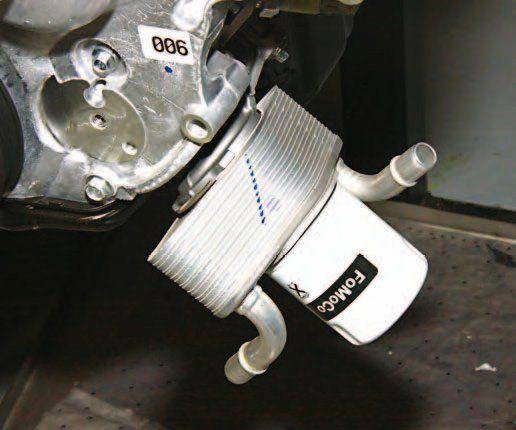

Hey OP, If you haven't got it fixed yet, does your oil filter assembly look like this?
If so, it may be a faulty/defective/broken Oil Filter Adapter.

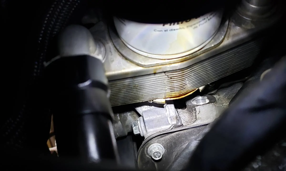

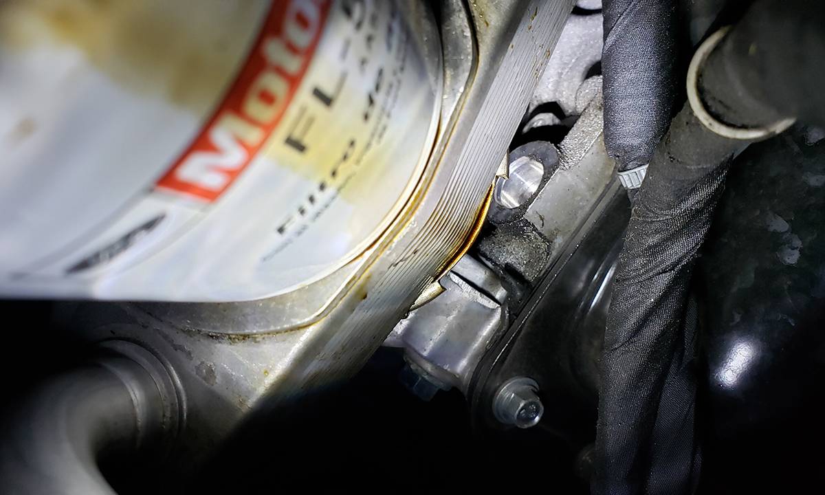

Mine looks like this, I checked to see if there is oil aove the area at all and nothing valve covers are fine. Looks like maybe it leaks from between the oil cooler and engine block. Maybe I will try to tighten the bolt holding the cooler on when I change the filter or maybe it has a gasket that's bad

Could also be a loose oil pressure sensor. It sits just above the filter and other members have indicated that theirs backed out slightly over time. There is an alignment mark on the sensor bolt so if you can get eyes or a camera on it you’d be able to tell if it backed out at all. Their filters looked very similar to those posted above.
The adapter has been known to leak/fail and it's covered under your powertrain warranty.
It's definitely worth taking in and having it serviced if that is the case.

I’ve had two oil leaks from that area. Both times they thought it was the cooler, but both times replacing that didn’t fix it because the leak was actually at the pressure sensor gasket.

Been a while on this, but it was my oil pressure sensor. I took it out, sealed the threads and put it back in. No more leak.
