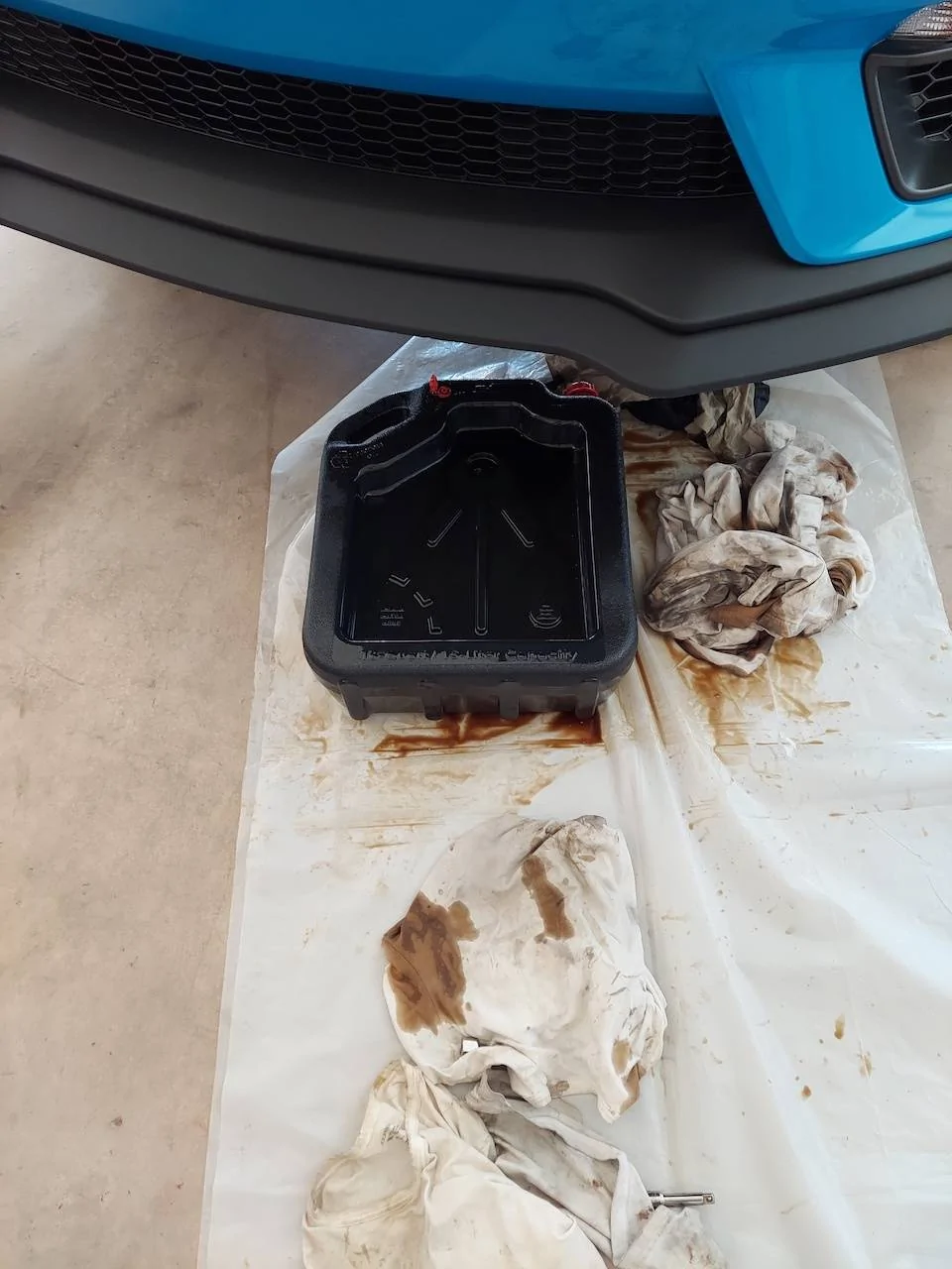

Taking into account life and weather :sun:, seemed like the perfect day to perform Skye's initial oil change.
Tips:
1. If you have not done so already, watch the video above. 🙄
2. See photo below. :curse: LOL. That's pretty much how I expect things to happen. If changing your first time, you cannot be prepared enough. Plastic tarp, rags or t-shirts. Oil drains straight back, not down. Making matters worse, you not only have five quarts of pressure, but 10 bearing down on the drain hole. I can attest: it shoots straight out the back like a hose. I'd originally just let it drip for a bit. Then I bumped the plug. If it gets to be too much, stick your finger in the drain hole. Others have used a cardboard deflector to get it into the pan, but I didn't remember that until it was too late.
3. See the drain pan I was using. It's best not to use a pan like this. The oil is coming out too fast and it does not drain fast enough into the basin. Buy a tub, a big open tub that can hold like 15 quarts. :idea:
4. If you have not considered one before, buy a UPR or a Femco drain plug.
https://www.uprproducts.com/upr-for...for-mustang-f150-raptor-edge-explorer-bronco/
https://www.femco.com/oil-drain-plug/
Last year, I bought a UPR and stowed it. It's installed now. Next oil change should be easier. :thumbsup:
5. You'll notice in the video the owner uses a piece of cardboard to help drain the filter. Great tip. I've also read people use tin foil. Immediately below the oil filter is a rather large bundle of wires. First, I tucked a t-shirt into the area. Then, shaped tin foil. Finally, cardboard. All three worked well. Still messy, but the wiring remained dry and almost all the oil entered the pan. There is a Member here fabricating drain funnels and filter drains. :rockon:
https://www.mustang6g.com/forums/threads/psa-i’m-officially-taking-orders-again-for-3d-printed-oil-change-products.183898/
6. Once you're situated, the oil filter is somewhat easily accessible. Hedging, I bought two wrenches previously:
https://www.summitracing.com/parts/otc-4568
https://www.summitracing.com/parts/lil-57020?rrec=true
In the video, the gentleman uses a traditional cap type removal tool. I wasn't sure how stuck my filter would be, how much traction I could get. I used the OTC three-finger tool; it worked well. Placing the legs against the filter with one hand, I used a swivel and socket with the other and backed it off. Once I could move it with my hand, I was GTG. :thumbsup:I did not use the Lisle wrench. Great tool. I have another vehicle which could use it.
7. Given the angle of attachment, I did not fill the filter all the way. I filled it half full. No issues at startup. Pressure took a second or two to register, and then that was it. Even if you fill the filter full, much of the engine block is still without oil. It will take a moment or two to purge the air and refill. :crackup:
8. I've been using the Ford Pass App, which has the feature to add service records. Today, I cannot add a service record. I'll continue to try. Most comments I've read have same: some days you can add a service record. Others, not. :lipssealed:
https://www.ford.com/support/how-to...orted-features/how-do-i-add-a-service-record/
I took multiple photos, documenting everything, with a notecard (VIN and date). Took screenshots of the Ford App, with mileage and oil life %.
***Edit: The night I made this post, I tried the Pass App again and it worked flawlessly. I added the oil change record, with screenshots and a photo as proof.
9. Finally, probably most important (should have made #1), block time. If you're in a rush or the weather sucks, it might be best to pause and attack later. Making sure you have enough time, especially if the first time doing so, helps remove frustration. :clap:
10. Spend the rest of the day test driving. :sunglasses:
