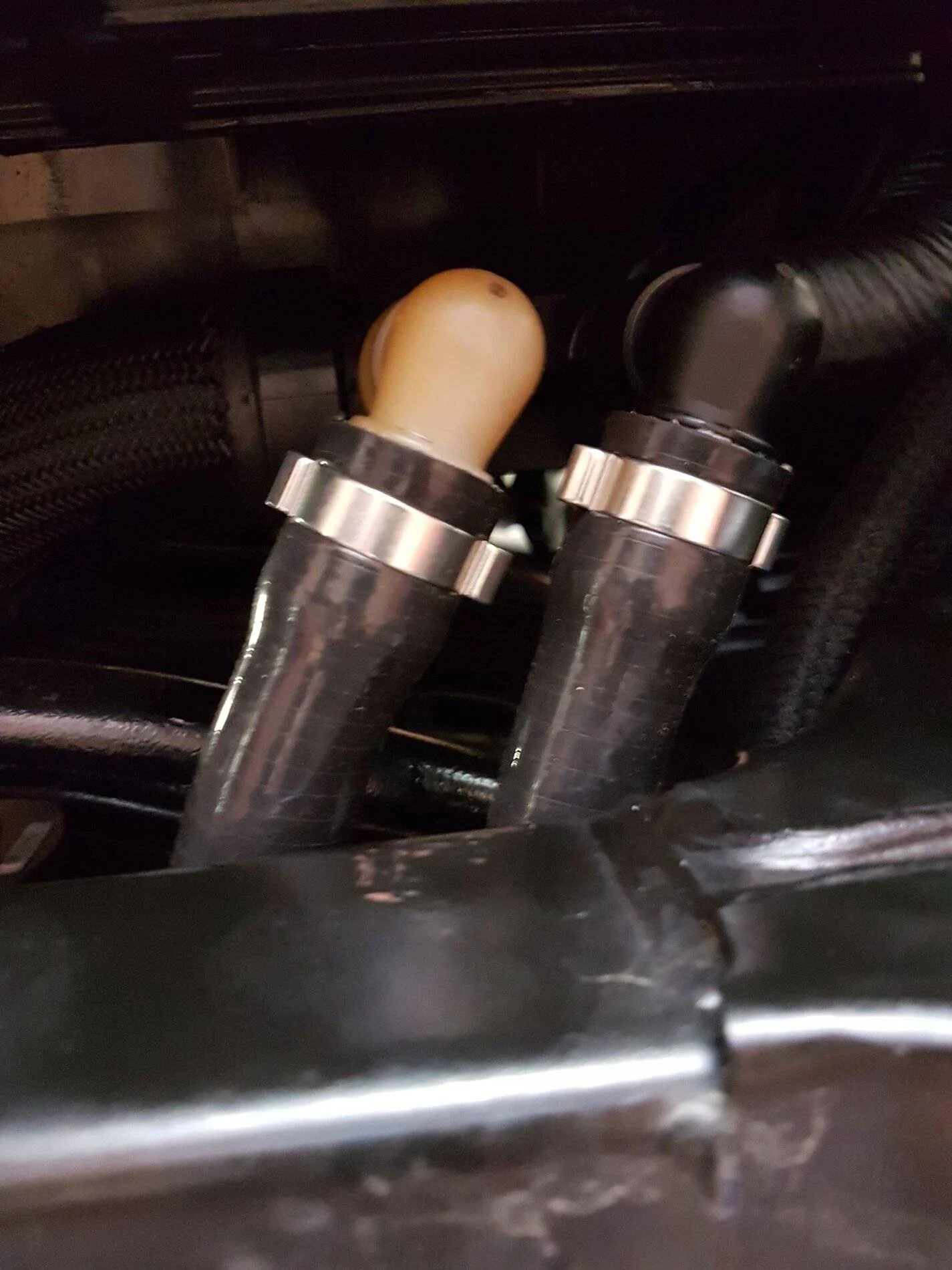

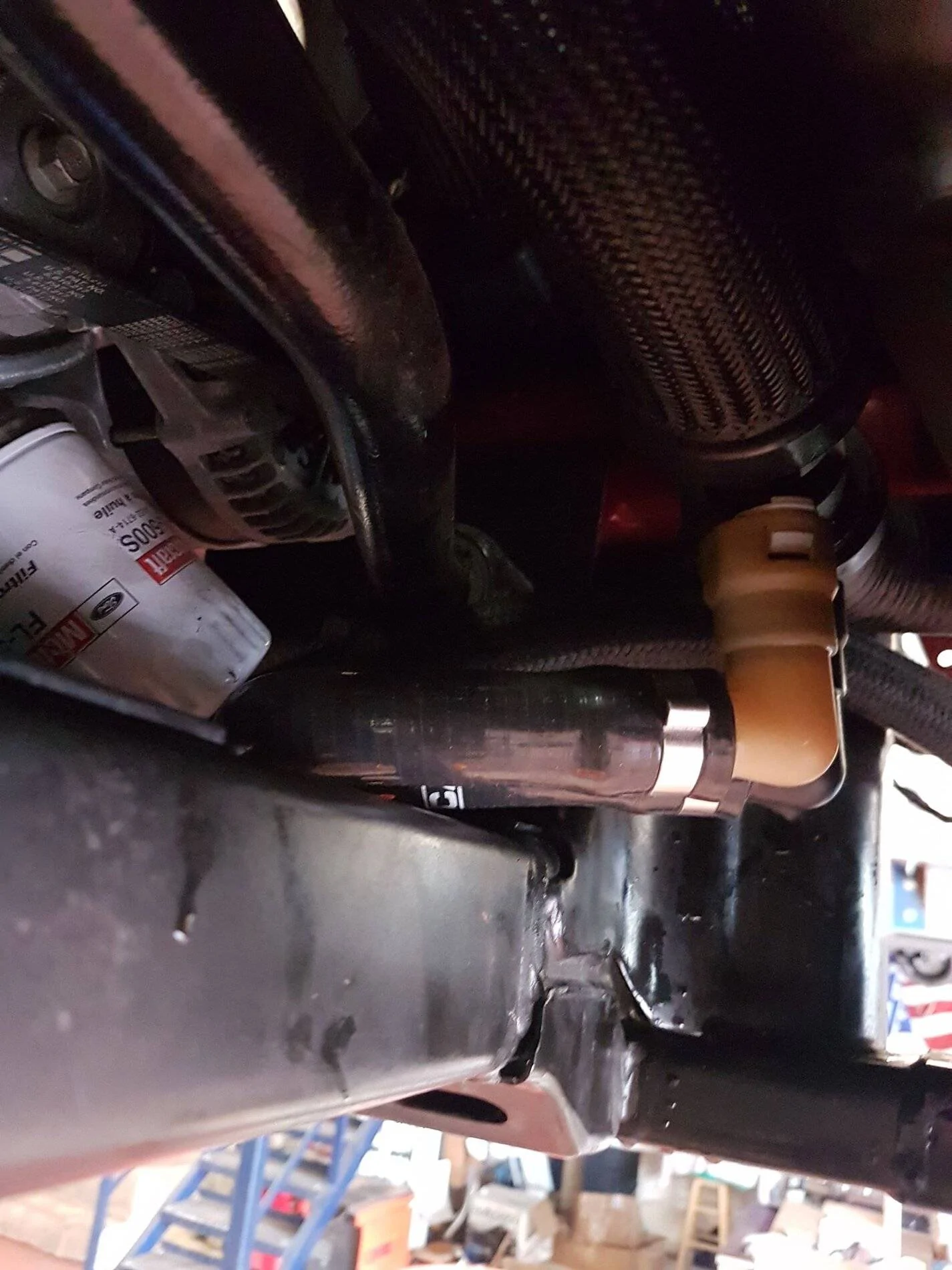

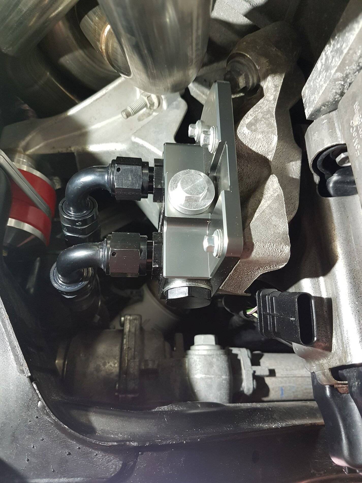

With our kit the Oil Filter stays in place where it is. Nemesis Kit deletes the rear oil to water cooler replacing it with a thermostatic take off plate (Where other kits supply a blanking flow though plate) This allows you to have the ports for the oil lines run off this to the front mounted oil cooler core.
The plate has a channel between the two ports to allow flow of oil though and is regulated by the thermostat. Once up to temp the thermostat will block this channel allowing flow more oil to flow though the oil cooler to keep a regulated oil temp so the oil doesn't become too cool.
The factory radiator hose is kept in place and a 180deg U-Bend hose is fitted so there is no need for install of a complete hose. We will look to offer a silicone hose should owners want a cleaner look.

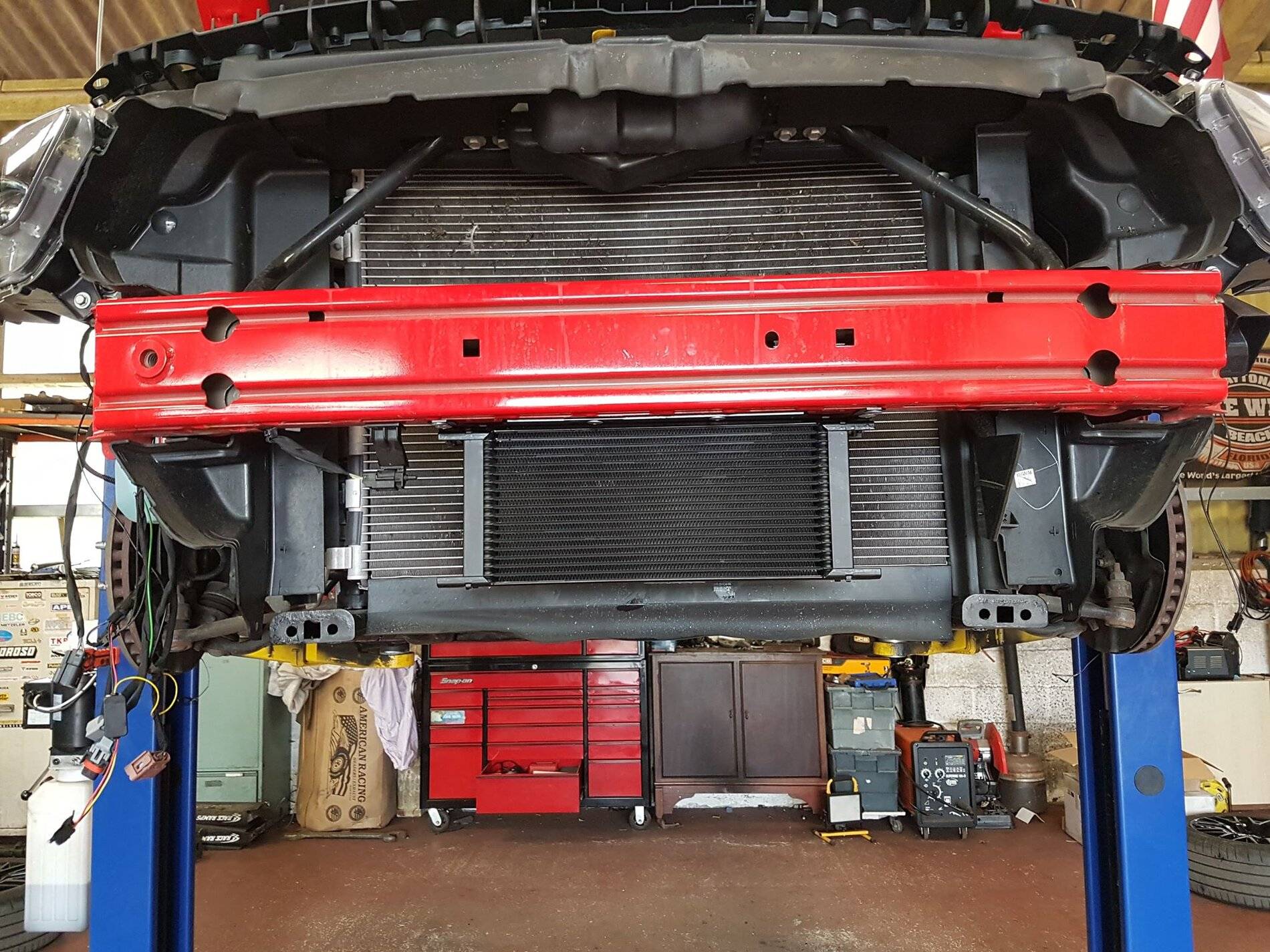

Installation would require building the lines to the correct length required and mounting of the oil cooler core in the desired position. Most common with our kits is behind and below the crash bar for the air to feed through the lower grill. This will also add protection to the AC Rad as a lot of them are starting to deteriorate in this area with the open EU Spec lower grille.
For what it is worth I would highly recommend installation at either Modurstang or GT101 that are nearest to your location I believe?
Here are a few install pictures below. We have now changed the fittings to Setrab Male End Fittings for a more compact and cleaner fit.

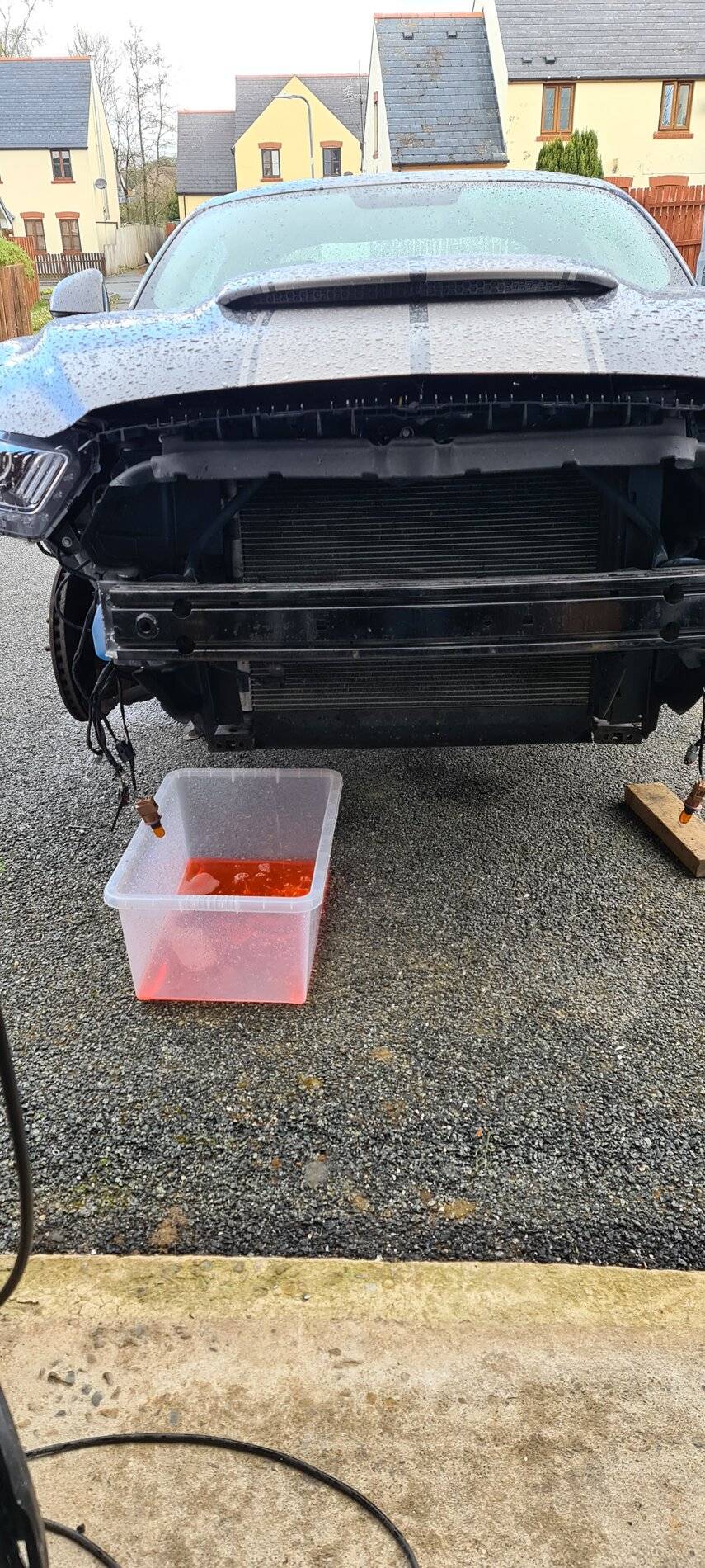

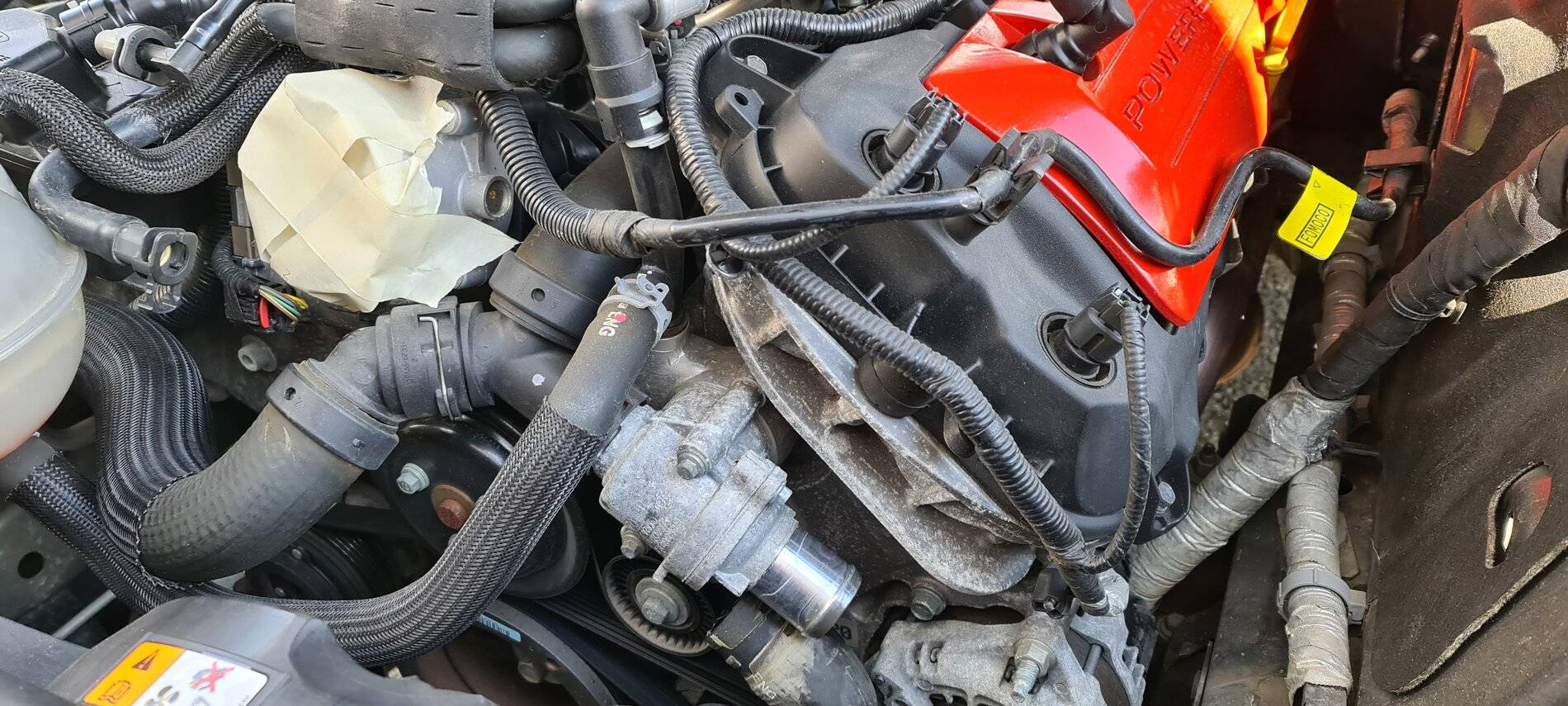

Hi all, so i have started on the oil cooler upgrade. Bumper etc off and drained coolant. I removed lower coolant hose and fitted a samco u bend hose to block off original route to OEM cooler.I found it a lot easier to remove hose than fitting it underneath. I'm going to take my time so will put updates as i go along for anyone interested.
