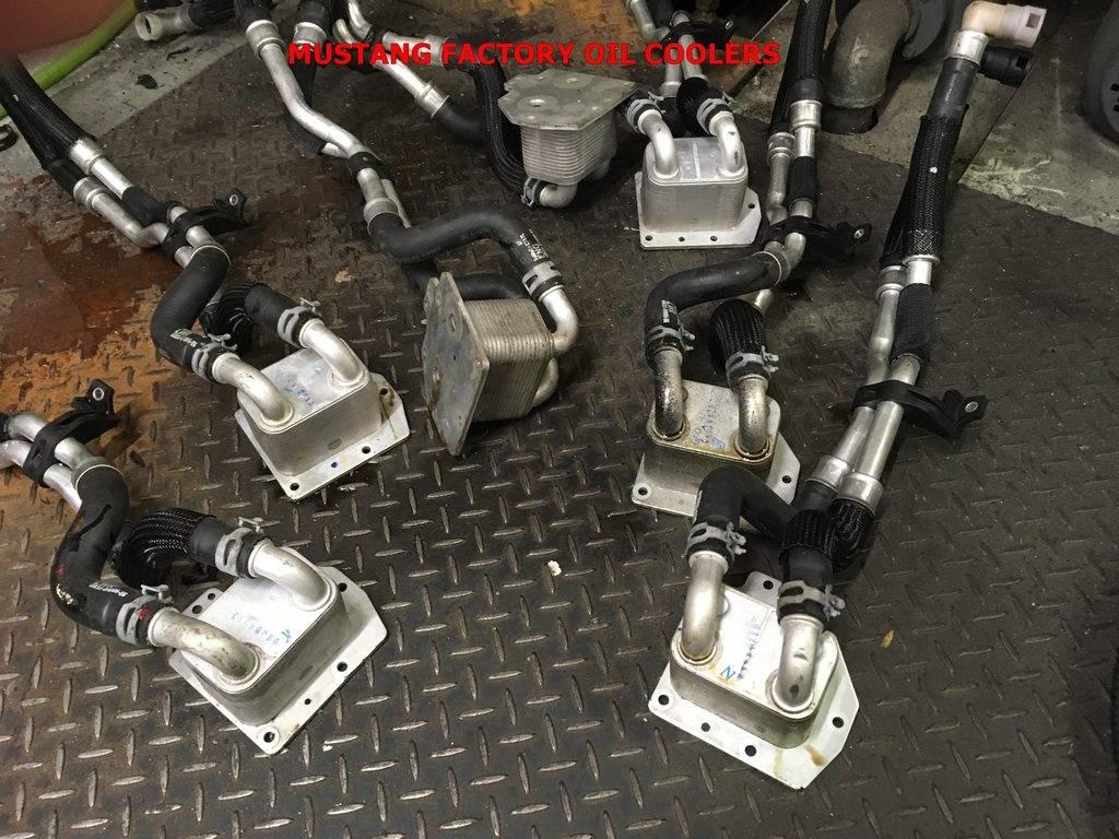

I have a 2016 which got the issue had engine replaced and KPM Oil cooler added 2 hours after I received the car back from Mitchell Ford.
I have a 2018 Bullitt no tick yet.
But in saying that I will be removing the oil cooler from the Bullitt cause I don’t trust it and don’t want the headache knowing it might go at anytime.

Hi GT550,
At the time I was wanting a kit no one at the time had one on the market.
I would have been in the top 5 people in Aus to receive the Street fighter kit.
When I was looking I called multiple workshops Harrop being one of them who were still in development stage.
So for me wanting something now so KPM to the rescue.
For the Bullitt it’s replacement better safe than sorry.
My car was street driven when it let go in my 16 had 24k on clock from memory.
The ironic thing is I dropped the kit off at the workshop and on my way back home boom the cooler let go was not happy and was at the end of the year in 2017 so was a long time before I got my car back.
On a side note my car at the time had the following Mods
X-force full exhaust
CAI
Tune
When I got the car back booked into the workshop to remove the crap oil cooler plus tune again cause I had misfire on all 8 cylinders once tune done perfect.
For me this is a must have replaced item personally I don’t want to have the milkshake that brings all the boys to the yard was a horrible site.
And would rather have leaking oil if it ever happens rather than coolant/Oil mixing = engine replacement if your lucky or flush out.

The problem is, this issue goes from working perfectly to catastrophic failure with no warning.
Also reasonable number of failure points also removed.
I'm having KPM replace mine this Wednesday. Call me paranoid but I haven't driven the car since warrantee ran out two weeks ago. :blush:
