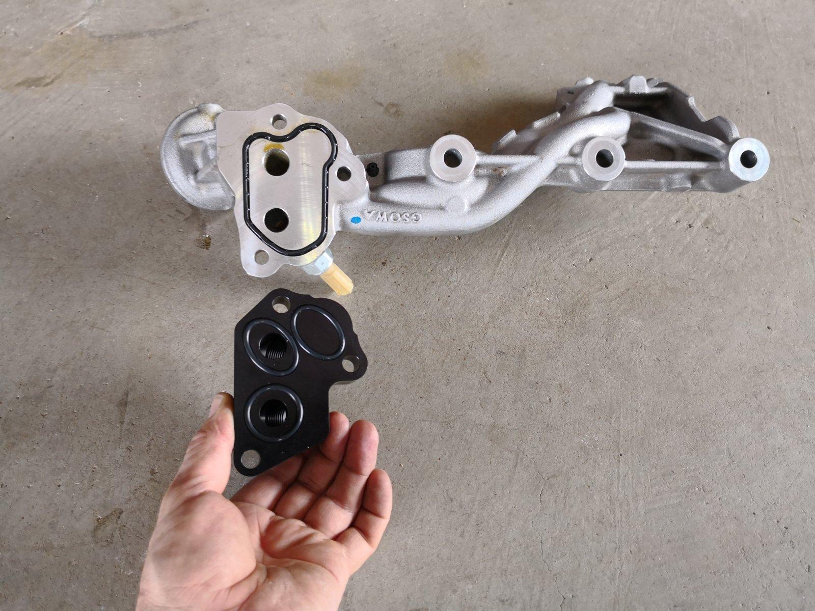

So it's just another mishimoto style kit with streefighter bypass.
I'm looking to see if anyone does their own OEM style cooler replacement. So similar unit but, well....sturdy.

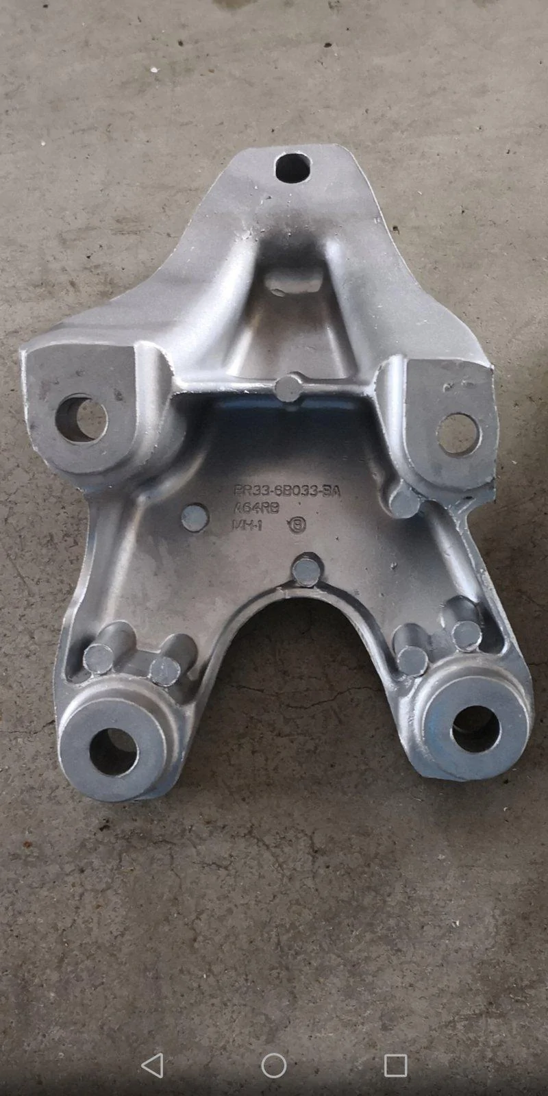

I have installed a MMR oil filter cooler/relocation kit in mine. We'll worth it in my view. Completely removes the stock oil cooler system altogether. I did have to buy a US engine mount kit due to our mount being made to Intergrate with the oil cooler manifold. Car sits just under half with oil temp and not one drama. This system provides more room around the left side of the engine
and takes the oil cooler completely out of the picture when installing headers.

Can you possibly provide the part number for the engine mount you used? I’m looking to do something similar in the near future.
Thanks

Here it is US engine mount with serial number.

Thanks, it looks like a robust installation and all high quality parts. I prefer this to a sandwich plate approach. I have booked in to get one plus only $302 for install with Harrop backing for peace of mind. Later, I will replace some of the parts (BMR engine mounts, Improved Racing adapter and remote filter with thermostat to convert it to remote filter install.

Finally got rid of the factory cooler and replaced it with the harrop oil cooler kit. Was pretty impressed with quality of the kit.
