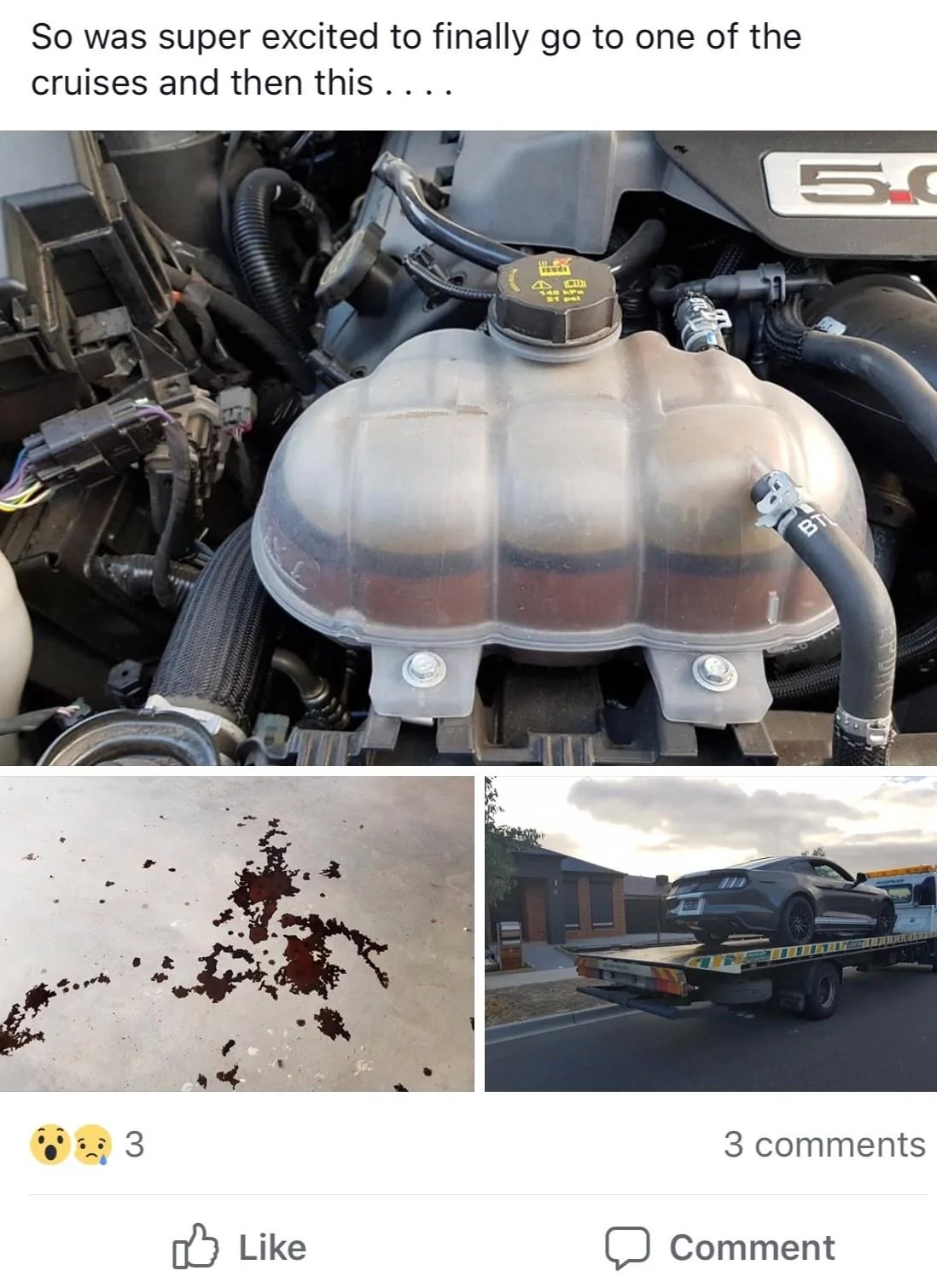

Bookface claims that another one went in Melbourne in the past couple of days.
Could be a good time to put some (public) pressure on Ford to address this issue in the wake of their $10 million kick in the arse.
Any ideas?

An external AND internal cooler leak. Sorry for the owner.
Drew I'm not on FB, any idea of the build date?

2020 GT Fastback Velocity Blue
It was a 16 model with 27,000k's. I've seen 16's and 17's with this problem now, so its safe to say it isn't strictly an early 2016 build problem
