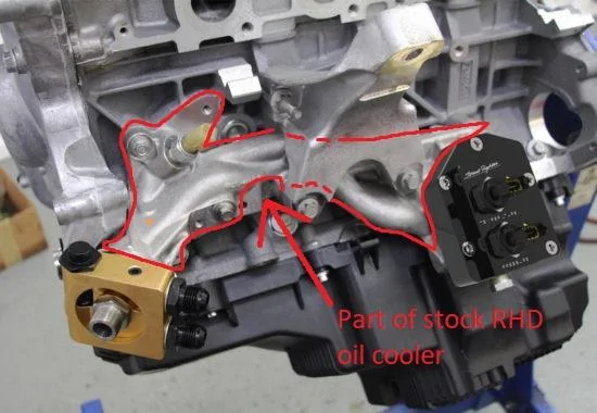

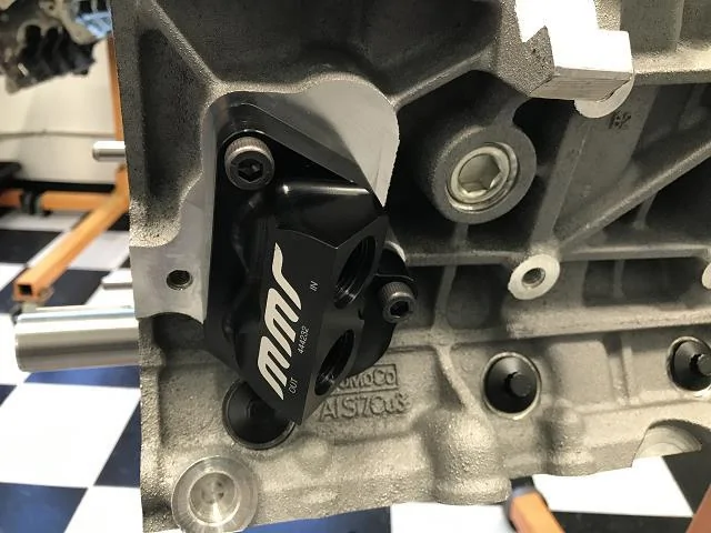

Mmr do a plate that replaces the filter manifold totally. The rhd manifold is totally removed. You then plumb oil lines to the mmr plate and take it to a remote filter under the hood. I plan on using a generic remote filter boss with no thermostat. I will then put a laminova oil/water heat exchanger in line and plumb it with the coolant supply from the stock locations that feed our rhd oil cooler. All this will be mounted in the engine bay.
So are you saying that all the components outlined in red in the attached photo are removed? (photo courtesy of Street Fighter thread)
Edit, I think I found the part.
Correct all the red bits are removed and replaced with the black mmr plate you showed. I was sceptical of any oil / water solution but it seems most newer cars all use this to heat the oil quicker, especially beneficial in our UK climate, maybe less so in your climate. Laminova appear to be very well respected, so I suspect one would be fine, especially when positioned somewhere near the front.
I suspect a US spec left engine mount or some spacers will also be required as the rhd mount appears to bolt to the oil manifold that gets removed.
You will find that by removing the RHD design manifold ( outlined in red) that you will have no support for the lh engine mount. You will need to fabricate a support system or possibly purchase a LHD engine mount support.The second problem by removing the by-pass manifold is lack of space and awkward angles to fit cooler hoses.
The reason the RHD has this factory by-pass manifold is to ensure positioning is correct to allow room for the RHD steering box.Limited room in this area otherwise.

If you know what you're doing you could remove that cast ally part in red, cut off the bits you don't need, and then use something like the MMR. As for awkward angles for hoses, with the bewildering array of aftermarket hose fittings something is bound to fit. But then the SF kit does offer a bolt on solution for those that don't want to mess around albeit no filter boss.
With you on that. The angle grinder will be used to turn my manifold into spacers for the lower bolts if I can’t find suitable washers
